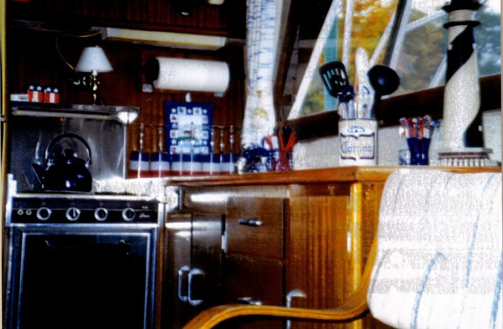

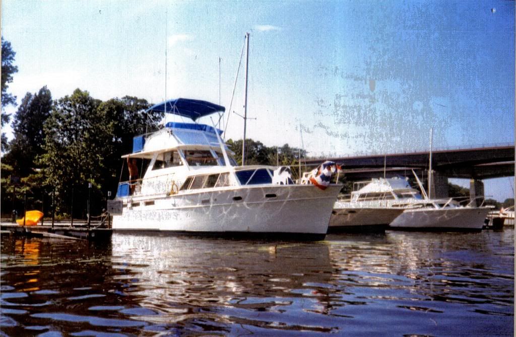

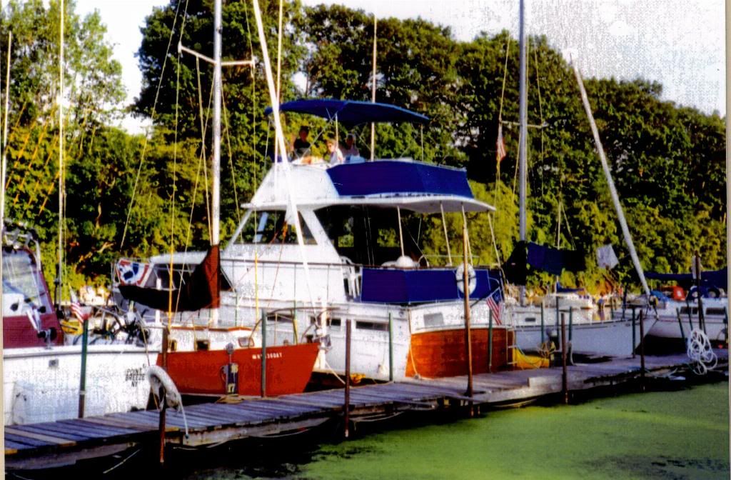

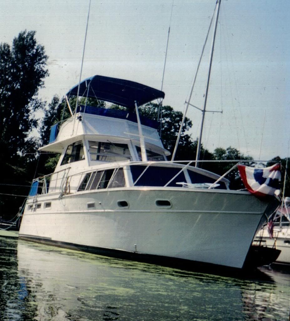

Thanks for all the positive encouragement guys I appreciate it, it keeps me movin on. Bruce and Marge bought her on June 26th 2000 and sold her in 2006 to the butchers that let her go. They had her for 4 years and sold her to someone else I do not know their names and the unknown owners tried to halfheartedly did minimal patch rigging to get by. As for the mallet and the irons, I have been ordering them for two years now but they are mysteriously on back order every time I place the order. I know my technique is A bit strange but it is fine I did A bunch of seams last year the same way and they were fine she didn't need much just enough to back up the compound she just needed A touch. I will get them in the long run, I always get what I am looking for so I am confident I will have them soon. We are just going to enjoy her this summer and leave her out next summer. I need to do to get her back to where she was years ago, I will be pulling planks everywhere to expose all the ribs at the turn of the bilge and the tails. I will be replacing the transom and anything rotten or broken from stem to stern top to bottom then putting her all back together stripping her back down to bare wood cotton oakum seam compound bottom paint hull paint, I found A few soft spots in the decks that will be addressed, new cabin sides, windows the works. I just cant do what I need to in the winter I need warm weather to do her up right and there is no building big enough to do it in over winter.

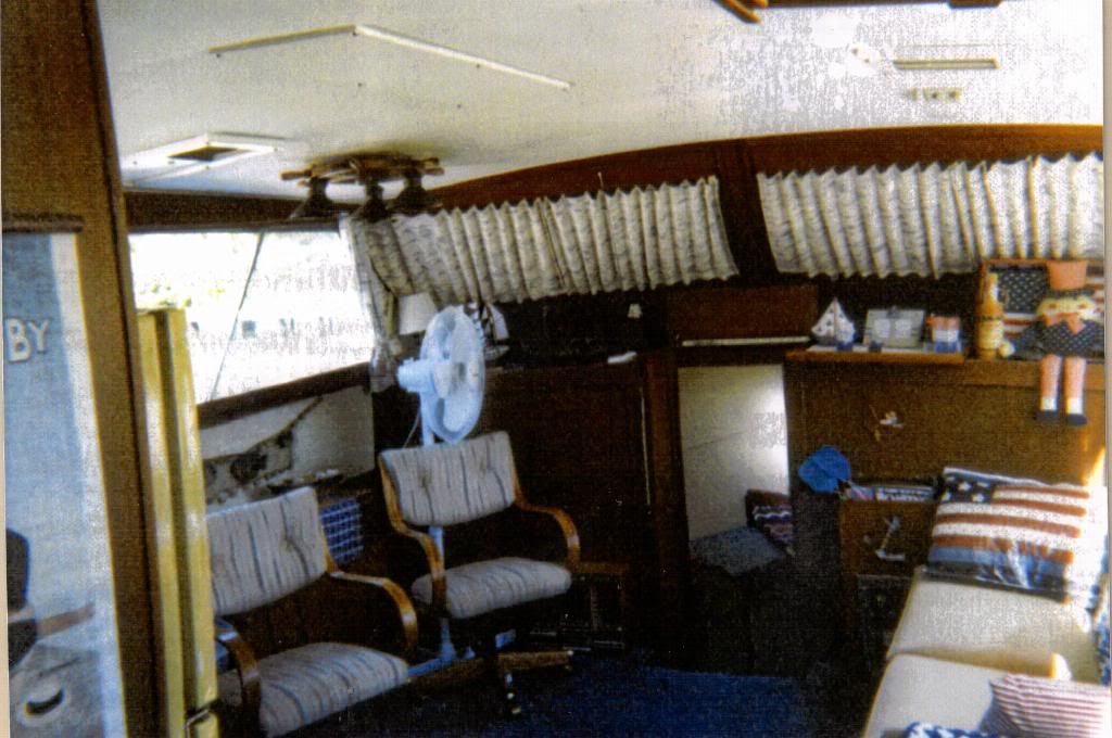

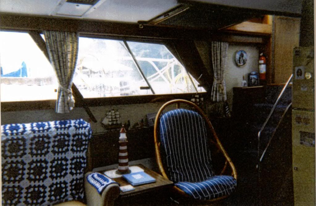

Jimmy.S Posted - Jun 09 2011 : 13:55:01
Well the story continues, I came home to A photo album that was made for me by special friends I made while on this journey by the names of Bruce and Marge Franklin. They were previous owners of the previous owners of my boat. Her name was "OUR MARGARITAVILLE" then and she was absolutely beautiful then so I thought I would share the photos of their hard work and dedication. These pictures give me more incentive to bring her back to where she should be. Thank you Bruce and Marge from the bottom of our hearts. Here they are for your enjoyment.
