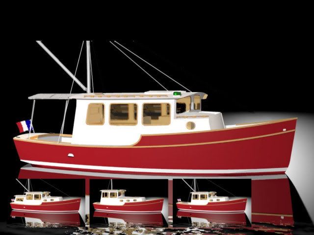

For 7 yrs now we've the Admiral (Lori) and I have been planning to build our own boat. We chose the TW28 from bateau.com for it's ease of construction. This past weekend we took a 1000 mi road trip from Iroquois ON to Boston MA to pick up the CnC plywood kit for the TW28. We scored an excellent deal from a fella there who abandoned his TW28 project. This is what it looks like before assembly....
And if all goes well over the next 3 yrs or so we'll end up with something that looks like this.....

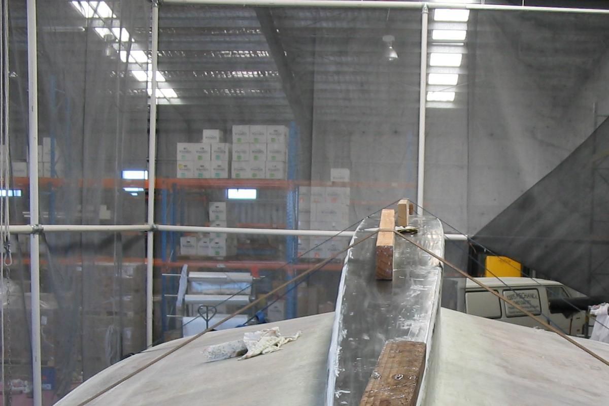

This is the SS shoe they put on the TW28 in Australia. It was insisted up by the inspector if I remember correctly.
I'd need a piece of SS about 20' long and 16" wide to fit my keel. Wonder how much that'll cost? Hmmmm?
