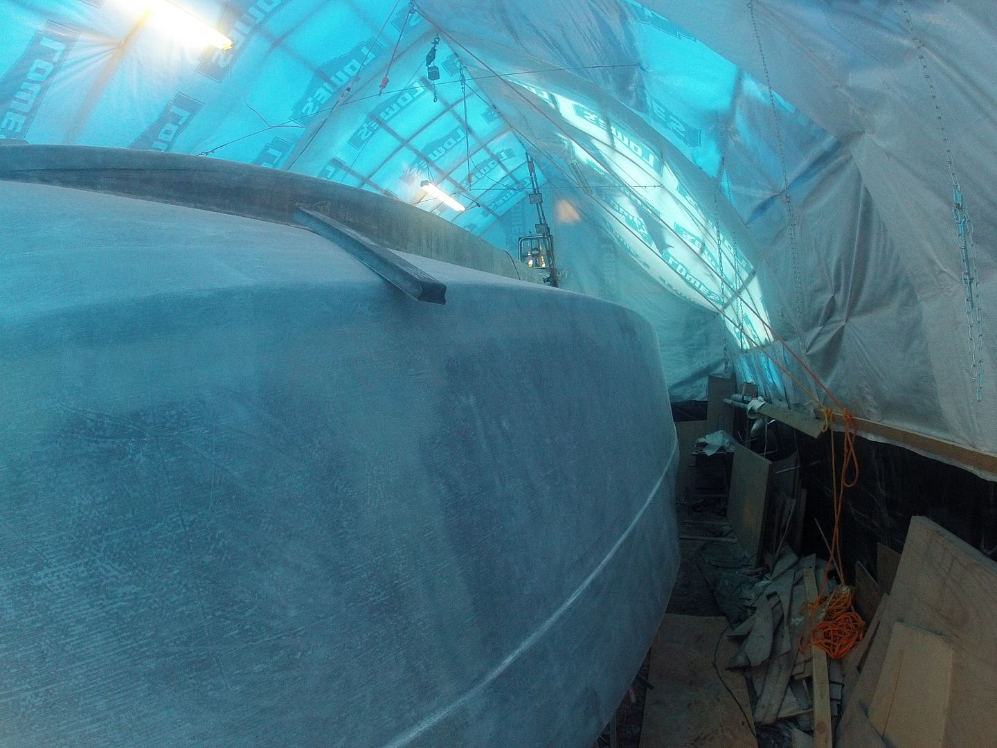

KnottyBuoyz Posted - Jun 14 2013 : 17:13:51
I've got RIPPLES!
These showed up after I removed the peelply from the port side we did on Saturday. I've sanded the tops off of them, do I need to go deeper and totally get rid of them? I'm afraid of going too far and sanding away good fiberglass. It looks like the glass is deep and right against the ply from what I can tell. I did aft end on Sunday and when I removed that peelply there was no sign of any ripples. The main difference, other than Jim not being there is the temperature (abt. 5 degs warmer (low 70's)) and no rain so the shed was dryer. The only other thing I can think of is I didn't squeegee enough.
You can see them again on the right hand side of this pic.
I started going down the port side with the sander about 10:00 this morning. Didn't quit till 16:30. My hands were throbbing like crazy.
Nobody's going to do this for me so I had to stick to it. Mostly I was sanding the ripples and feathering the fabric edge along the bottom. Seeing as I ended up having to sand the whole freakin' hull anyways I think I'll forgo the peelply next time.

KnottyBuoyz Posted - May 15 2013 : 07:22:26
I think floating debris will cause damage at the bow near the water line or on the hull, I won't lif it can hit the bottom of the keel. On the plus side, adding a SS plate will also add weight to the keel and help stability..
Exactly. I added a layer of Saertex (quadaxial carbon fiber) on the bow area where we'd likely sustain any damage.
PascalG Posted - May 15 2013 : 06:53:24
KnottyBuoyz Posted - May 15 2013 : 05:52:42
To shoe or not to shoe depends in how and where you re going to use the boat...are you really going to beach a 28' trawler on a rocky beach?
Hey Pascal. Thanks for looking in.
That's true and for us this boat, hopefully, will carry us into your backyard someday. Around here the biggest hazards are floating or nearly floating debris in the St. Lawrence. Stuff like picnic tables, trees & partially submerged docks etc. It's worse in the spring.
We usually keep to the deep water whenever possible. I'm not that adventuresome that I need to know where every little creek or backwater goes. I once beached (unintentionally) our 25 footer. The depth sounder on the transom showed 75 feet of water and the bow was aground. That's the 1000 Islands for ya! :-)

KnottyBuoyz Posted - May 14 2013 : 13:37:43
I'll have a look to see what I can find Bruce. Thnx.
Here's a pic of today's efforts. Doesn't look like much but there was a good 4 hrs of sanding and wiping to prep the surface for the fiberglass. It'll likely take me another 11 hrs to do this side. Thursday or Friday I'll get to that.
