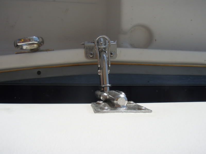

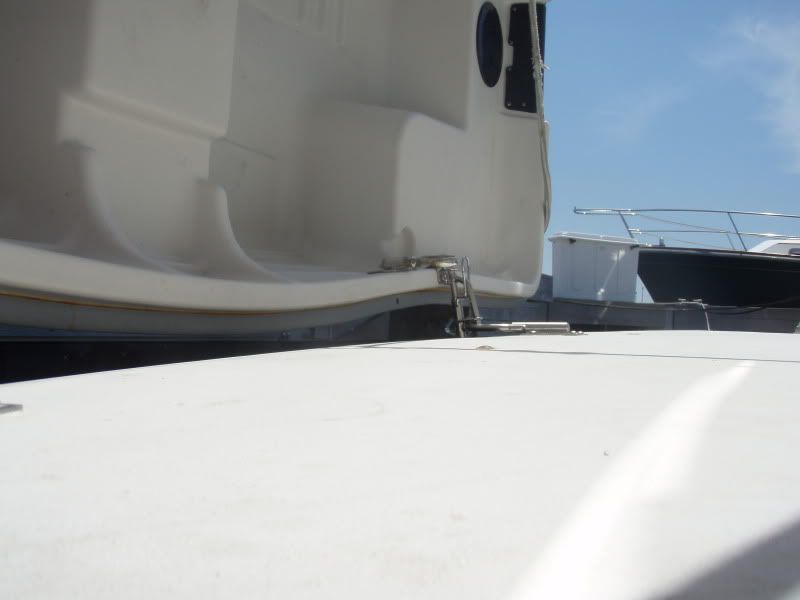

My West Marine rigid dingy when mounted to the swim platform sags very bad. I just mounted it last week end and it has distorted by a bunch. What can I do to reinforce the side to prevent this. here are some pictures

Well I was able to get started on reinforcing the side this weekend. I used aluminum square 1 inch tube. I used aluminum because I could form it to the contour of the dingy easier. I will probably add some wood (Gary not morning) for added support as Pascal and others have suggested. I have caps for the end and will paint the tube when I feel that it is providing good support and no other modifications are required.

This is not an uncommon problem with rigid dinks. Here in the PNW, many Livingstons/Sorensons have been re-enforced on the side wall (where davits are attached). One older method was to fiberglass a piece of wood to the interior side wall, and then attach the davit to the re-enforced wall. If you go to Livingston's web site, they actually have models with re-enforced sides for this application. I realize you have a different brand, but same concept.

Thank all for the good advice, no I will not return it. Wife loves it and we have had it for over a year. I just decided to mount it on the swim platform. B4 we had just left it on the dock and only used it when we were at home port. 370 motoryacht has the answer, I never thought of that. I found some 1 in round tubing, think it is stainless and will use a conduit bender to match the curve of the dingy. Will try and get that done next weekend and will post completed pictures. Thanks again

Buy a properly built dinghy! :) seriously the best way to fix this is to reinforce the sides near the top. A piece of varnished wood, 1" thick, 4 to 6" wide, would do the trick... What you want to do is spread the loads
and then add supports from port to stbd to spread the load, you could make them out of 7/8" S/S tube and some Bimini top parts with removable pins ...

I'm not surprised the side of the thin-wall molded plastic dink has deformed with that security pin forcing it up so far & the weight of the dink and wave action underway (w/ sun heat) bearing down on the rest of the side. Can you move the dink one way or the other to swing that pin at an angle to let the gunwale rest on the swim platform? Or heat and reform the pin for shorter height to same effect? IMO, best would be to have a customized support between the whole dink side and platform that properly supports the curve and maintains shape. If that deformity doesn't pop back when the dink is in the water or flat, you may have to set up a jig inside the dink to gradually encourage return to original shape.
