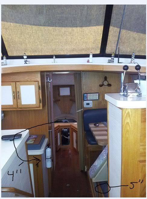

I installed the 3rd run today. I went through the forward head into the galley cabinets and exited it in the galley. The plenum box I got from Flagship Marine was the wrong size so I called OB and they sent me one overnight. I wanted the exits out the sides and one down but the one I got would have been up\down\left with the way my blower outlet is orientated so I had one of the guys in our machine shop rework it so it was right. I turned the unit on and it brought it down from 79 to 73 without freezing up. There was a little white on the coils but I won’t know for sure until I have a chance to really run it. We have a wedding to attend this afternoon so I turn it off. I’ll give it a good test tomorrow.

There will not be any problem running 2 additional vents to the locations you show Niles. I think your finally on to the crab as is often said in Deadliest Catch.
The least amount of 90 degree bends possible is the way to go, bends restrict flow and create back pressure. There are 45 degree Y's and bends available.
To bad the ductwork isn't insulated it's not a killer but it helps with condensation and cooling the boat faster.

There will not be any problem runing 2 additional vents to the locations you show Niles. I think your finally on to the crab as is often said in Deadliest Catch.

The coils feel about the same top to bottom. The two current runs length is 6' for the one in the v-berth and the run going to the galley with the 90 bend is 10' long. I can't see where the temp thermistor is. I am going to assume it is on the inside of the drip pan and out od site. The divider in the current T is ok. I'll try and insulate the plastic part of the 5" run somehow. I don't see and packaging material left anywhere.

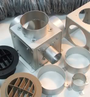

If all that fails I am contacting OB to get a plenum box with 4” collars, plates and a 2’ collar. I think I can get a 2” run into the head. With the box I can probably eliminate the elbow that I have on top.

Or make a plenum box to fit on the fan discharge, and run your ducts from that. The bigger the box and the more ducts you can run, the less restriction there'll be. I had to do this with my AC.

The guy from OB keeps telling me I need three 4" outlets or it will freeze up. I really don't have room for another 4", maybe a 2" and run it into the head on the port side of the boat.
Where can you buy different configurations of outlet housing?

Two thing I see that indicate restricted air flow:
1. The 5 inch duct looks like it come over then in front of the air intake on the starboard side as it runs under the v- berth.
2. Air intake is facing the starboard side hull which will reduce air flow. I understand that is probably the only way it will fit in the location.
