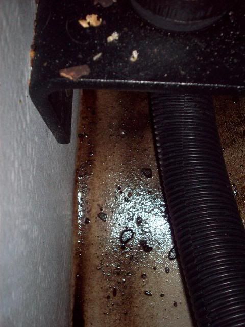

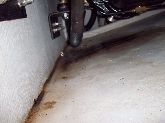

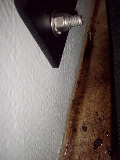

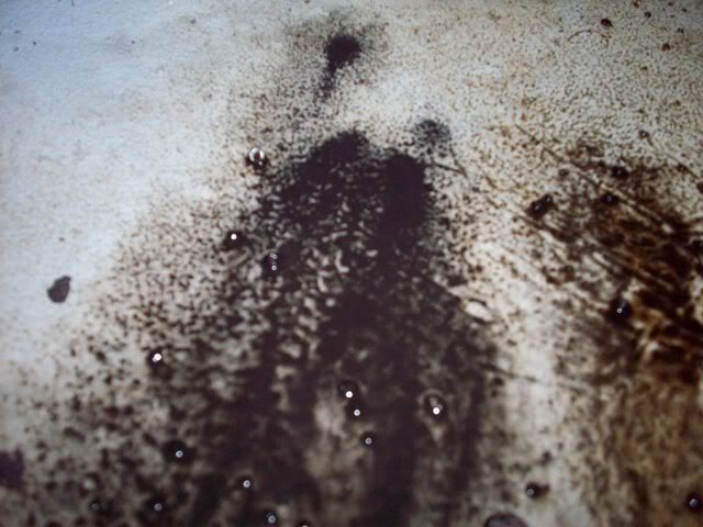

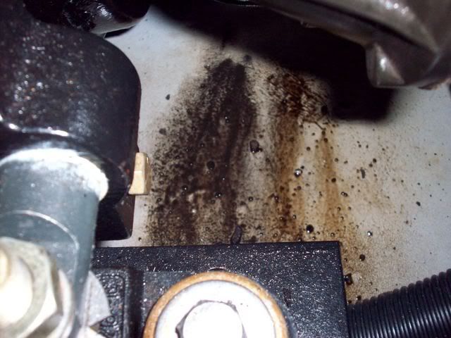

Ocean Spray
RO# 20033
Posted - Jan 15 2008 :  13:41:06  Show Profile  Reply with Quote
I tried to snap a pic under the engine to see if I could see anything, but no luck. Its comming from the back of the engine, like its an oil seal or something internal, I don't see anything on the outside, and I have also had MM check before and they culd not locate the origon of the leak either. I am just surprised that a new engine would leak like that with todays technology, must be a GM thing!
Ocean Spray II
Captain Pat
Homeport: Sarasota, Florida Go to Top of Page
Posted - Jan 15 2008 :  14:06:10  Show Profile  Reply with Quote
picture is not going to help findind dark oil streak on a black block... :-)
you need to wipe aroudn, checking the rag until you find the spot.
there is no such thing as an internal seal... a leak is external. before assuming it's the rear main seal, you need to eliminate otehr possibilities.
btw, does oil level affect the leak ? sometimes an engine will leak a little more if it is full or overfilled.

Bottom line, there is research and there is research. You have to do your homework. Sorry.
The good news is that the kind of problems you are having, in my opinion, are all fixable. In the meanwhile, bite your upper lip and trudge forward. While that boat has quite a few compromises designed in, it is far from being unworkable.
Get that oil cleaned up and those bilges need to be spotless clean.
bp
Ocean Spray
RO# 20033
Posted - Jan 17 2008 :  20:02:30  Show Profile  Reply with Quote
I let MM know today of the leak.
