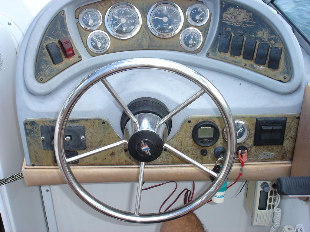

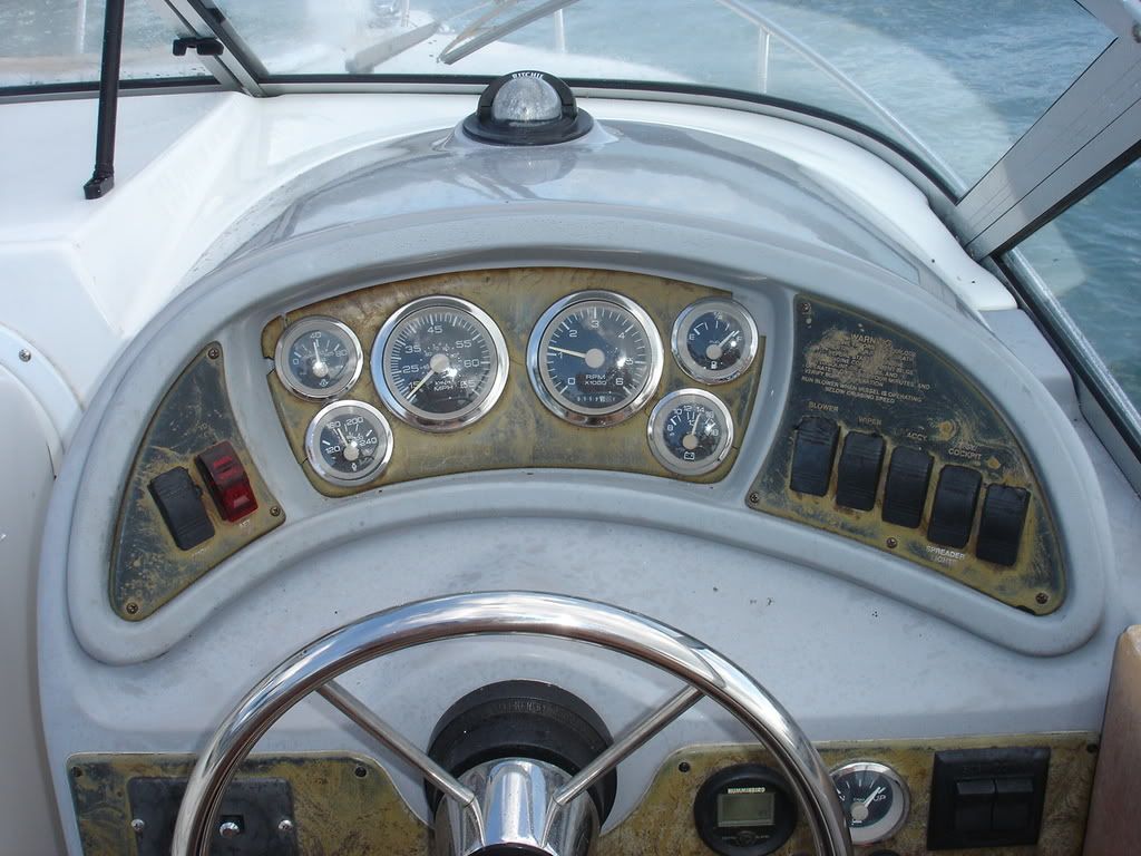

I just bought this boat and the dashboard panels (for the gauges and switches) are heavily uv damaged. Wellcraft doesn't sell them anymore.
Anyone have ideas on finding used panels or making new ones?

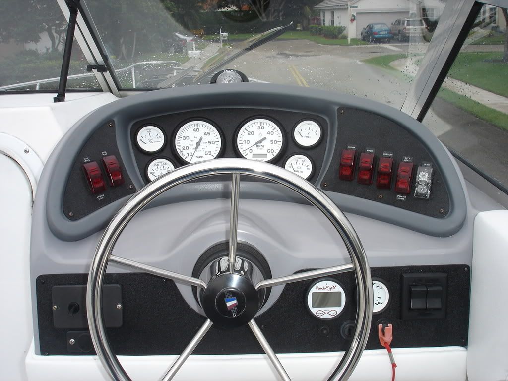

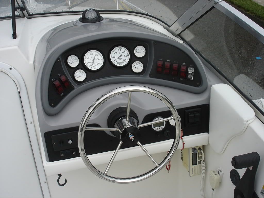

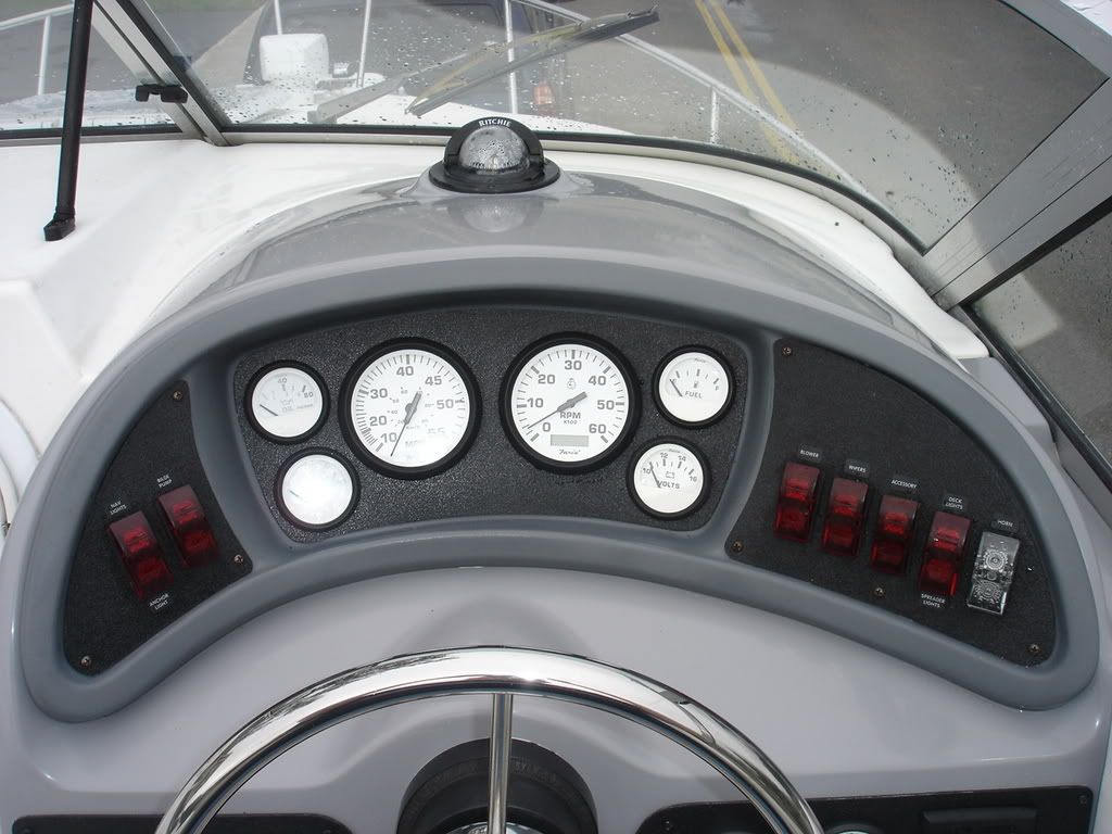

Been there with you guys. I decided to make my own panels. Bought a black hairline textured UV stabilized ABS plastic sheet and made them using the old ones as templates. Here are some before and after pictures.

Where can i buy the red and white/clear led rocker switches as indicated in this picture?
