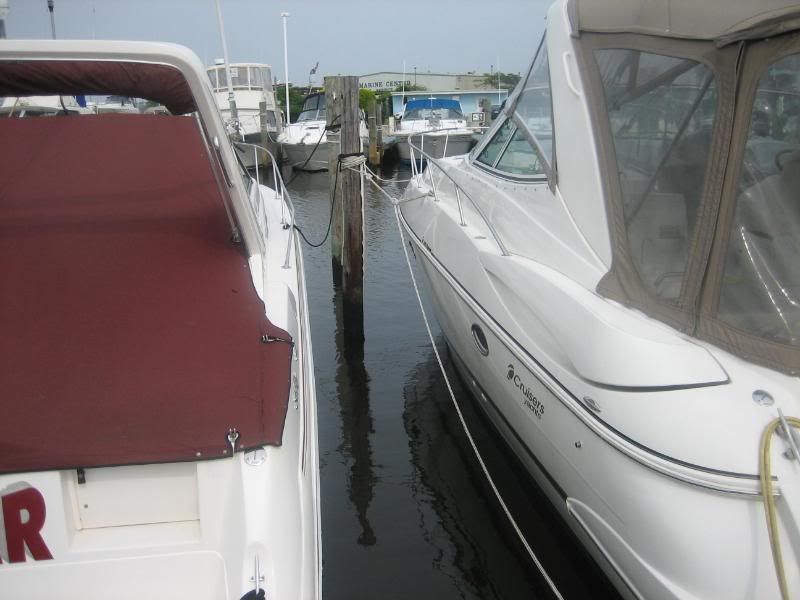

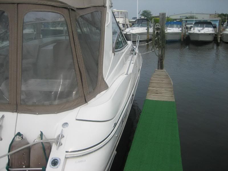

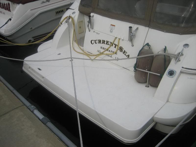

Posted - Sep 09 2008 :  17:26:48  Show Profile  Reply with Quote
I have 6 lines as well.
My boat can't touch a pole, pier or dock with these lines no matter what tide.
When I come to boat I undo starboard rear line to make it easy for people to get on and off from finger pier.
Examples attached:
Rears Crossed
Spring Starboard
Bow
Spring Port
