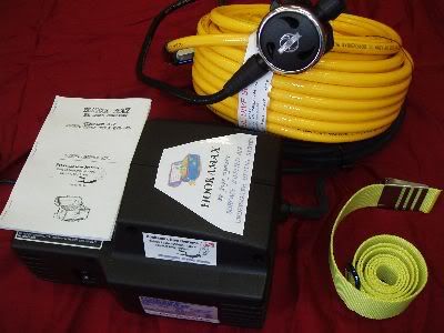

"The small oilless will not operate a second stage scuba regulator; they are generally designed to work at at least 150 psi."
I take it you've never breathed a tank dry. :-) A second stage works until the bottle is empty. And they make low pressure second stages for hookah use.
A small oil less compressor works just fine as a shallow water hookah rig. I've seen them rigged and sold for just that purpose. (See below)
"Our original system was the 1000 Hookamax. The system utilized an oil-less electric compressor to supply air to the diver. With the introduction of oil-less home compressors, our design was chosen."
