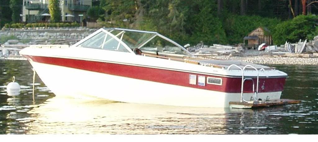

Gonna hijack this thread a bit, sorry. I asked this question last fall and got a lot of not really helpful answers, so here goes again, sort of. The Cetol can says for marine applications, not below the water line. I have a fair amount of Teak that I will be refinishing in the next weeks, most of it is the standard rails and trim. The concerning piece is the swim grid. It is rather large and due to it's proximity to the water it spends a fair bit of time in contact with and frequently under it (salt water). I have Interlux spar varnish sitting on the bench right now waiting to go on, is the Cetol a practical solution? No, I am not going to raise the swim grid. Here is a view of the dilema.

Try a clear epoxy over bare wood for water immersion.
Posted - Apr 07 2009 :  17:43:13  Show Profile  Reply with Quote
First off please make your picture smaller.
It makes it a bit of a PITA to read your question because it stretches out the posting box. :-)
If your swim platform is not in constant contact with the water, Cetol will work fine.
Just be sure to sand it very, very smooth and preferably do it off the boat with all hardware off as well.
Then use at least 6 coats of Cetol.
You can put 2-3 coats on in a day. And you only have to sand or scuffy the coats you put on the day before.
If it is going to be in contact with the water most if not all the time,
then you might be better off just keeping it clean.
Other wise, as ronbo1 suggested, you would really need to epoxy it and then coat it with
a good 2 part poly for the longest life of the finish. But this can be a lot of work involving
some rather expensive products.

I tried cetrol on my swim platform, didn't last three months as the
teak is underwater when I'm running.
Works great on anything not in the water.
I am now using a product called teakguard.
