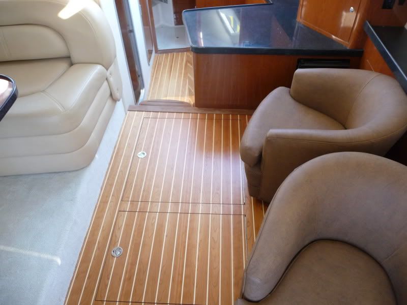

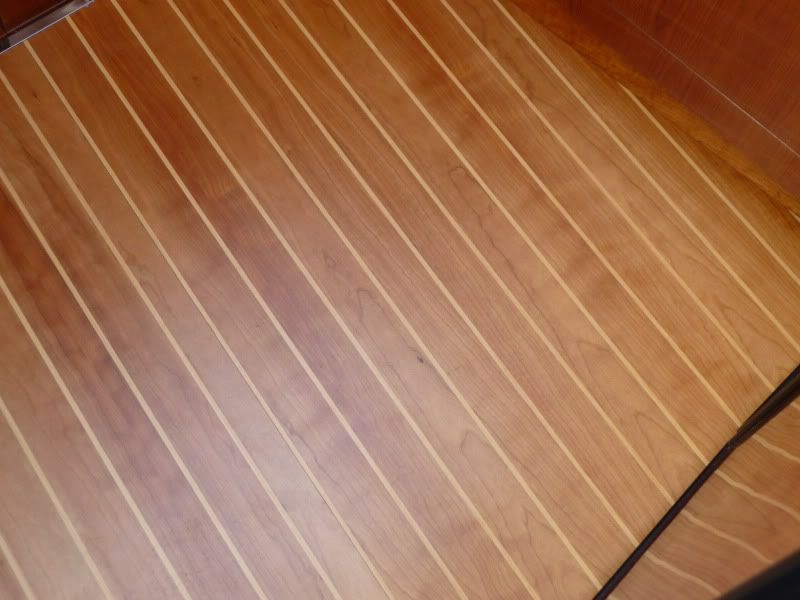

Posted - Sep 17 2009 :  09:26:47  Show Profile  Reply with Quote
I have the real wood stuff on my boat.
Looks great, easy to clean, but will scratch or dent if not careful.
Came installed from factory.
If I look at the edge, the product is very thin.
It is actually cherry and holly I think.
No edging around the hatches, they cut it to a perfect edge and looks great.
