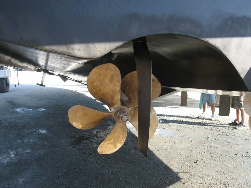

While on the topic how does the stepping of the hull help the boat plane? They always look like a strange place to make cuts into the hull?

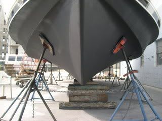

Here are some PIX of forefoot to stern with a lot of transition and a stern with both some V for tracking and flat sections for lift. The stepped chines increase roll resistance at rest but are up out of the water at speed for less drag.

nice job of edumacating me on this...thanks...some pictures of the butt and front end of my boat (while being surveyed). No clue what was going on with the design of this hull, but it rides nice enuff for me. Caught in some 6-9s head seas around Cape Canerval a few years back, had to slow to 11k but made it ok

Bruce your pictures look similar to my hull almost flat at the aft. Prop position is similar.

Uncle Buck,
Prop pockets. My Silverton had a similar hull with prop pockets. They have a couple of functions. First, they reduce the angle of the shaft so the prop thrust is more direct than a boat with a more severe shaft angle. Second, they reduce the overall draft of the boat as the props are not extending as far below the hull. Not sure what the downside is but I'm sure there is one..... its a boat so there's always compromises.

Mike:
They are also supposed to increase prop efficiency. The downside is less maneuverability when docking and less lift aft.

Posted - Dec 19 2009 :  20:13:24  Show Profile  Reply with Quote
the downside of pockets can be less maneuvrability and some wandering at low speed.
Charmer has no pockets... the boat handles like a dream, I can litteraly move the bow or the stern jsut a few inches if i need with incredible precision, which I need coming back in the slip here since i have a few inches clearance altogether. She tracks extremely well too, requiring very little steering input. despite having a fairly flat aft section.
