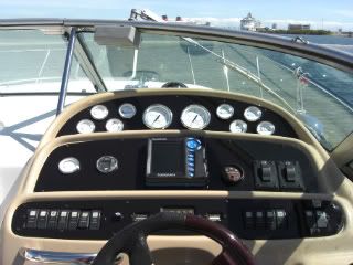

Posted - Feb 21 2010 :  20:03:02  Show Profile  Reply with Quote
Almost complete. I need to mount the gas gauge and depthfinder and I am done!

jeffk
RO# 2093
Posted - Feb 24 2010 :  20:39:53  Show Profile  Reply with Quote
I am having another black panel made. Putting the plotter in the middle and moving the radio fron the bottom to where the plotter is now

Posted - Mar 08 2010 :  07:03:56  Show Profile  Reply with Quote
I had a 1990 Sig 30 in I think 2006 I redid the helm all new gauges switches and harness it still looks great today. Looks like you did a nice job enjoy. I'm currently redoing the dash panels on my Trojan but I'm not replacing anything everything is working fine I just want to freshen it up. This is a picture of me Sig 30 before I installed the GPS into the space on the right.

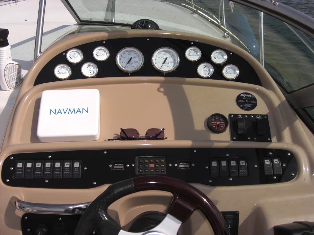

Posted - Mar 12 2010 :  22:28:52  Show Profile  Reply with Quote
Finished project. All gauges and plottter from boatfix

Posted - Mar 13 2010 :  07:47:40  Show Profile  Reply with Quote
Looks great what did you use as the backing ABS plastic? I didn't notice what did you do with the Fire-boy light I don't see it in the finished picture.
jeffk
RO# 2093
Posted - Mar 13 2010 :  10:58:19  Show Profile  Reply with Quote
I have to mount the fireboy. I broke that little bulb. It will go on top of the fume detector which needs a new head.
The plastic is 3/8 inch thick. I did not back the top piece. I thought I would have to but it is very solid.
The middle piece is sitting on the original dash.
I painted it black so it would not shine through.I also painted the screws black. The stainless was a little overkill
The original bottom posts on it that were adapted to the new piece.
The fabricator in Cape Canaveral charged me $100 for the three pieces.
I was thinking of moving the gas and depth finder to the right and moving the radio up, but I am running out of room and it may look cluttered.
I hate the position of the radio, it is hard to see the channels.
After I live with it a while I will take the top and bottom panels off and paint them black on the undersides so scratches will not show so much.
I should have thought of that before installing.

chap290
RO# 15308
Posted - Apr 19 2010 :  16:17:53  Show Profile  Reply with Quote
Jeff,
I have a 2004 290 Sig and really like your new instrument panel. My faux wood grain is starting to peel up, so I may do similar project.
Just out of curiosity, what are the two large switches on right side of middle section for? Looks like they have QL on them.
2004 Chaparral 290 Signature
Homeport: Knoxville, TN Go to Top of Page
jeffk
RO# 2093
Posted - May 28 2010 :  15:57:59  Show Profile  Reply with Quote
Those are nuetra salt switches...........sorry for the long time to respond
