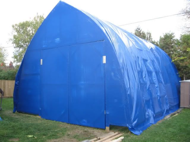

It's still going to take some doing to get this space turned into a boat shop. I put up a shelf today to get some of the stuff up out of the way that I keep tripping over.
One teeny tiny step towards getting this thing put together. Standby....

I'm following this intently.

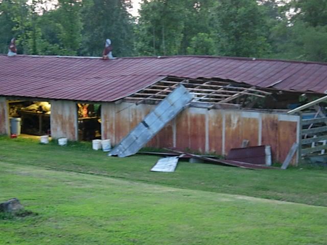

In AK, I spread the Clear 6 mill over my "Boat Tent Structure" and then covered that with the ubiquitous Blue Tarp.
I held the edges down with jugs half filled with water.
That worked great. The 6mil visqueen was the Water proof part, and the Blue Tarp kept the winds from tearing up the Visqueen. The Snow slid right off the Blue Tarp.
The Visqueen was sort of a throw-away because it died an ugly death as soon as it was taken down. After a winter it was easily cracked and broken if moved. Couldn't be saved.
Ricks set up is more permanent. Since it WONT be dismantled every spring, it should last two or more years. The Sun wont kill that Blue tarp like it does the Visqueen. I'd bet there is some preventative Paint to keep it up for years.
I wonder why more people don't do this. Especially down where I live. I am seriously thinking of making a version of that, down behind my Barn as a "mother in law" cabin and moving down there to Hermit.

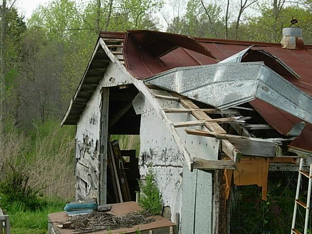

In these photos you see a "Dang near Hurricane proof Barn" that is losing its Roof. Built in the early 60's, it's Tin is rotted and the Purlins have rotted from too much water. The fasteners are Rusted. The whole Roof has to be replaced.
Ricks structure makes me think I can tear down 60 Feet or so of that Barn and put up a Structure like Ricks, with a Round top instead of the tall peak.
I think "Repairing" my Barn would cost more than a "Hermit" shed like Ricks.

60' of shed would run you near $5K Thud. Definitely cheaper than replacing a structural shed like yours. I've yet to get the plumbing run for the head or the cable run for the satellite TV. The Admiral and I are still negotiating about meal service and conjugal visits Brian! ;-) We've got wireless internet so that's covered. Managed to get some artificial lighting up this weekend.
