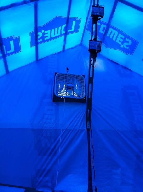

We're pretty lucky we don't get much really bad weather in this part of the world. My heart goes out to those down south recovering from the weather that's befallen them this week. We felt the tail end of the storms that caused so much devastation in the States. Anyhow it was blowing 60-70 MPH here yesterday and that's highly unusual for us. The plans I bought for the bow shed said 70 mph was the max for the design. I built it to plans and doubled the size of the stakes that went into the ground. Now I think that was a good idea. When I got home last night the shed was still standing but taking a pretty good beating from the 40+ MPH winds. It moved quite a bit and had blown the bottom of one of the big doors in. I backed the doors up with a 2x8 and tied the shed to my boat and my garden shed. If it takes flight now I'll have to go to Oz to get my lawnmower! ;-)
BZ to Stimson Marine for a great shed design.

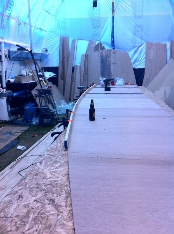

I had to lay out the entire bottom panel so I could scribe the curve of the chine on the extension panel. I'm stretching the boat 39-1/8". The extension panels is the slightly lighter colored one half way down.
The whole bottom panel is 31'10" long. My shed is 32'! ;-( Looks like I'll be climbing up and over! Should be good though, I'll drop a few lbs in the process.

I thought I'd be smart this week and tried to glue and tape some seams both sides at once. Result was a disaster.
This is the bottom side. I had gooped a lot of epoxy on the tape but I don't think I had 'nuff weight on top to compress the panel so it'd squeeze the bubbles out. I also tried to do 4 joints like this at once! Doh! Anyhow I got to spend some quality time with my power planer, grinder and belt sander! *scratch scratch*
So after re-taping and gluing all 4 joints I got near perfect joints. These are simple butt joints but they're incredibly strong. All the ole' timers tell me you have to scarf those joints. *sigh* I cut a rebate (1'64") into the sheets where they'll be jointed so the fiberglass can lay down in there. When finished the joint is near perfectly smooth across it and will require only a light sanding to prep it for a secondary bond.
Live and learn. Slow and steady will win this race. ;-)

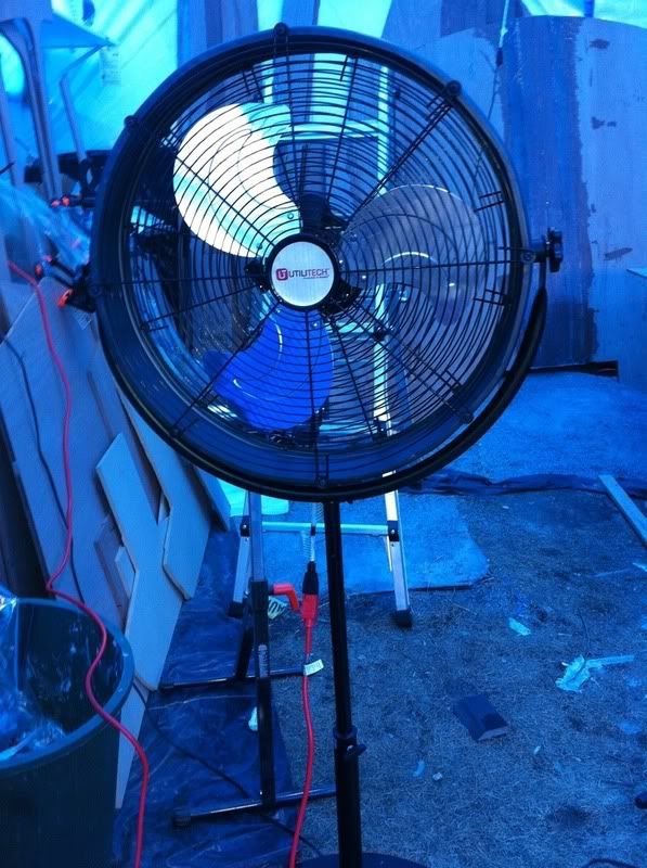

It was getting a little warm in the shed so I had to bodge some ventilation in peak. $15 at Lowes!
And if that's not 'nuff to keep me cool & dry this lil' puppy will blow a hurricane through the shed!
