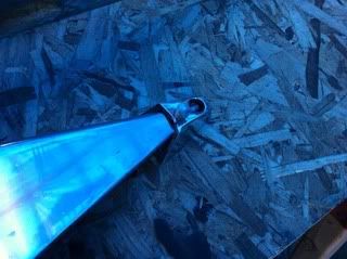

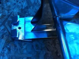

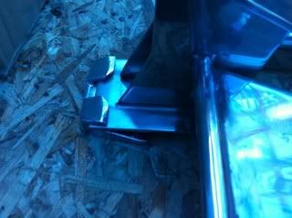

I have a question about these chocks for the danforth anchor. I've never had these before and am not quite sure how they work.
If I set the anchor in the chocks like this the tips sit well in their holders.
The bolt on the shank holder keeps the anchor held by the tips and the bolt.
The crown sits like this.
The way I have it setup it has to be this way to get the anchor out. If I do it so the crown sits like this.....
Then the tips are free of their holders. Anybody familiar with these and how they are supposed to be setup?

Rick, hold the anchor by the shank and put the crown in place, then lower the shank and the tips will slide into the tip holders and the shank into the shank rest.
Basic high school, the ends of a straight line are farther apart than an angled line of the same length.
Gary Peck 1997 Bayliner 3988 MY, twin 330 Cummins
I saw a movie where only the military and the police had guns,,,,, It was called Schindler's List
Homeport: Toronto, Lake Ontario Go to Top of Page
KnottyBuoyz
RO# 20406
Posted - Jul 03 2011 :  12:03:21  Show Profile  Reply with Quote
Thanks Gary. So the tips of the flukes don't go all the way into the holders then. Anyhow, I'm more than a year away from needing to know all that fancy schmancy stuff! ;-)

The Other Gary
RO# 143
Posted - Jul 03 2011 :  12:11:47  Show Profile  Reply with Quote
Correct, install the crown and shank holders, then raise and lower the shank to mark the fluke tip travel without the crown leaving the holder. Install the fluke tip holders so you can easily remove the anchor by lifting the shank and put silicone in the bottom of the tip holders unused portion to reduce rattle.

Posted - Jul 03 2011 :  13:15:22  Show Profile  Reply with Quote
As to the anchor pads, you set them up so the head sets up into the holder. Then set the tip pads so the tips are just on the pads but not way down in them. Then you mount the stock holder. You want to set this all up so while the tips set on the pads and the head fits into it's holder snugly you still have enough room to move the anchor down out of the head holder and then lift it out of the pads after you release the knob holding the stock.
Does that make sense?

Got it Bill1. That's exactly how it works. Thnx to everyone who helped me figure that out.

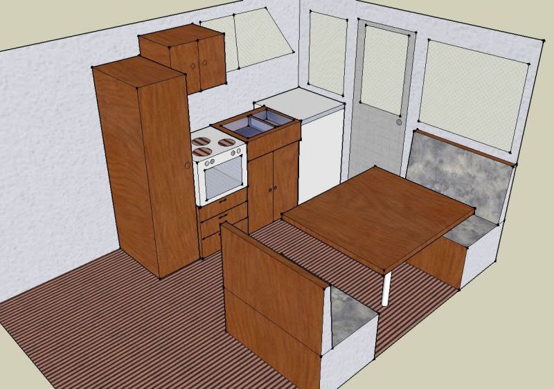

Interesting set of Kitchen Cabinet shelves you got laid out there. :)
Rick did you use a drawing program to make that sketch or copy n' paste?
I want to learn how to do those drawings.

The drawing of the strongback comes form the designers site. I'm nowhere near that talented even with AutoCad. My drafting teacher used to make me write X, Y & Z on my left thumb, index and middle finger so I could keep the three axis straight in my mind! *lol*
I used Google Sketchup for some drawings I've done. It's free and pretty good to learn on.
http://sketchup.google.com/download/
