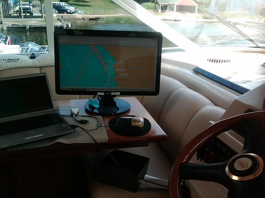

I have the Fugawi software and GPS receiver, the GlobalSat BU-353, at my lower helm plus a second monitor and second mouse on the flybridge run by an ACER notebook running XP.
I also have a Garmin on the flybridge for redundancy.
The Fugawi system has day, dusk and night modes at the click of a mouse and either mouse controls both upper and lower screens.
The receiver sits on the dash and aquires very quickly. It has never dropped a signal yet.

It is hard wired Dan, both mouse and monitor cables need to go to the flybridge. I use a small inverter on the bridge to power the monitor. The notebook is powered by my main inveter. The Acer has an app that allows both screens to be displayed simultaneously and I have a Y for the mice (meeces) to run simultaneously as well.

Gary,
I like that set up! How is your daylight viewing of the screen rb2rb2@gr5tgr5t the bridge on those bright sunny days?
The Other Gary
RO# 143
Posted - Aug 05 2010 :  23:16:43  Show Profile  Reply with Quote
Daylight is fine Tony, It is a standard Dell monitor so you can adjust brightness and contrast.
Easily viewable even with polaroid sunglasses.
Use a trackball mouse at both stations so you do not need a mousepad.
Acer Aspire one $300, remote disc drive $80
Fugawi software $200 comes with all charts in US and a navionics card reader
Dell monitor $100
GPS $50
Two mice $80
Ytaps and adapters another $50
Misc extension cords to reach flybridge $50
Total $900 but you have a full PC for email and a helm cam if you want all in one package.

Posted - Nov 10 2010 :  19:21:23  Show Profile  Reply with Quote
Gary,
Not sure if you mentioned it here or on another thread, but you said somewhere or another you were pondering getting a wireless mouse for your bridge station. I haven't tested it on the boat yet but today I bought a wireless mouse for about $15 from the local big box office supply store- it's a Logitech M305 so that I can run with laptop down rb2rb2@gr5tgr5t lower helm, hardwire another screen to bridge and hopefully wireless mouse on the bridge. Just testing it here at the house....it worked from 2 rooms away (through 2 walls, one a plumbing wall, and about 35 feet away) which completely surprised me. I'll know this weekend or sooner when I go up to the boat but can't imagine it won't work to control the mouse from the flybridge with laptop directly below at lower helm. I'll confirm once on the boat but figured you might like to go wireless though since you've already run the wires it may be a mute point. For me though, if it works, all I have to do is run a monitor cable to the bridge to have dual station GPS capacity.
Now to get a flatscreen for the bridge.....

Posted - Nov 10 2010 :  22:48:07  Show Profile  Reply with Quote
Great idea. Let us know how it works out. I'm using Maptech software on a laptop connected via serial port to an old Garmin 126(?). Since it's hard to find a serial port on today's laptops, I picked up the BU 353 puck to use on my netbook. Seems to work well with my netbook in the yard...will move it to the boat this month. Combining this with a wireless mouse and a FB monitor will allow me to move from my Garmin 276C as a primary chartplotter on the FB.
Does anyone have input on monitor readability in sunlight? Are some models recommended as better than others in glare, contrast and brightness?

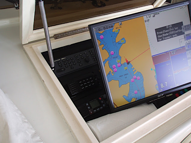

Posted - Nov 11 2010 :  08:12:14  Show Profile  Reply with Quote
The true sunlight viewable marine monitors are thousands of dollars. I have two Furuno Black Box plotters and use a 300cd brightness Acer monitor up on the bridge. It is on a RAM mount, so can be adjusted to a variety of angles; it will wash out completely in any kind of direct sun light; which has been an issue for maybe 20 minutes total in 3 1/2 years since it so easily adjustable. It folds down into a protected cabinet whose polarized lid provides some shading. Here's a pic; usually the monitor is at a 90 degree angle from what is shown, pointed at the helm. this set up has served us well for 8000 nautical miles up and down and around and through virtually the entire east coast
Tony, good move getting MacENC. Their support is outstanding and you get free and seemingly constant upgrades for life; he is very responsive in trying to incorporate customer suggestions; it's almost like an open platform, except one guy does all the coding work for you. I use it as a planning tool and chart look up while I am traveling. I just personally prefer the interface on the Furunos for running the boat. Mine use Navionics Gold. On my "when I have more money than I know what to do with" list is a "real" marine monitor as discussed on another recent thread, but I have never felt an urgent need.
The MacBook's screen is worthless for use underway, even at the lower helm there is too much day light.
