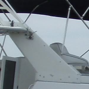

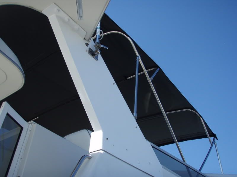

I finished the job!! It was not as hard as I thought it would be, but it was still a lot of work.
The first step was to sand the corroded spots down to the bare metal then sanded the entire arch with very fine sandpaper and I smoothed out any gouges in the existing paint.
Next I washed the entire arch with ammonia and water solution.
Next used a tack rag on the entire arch twice.
All of the bare spots were treated with alodine.
Then I treated the bare areas with metal 2 part primer Pettit 6455 Metal Primer
next painted with Pettit easypoxy
I used a 6 inch foam roller and a foam tipping brush.
Now for my mistakes!! I used a white instead of the off white. The white matches the interior vinyl but not the Gelcoat. I am going to wet sand and buff the gelcoat next weekend I hope that that will make it a closer match to the gelcoat.
after paint
B4 paint you can see the corrosion at the base
