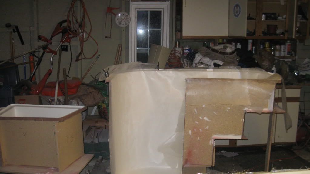

I few years ago i took on my first fiberglass build for a swim platform for a 270DA Sea ray. Link below. well i since moved into a different boat and of course am now building another one.
http://www.lakestclair.net/forums/index.ph...mp;#entry839332

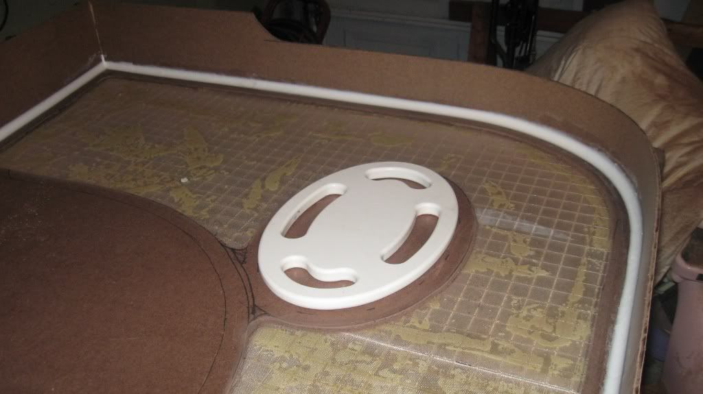

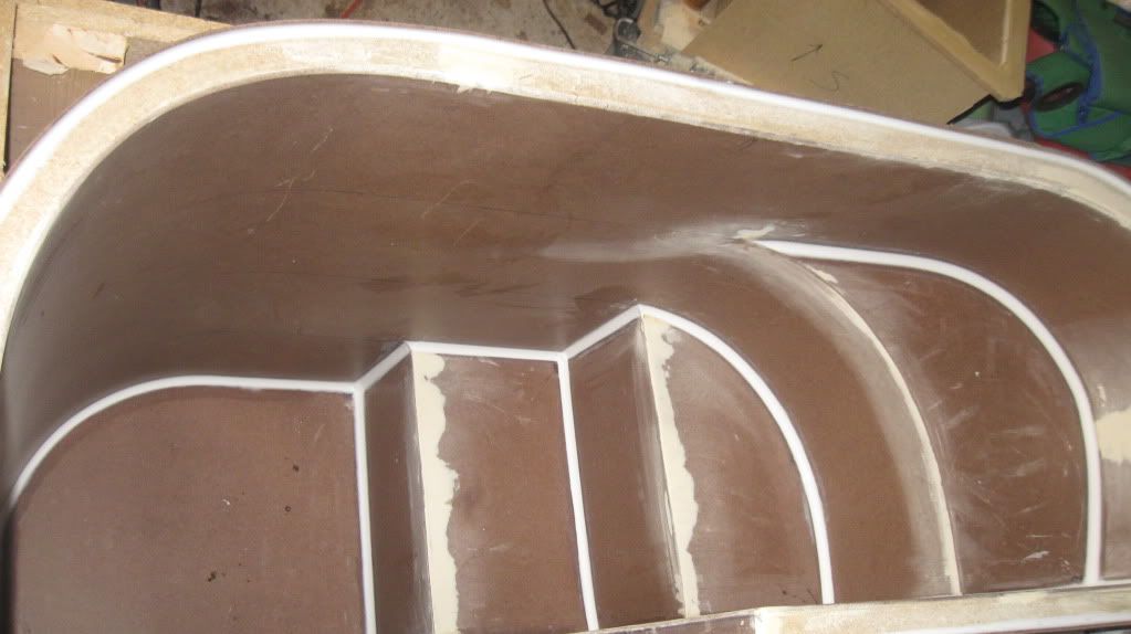

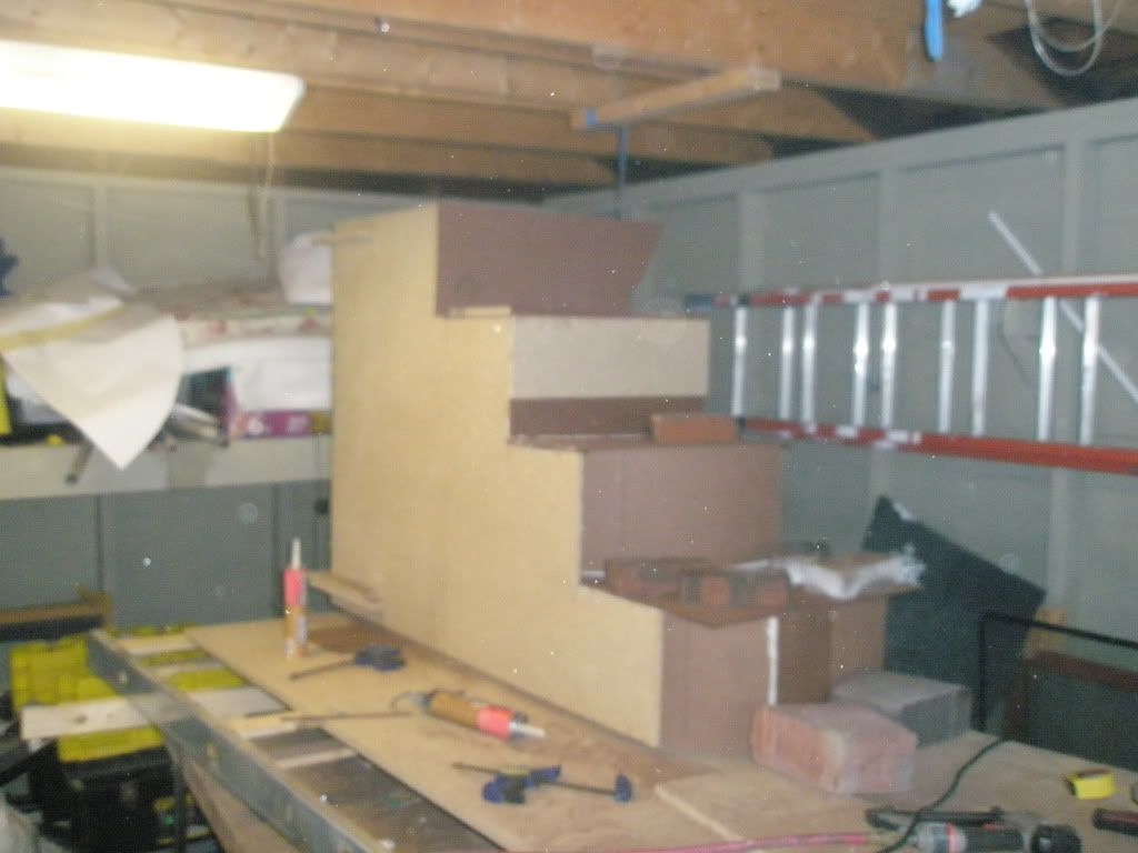

I am build this for a 86 Carver 3207 Aft Cabin. with the 80's style aft cabin you have a ladder leading down to the plate form. I am planning on putting a set of Fiberglass stairs down to it for the Kids and ease of access. i also going to incorporate a box/seat on the platform
I started with the stairs making a negative female plug. the boat has some interesting curves so i took quit a few trips to make sure the paper patters where correct. attached is the rough plug i will need to flair the plug and round the inside corners
I will update this post if anyone is interested in its progress

mjkkemper
RO# 21252
Posted - Feb 11 2011 :  12:12:26  Show Profile  Reply with Quote
Originally posted by talexander38
You get it worked out sand on your let us know , you just might be able to sale a few.:)
I should be finished with the plugs/molds mid March and the fiberglass lay up begging of April. You should be able to get quite a few pulls from these molds. I not sure what I plan doing with the molds when I am finished but if all goes well this could be a option for someone who would like the easy of acess down to the swimplatform and also a larger deck on the 3207.

Attached is a sketch of how it will look when finished and so updated pic's
http://i1238.photobucket.com/albums/ff498/mjkkemper/27003.jpg

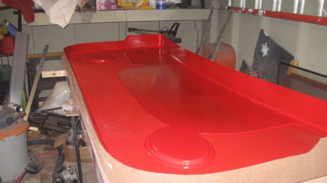

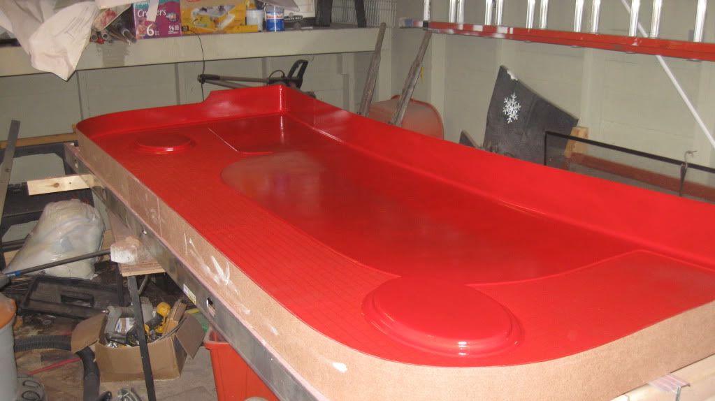

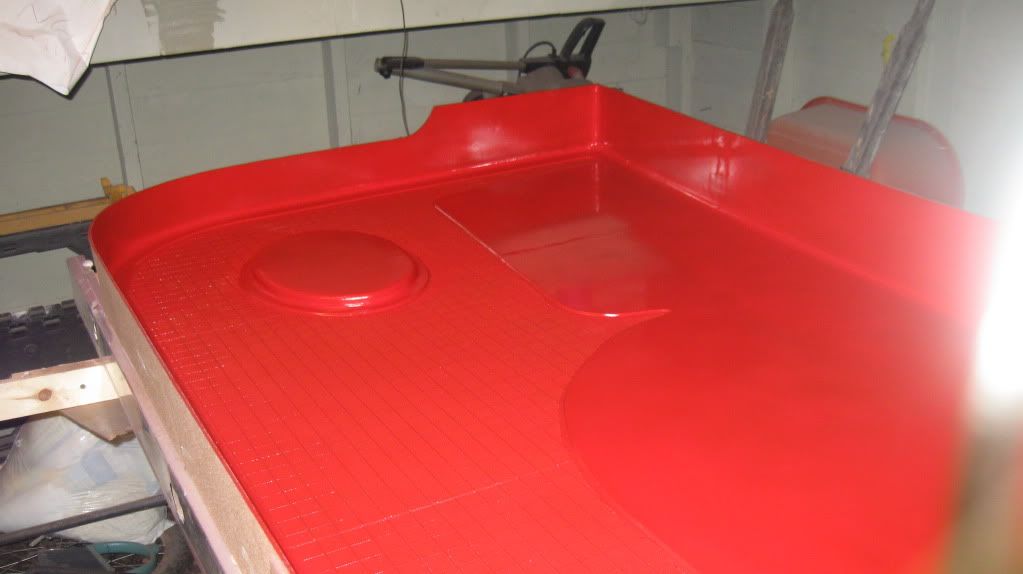

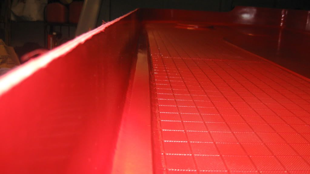

This weekends progress
Added the nonskid pattern and sides for the platform and caulk/rounded the inside corner. Need to round the rest of the corner and paint/ and the tooling gelcote to the platform

Is the sketch and the mock up an inverted?
The sketch appears to offer more room than the mock up. What changed?

Posted - Mar 01 2011 :  07:20:33  Show Profile  Reply with Quote
Originally posted by KiDa
Beautiful work. I wish I had the talent.

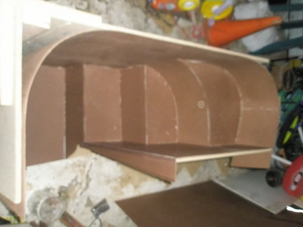

Yes these are inverted. They are the plug or molds for the fiberglass. you are in a since building from the bottom up. when demoded you flip the platform over and that is the top. In the next couple of weeks i will have the molds painted with tooling gel cote. Then they get waxed with a special wax about 8 times. At this point the actual work of the fiberglass is started.
In regards to the sketch the seat will be a little closer to the stairs. There will be about 20 inch between the stairs and the edge of the platform at its narrowest point. this about the same as the original. Around the seat area there will be more room. Also it most likely looks a little bit smaller at this point in that the blanked off sections for the stairs and seat is about 3 inch (including the rim on the stairs) larger than the stairs its self. The non-skid will be elevated about 3/16"

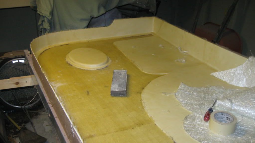

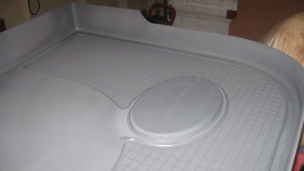

mjkkemper
RO# 21252
Posted - Mar 07 2011 :  07:08:54  Show Profile  Reply with Quote

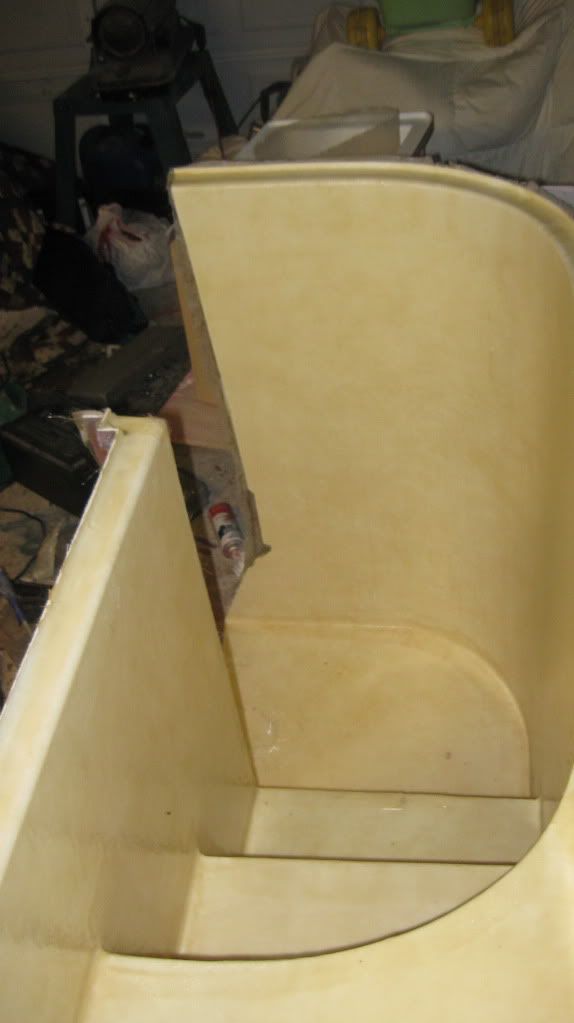

This week ends progress on the molds if anyone is intrested.
Stairs - Corners are rounded and ready to painted
Swimplatform - First coat of primer. will need to sand and repeat untill it is smothed out.
should be finishing up the molds by this coming weekend. then its off on vacation for a few weeks. Then its time to Wax the plugs and start the fiberglass layup

mjkkemper
RO# 21252

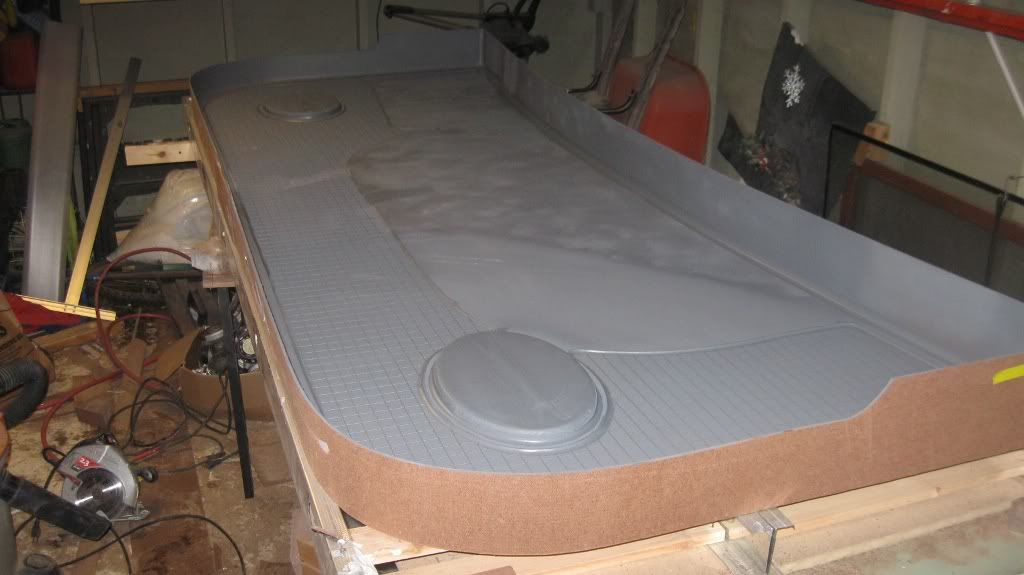

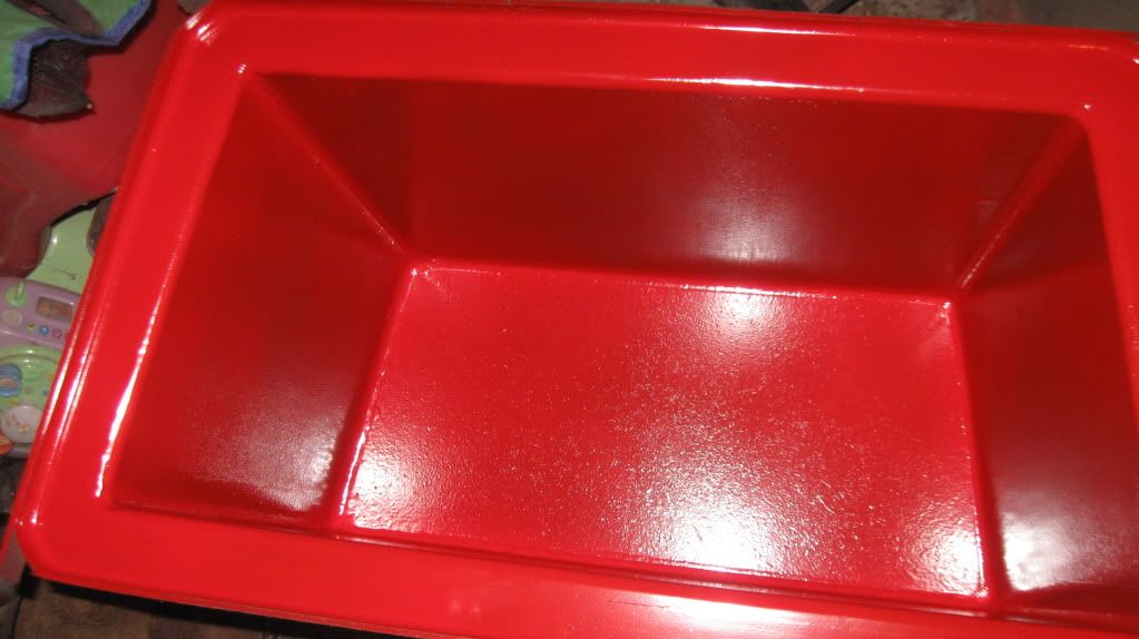

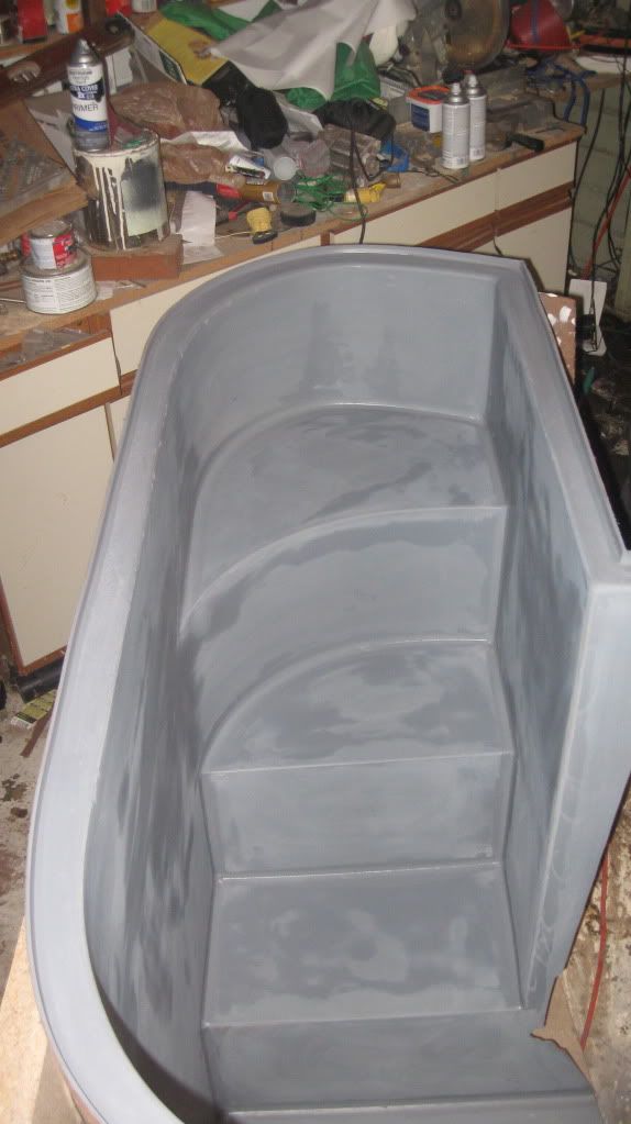

Posted - Mar 11 2011 :  08:18:45  Show Profile  Reply with Quote
-Quick update-
The Plug for the Platform is complete. Ready for Gelcote and Fiberglass when i get back from vacation. The Red color will help in making sure I have a even coat of white gelcoat.
The stairs are primed and sanded ready for their red coat.

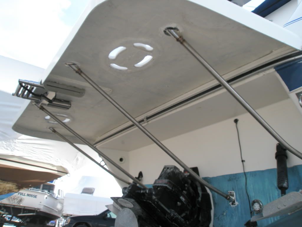

Your project looks great, however I have a question regarding the structural integrity. Are you planning to incorporate any stainless steel square tubing inbeded in the fiberglass to provide longitudinal stiffness? It looks like the swimplatform is 40 - 48" deep which may require this. On my platform which is 14' wide and 48" deep it include additional box tubing within the fiberglass to provide stiffness to the platform to help minimize flexing or bending when standing on or placing heavy object on it.
Otherwise, It looks great, can you build me a hard top for my boat?
Thank you
Support will be comprised of two elements
Coring
The core coring adds strength and reduces deflection. With coring of this nature it is the lower layer that provides the greatest strength. The layup schedule will be comprised of multiple layer of bi-axle with a layer of mat between them.
Supports
The supports will be a little different than the tube framing. The last swimplatform of this size on my previous boat I used instead of square tubing - SS 316 seamless tubing. This is what you will find on aftermarket platforms and it worked very well with my previous platform.
Both are essential in the integrity of the platform.
Both longitude and horizontally the platform will have ribs for support but will be comprised of coring and fiberglass. I do not intend on imbedding any SS supports.
I am certainly no expert but using previous experiences and methods used by others
Below is the support I used previously. The existing 4 supports will remain (they extend out 22”) 4 more support will extend out to the edge of the platform and will tie back to the lower section of the transom.
The layout of supports on the Carver will be much different than the Sea Ray below

One item I would like to bring up in regards to enbeding stainless steel. SS needs oxygen other wise it will rust (actual looks more like rote)
this all depends on the grade of stainless especially 304 in that it has no "moly"
stainless steels has poor corrosion resistance in low-oxygen and poor circulation environments

-Update-
The mold are complete and partially waxed. The Fiberglass will not be here till Monday though.
My fiberglass schedule is a follows:
PLATFORM
2 coats of parting film
2 coats of gel coat no wax
1 layer of surfacing veil
2 layers of 1.5 oz chop mat
1 layer of 1708 Bi-axle
3/8" end-grain balsa
1 layer of 1.5 chop mat
1 Layer of 1708 Bi-axle
1 layer of 1.oz chop mat
possible layer of woven fabric
STAIR
2 coats of Gelcoat no wax
1 layer of 3/4oz surface veil
2 Layers of 1.5oz mat
1 Layer of 1708 Biaxle
-coring on the steps-
2 layers of mat
Possible layer of woven fabric
SEAT
Same as the stairs
I am hoping it gets a little warmer. I heat the garage with a torpedo heater and will need to only run it between layers. My concern is at night with it getting cold out with heat off in the garage.
I will post more when I get started

Posted - Apr 18 2011 :  10:05:22  Show Profile  Reply with Quote

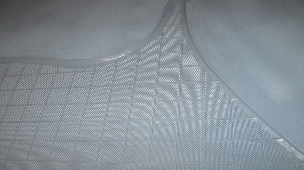

-Week end Progress-
Finished waxing and spraying the release agent
Spayed the Gelcoat on the molds
One layer of surfacing Veil (3/4oz Fiberglass) on the swimplaform

Fantastic project. Did you consider using the underside of the stairs for storage area(a)?
mjkkemper
RO# 21252
Posted - Apr 22 2011 :  09:00:59  Show Profile  Reply with Quote
Yes. I found a curved hatch on Greatlakersskipper's web site. I plan on storing the motor for the dink in there

Week end update
I finished the first layer of 3/4 Surface veil on the plugs. 2 two layers of 1.5 chopped mat on the swim platform. It took 6hrs to complete (1) layer on all the plugs. given my Lay-up schedule I have a lot of work to make my targeted splash date of May 16th.
I have been working on these over the week ends between little league practice and other stuff. i will have to start work on these on the week days at night. Their kicking my butt but I just need to think of how nice and relaxing it will be hang out on

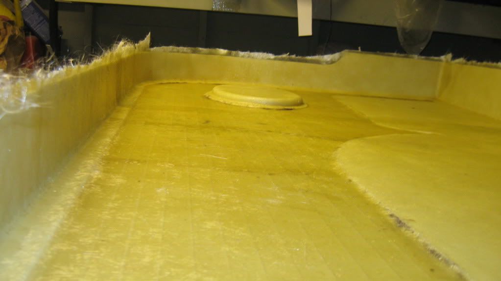

mjkkemper
RO# 21252
Posted - May 02 2011 :  07:41:09  Show Profile  Reply with Quote
Week end up date
End Grain Balsa Core
Chop Mat
Bi-axle
Horizontal stiffners

mjkkemper
RO# 21252
Posted - May 02 2011 :  19:18:09  Show Profile  Reply with Quote
Originally posted by The_Mayor
Looks fantastic! I can't wait to see it popped from the mold. What did you use for horizontal stiffners, just marine ply?
I used the balsa core. The balsa is just to sandwich the 4 layers of 17 oz bi-axle. The balsa itself adds no strength. I added just as a light weight extra support. The coring with the support legs would be adequate by why not. I am adding the last two layers tonight to the horizontal supports. Then the last layer of fiber glass. Followed by finishing the edges around the plug. Lastly spray a coat on the bottom with gel coat with wax. De-molding platform plug Friday after work.

Finishing up swim platform and de-molding pic's
