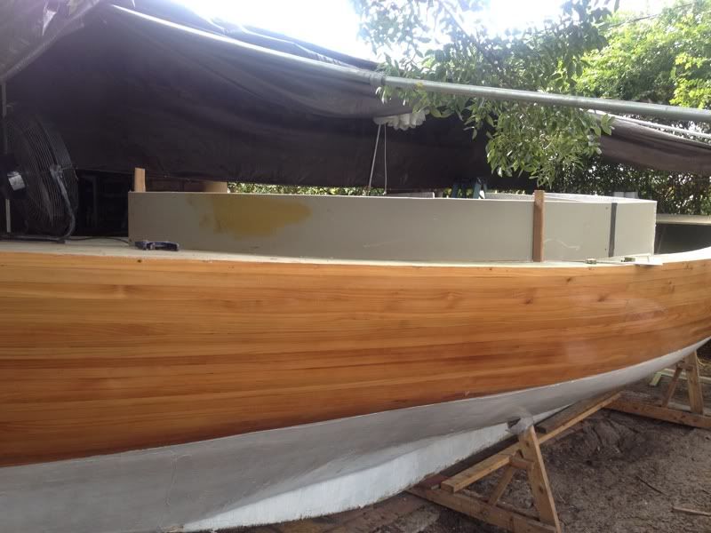

Got the hull glassed below WL on port side, along with a coat of pigmented epoxy. Next, some glassing inside; inside wood is glassed, need to finish glassing below WL and finish some tabbing, then work on floors, seats, etc
A little easier to see the lines on that side without the roof columns and clutter inside

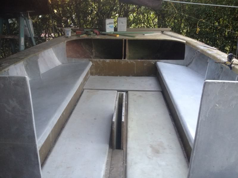

Finished the interior hull glassing, now working on the floors, benches, etc

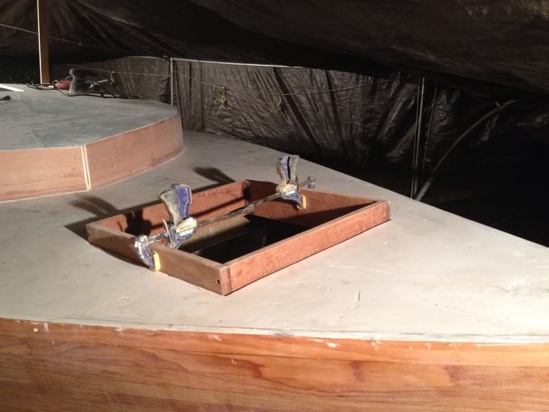

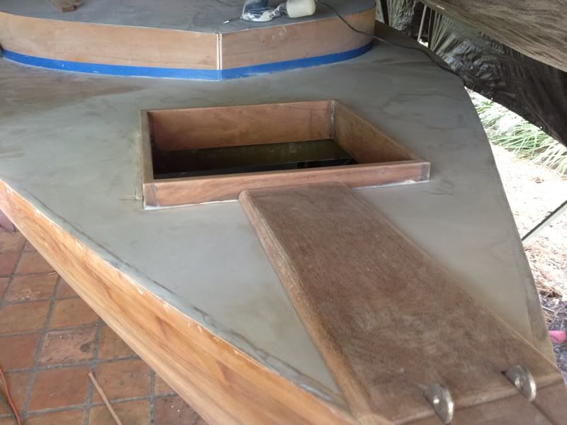

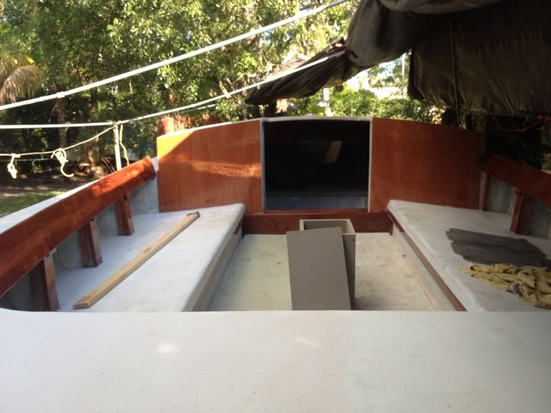

Cockpit floor hatch frames epoxied in place:
Test fitting the hatches:
I am leaving a 1" gap around the edges for water to drain out quickly. The large gap in the center will be closed and leveled with hatches after electric motor and stuffing box is installed. There will be a double gasket to prevent overflowing in the bilges:

I've never built one myself, 'glass or wood, but as a callow youth circa 1940 I was able to hangout in the oldetyme A,C. Smith Boatyard in Patchogue, LI NY. I had run aground in the inner harbor and had to seek repairs for the broken centerboard of a 16-ft Cape Cod one design boat. This gave me the chance to learn the smell of a wooden boatyard. They were well known for building and working on New York Yacht Club 40-footers of the era.
What a lovely job you're doing. A real delight to learn how far along you are. Don't falter ! Well Done.

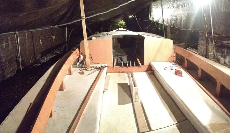

Posted - Nov 05 2012 :  10:12:58  Show Profile  Reply with Quote
Don't you hate it when works get in the way? :)

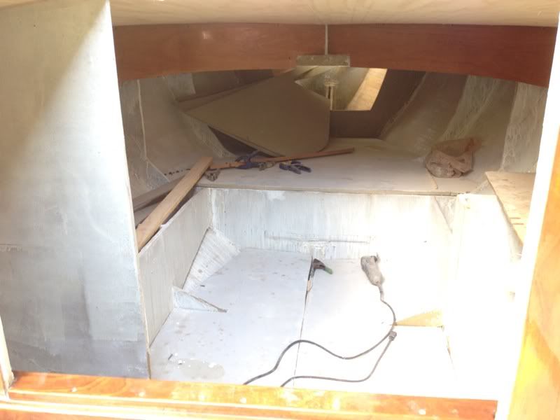

Got the cockpit benches in as well as the floors and hatches. Cabin floors are curing and going in tomorrow...
Working on cabin sides, this probably the final shape, although I may cut it down another inch

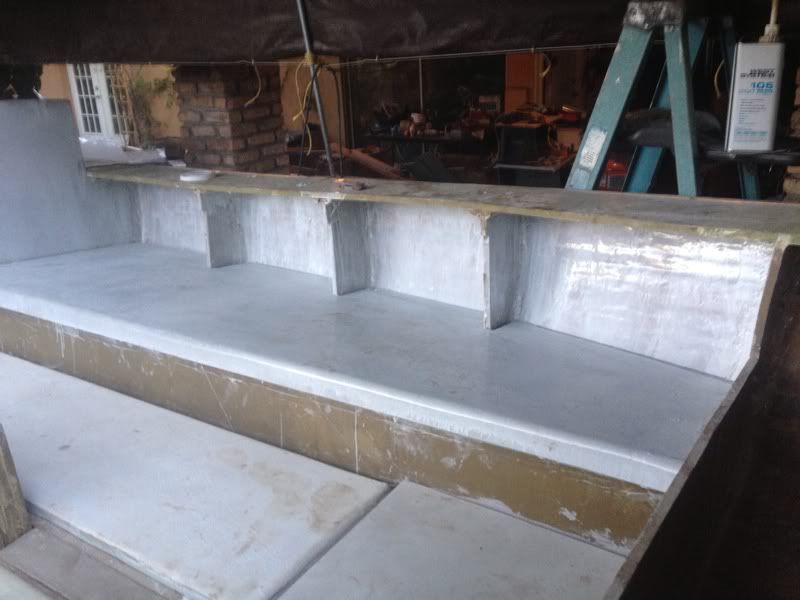

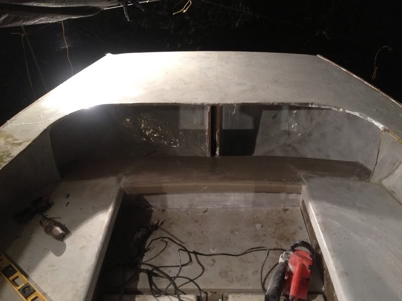

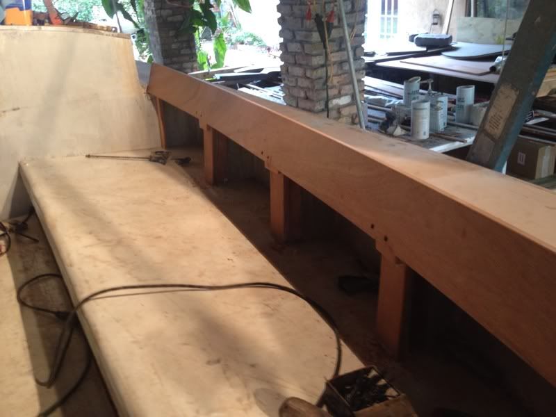

Posted - Nov 10 2012 :  12:29:20  Show Profile  Reply with Quote

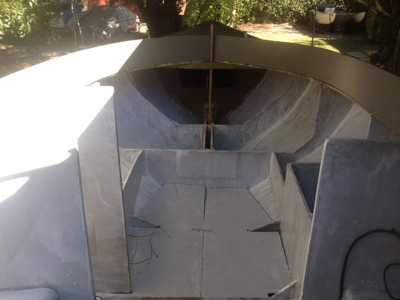

Stern bench is placed in, glassed underneath already; about to glass the top surface
Cabin side glassed in, quick coat of white pigmented epoxy on as well as the deck. Cabin sides will be covered with teak veneered ply, completly sealed with epoxy on the back and edges, plus a layer of cleat 6oz glass on the visible side
Cabin floor are in too, eventually they will be glassed in and covered with teak and holly ply
Edited by - PascalG on Nov 10 2012 12:32:25

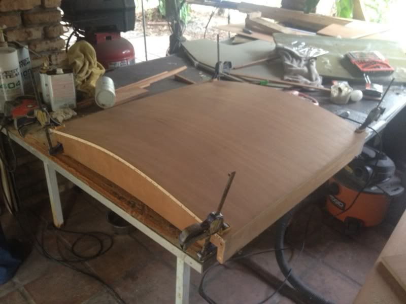

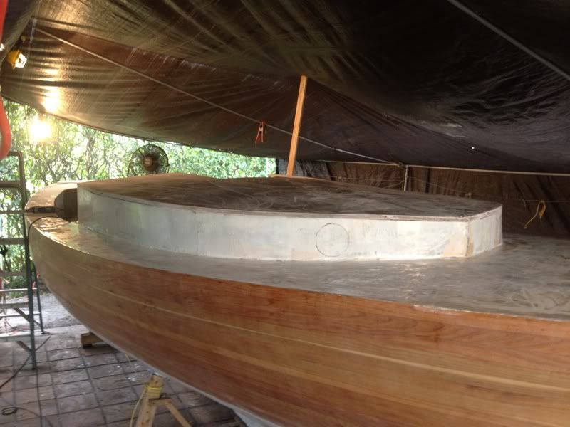

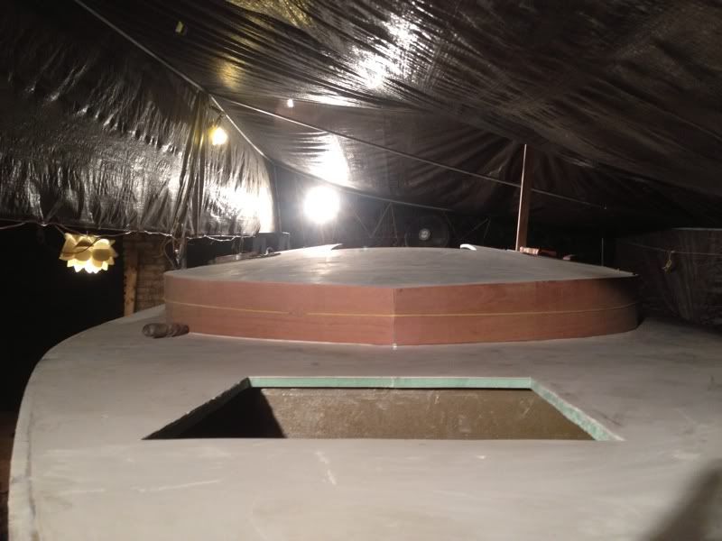

Posted - Nov 12 2012 :  12:09:48  Show Profile  Reply with Quote

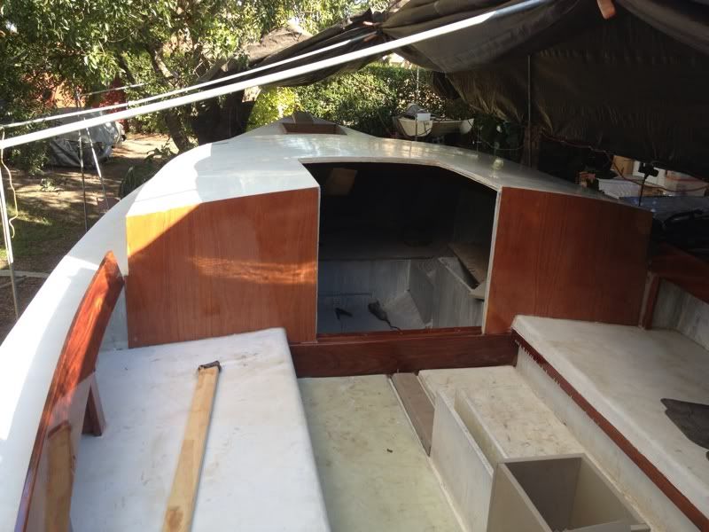

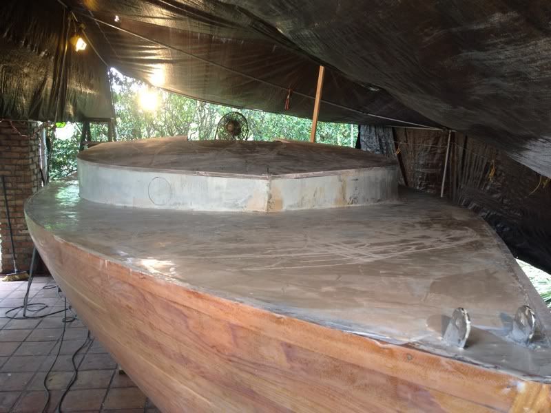

Lowered the cabin another couple of inches, was too high
Posted - Nov 16 2012 :  13:13:36  Show Profile  Reply with Quote
Cabin room is glassed on both sides. Still removable to allow better access to work inside

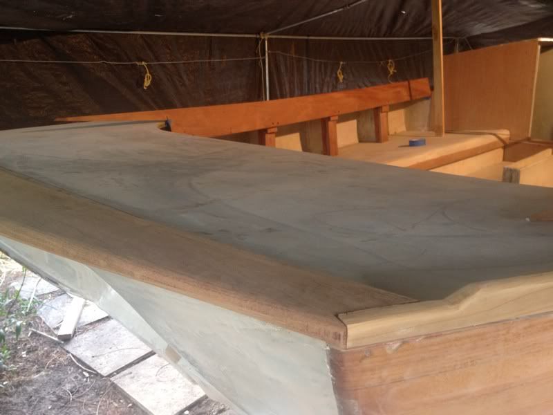

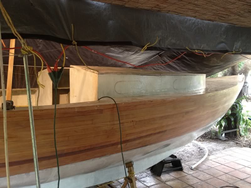

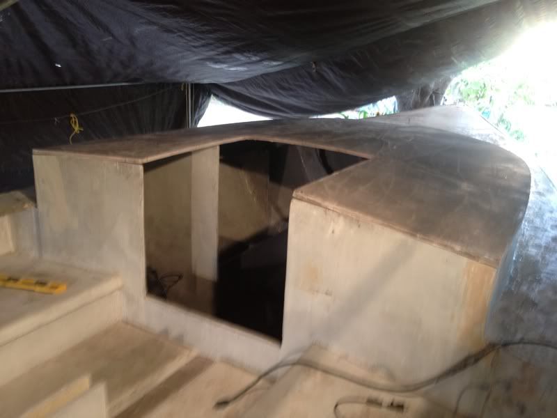

Posted - Dec 02 2012 :  12:54:32  Show Profile  Reply with Quote
The fun part has begun.. Wood trim!
Cockpit coaming (Hondurian mahogany)
Anchor locker cut out
Coaming, port side
Test fitting the hatch frame (made of Jatoba)
Hatch frame epoxied in. Bow plank will have a pair of bronze cleat
Cabin sides trimmed with mahogany ply. Back side and edges have been coated with epoxy

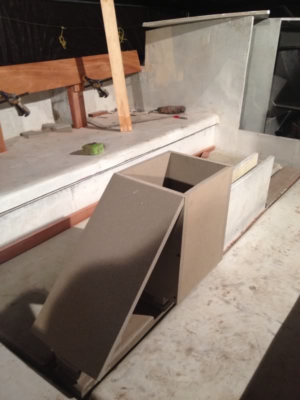

Planning for the cockpit table. First criteria is a cooler tall enough for bottles of champagne to stay upright! Angled foam board will be made in mahogany and be used for switches, VHF, sounder, etc. forward of the cooler and above the centerboard trunk will be dry storage (about 8x9x24) and drink/stem glasses holder
Sunday morning in the boatyard... I mean backyard!:
http://www.youtube.com/watch?v=HF74G6qCGJo
Posted - Dec 02 2012 :  13:09:39  Show Profile  Reply with Quote
One more... Stern trim (jatoba), with a piece of western red cedar as toe rail. Not sure yet if I m going to use WRC for the cap rail or a darker wood. Rub rail will be a dark hardwood about 1" wide with brass

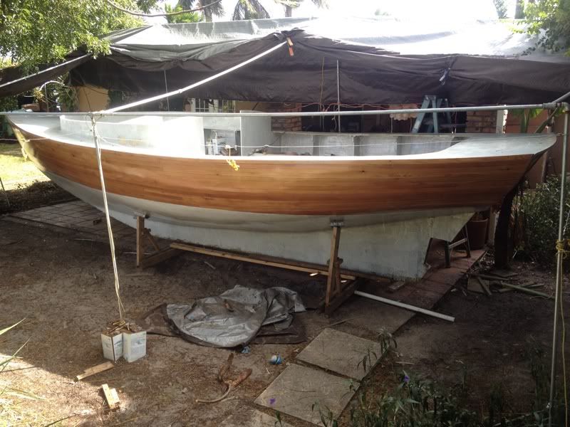

Posted - Dec 04 2012 :  19:23:02  Show Profile  Reply with Quote

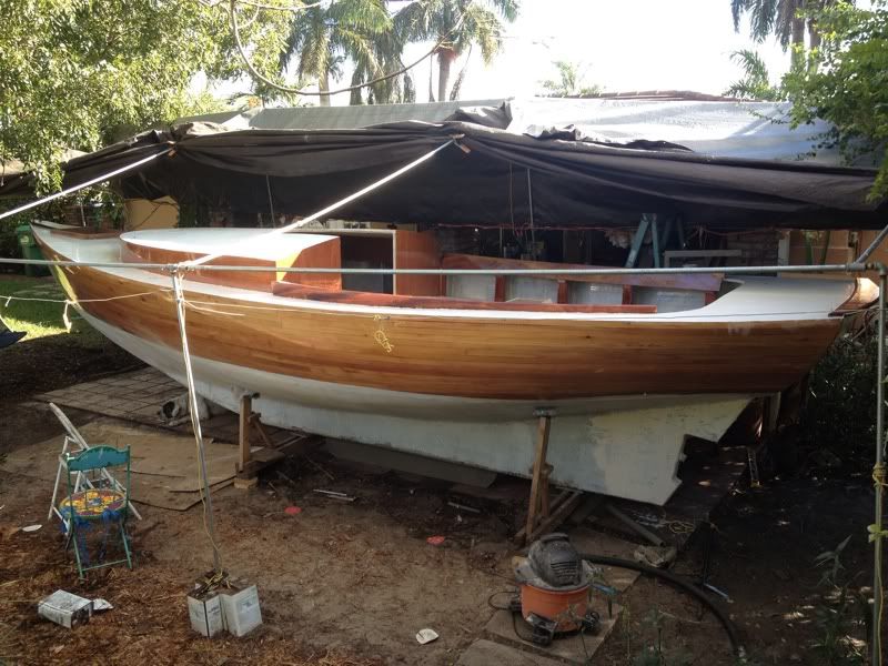

Here are two more pics taken with the cover off...
Moving along nicely! will finish fairing the decks so i can work on the toe rail and rub rail over the next few days. I want to have the hull done before heading to the exumas around the 20th with Charmer, so I can work on the spars, and finishing in jan when i get back to launch early feb. with enough testing time for Washington birthday classic regatta, which really started all this!

I still like the sheer and the coach roof is in good proportion. There are so many ugly boats today it is nice to see one that looks like a boat not a painting from Dali.
Posted - Dec 05 2012 :  08:49:47  Show Profile  Reply with Quote
Thanks! I trimmed the cabin sides 3 times before settling on the current height, I started high on purpose and took out an inch at a time till I was happy with the look. It s amazing how much difference an inch make and being a daysailor headroom isn't a real concern
There is still sitting head room. The vee berth is also big enough for two.

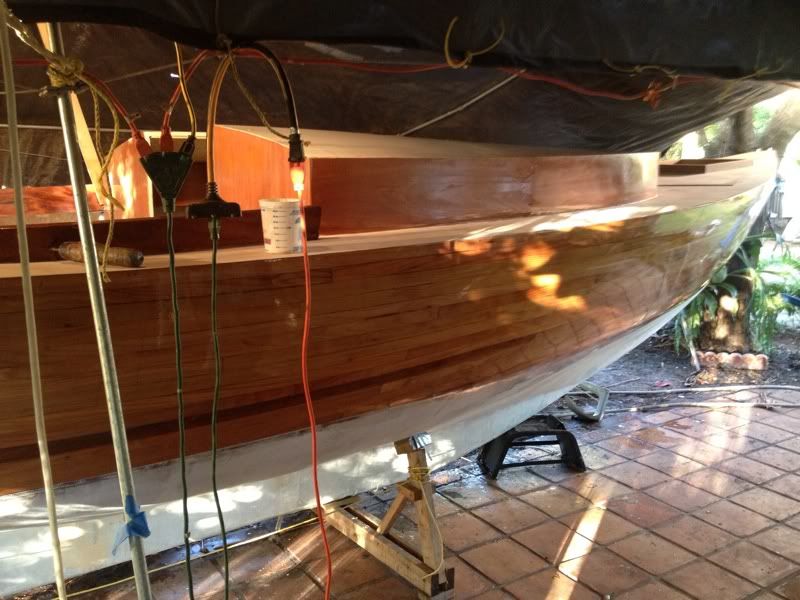

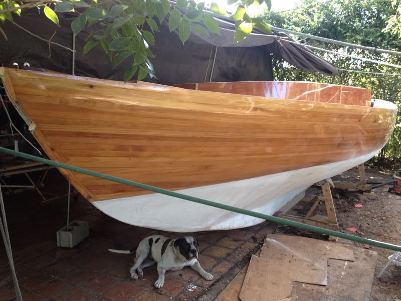

Posted - Dec 09 2012 :  15:51:47  Show Profile  Reply with Quote
First coat of epoxy on the wood, 2nd coat on the hull:

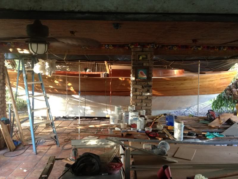

Posted - Dec 18 2012 :  14:02:46  Show Profile  Reply with Quote
Getting there!
Won't be much progress over the next couple of weeks since I ll be hard at work in the exumas :) but still planning on launching early feb.

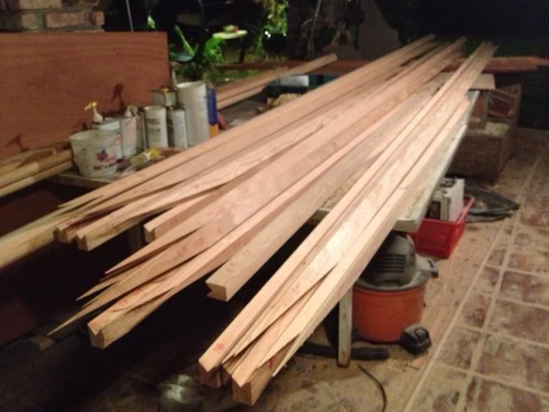

Posted - Feb 03 2013 :  08:40:41  Show Profile  Reply with Quote
Well the 2 weeks trip to the exumas was extended due to a 10 day charter turning the break into a month ! We re just 3 weeks away from the Barnacle regatta and its going to be close...
I ve ordered most of the bronze hardware (cleats, portholes, chocks...) from Spartan in Maine. All made in the USA... Not easy to find bronze portholes made in the US! only round ones we could find were made by communist china so settled for short ovals.
Deck and cockpit paint arrived, from Kirby paints out of New Bedford Ma. Turns out that not only have they been in business since 1846, still family owned and run by a Mr Kirby but they have been supplying paint to the barnacle since the days of commodore Munroe late 1800s / early 1900s
Electric motor on the way along with shaft, prop, etc

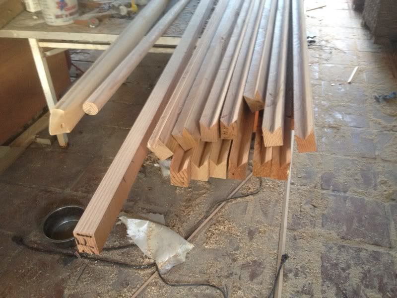

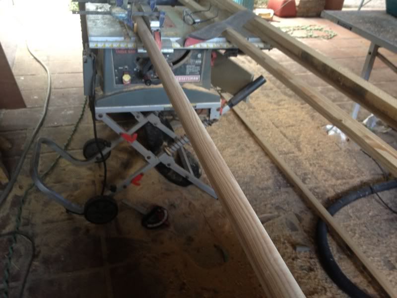

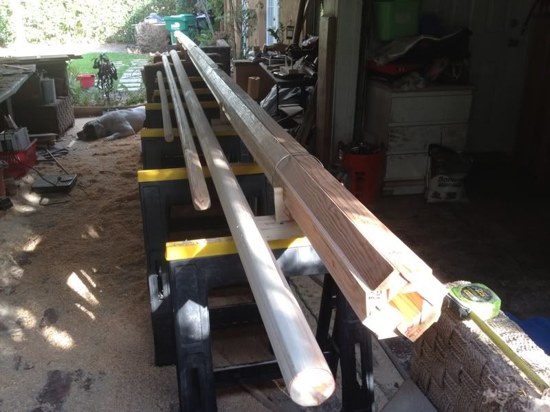

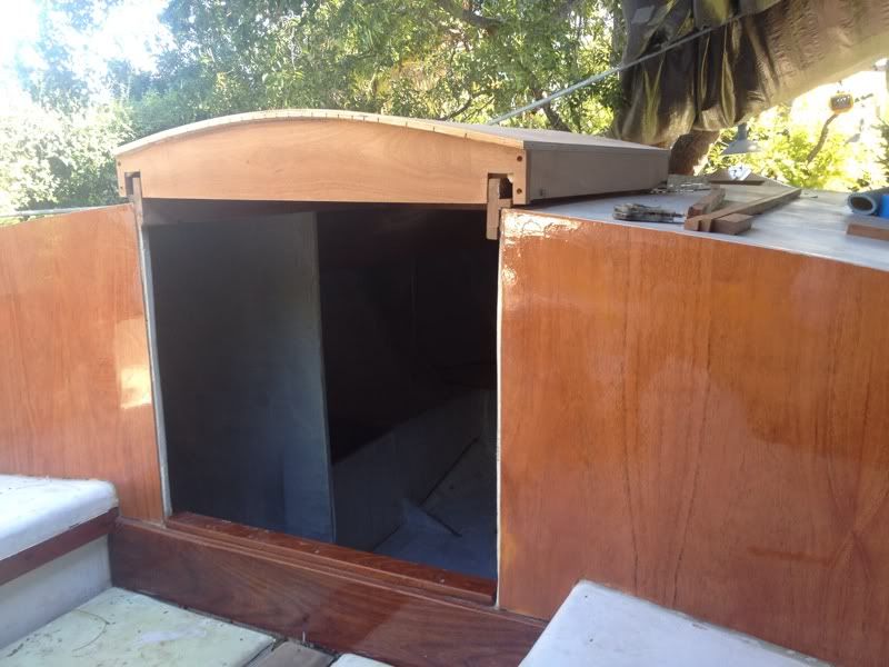

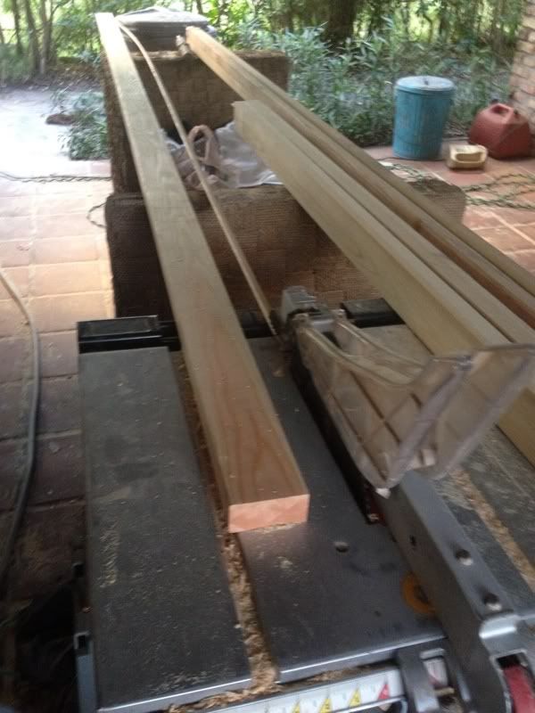

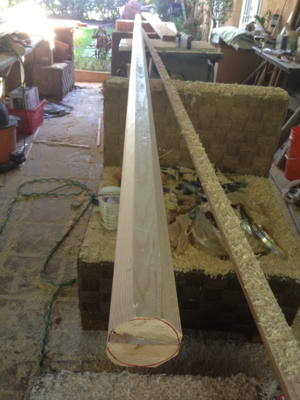

Cabin hatch is constructed along with tracks, working on the spars right now.
Still left: 2 coats of clear epoxy plus finish in hull, some fairing on bottom and bottom paint, rudder and centerboard, finishing the transom.

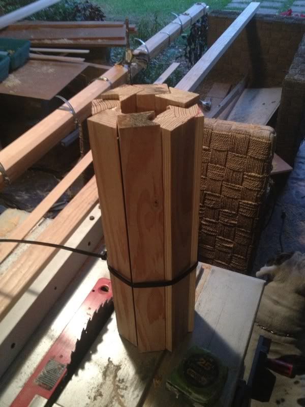

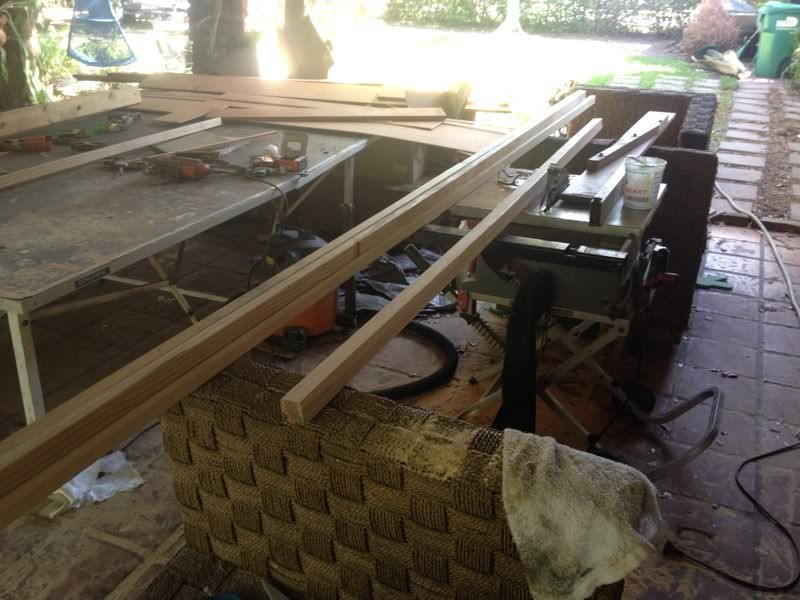

Plus a hundred other small things, all in 2 1/2 weeks! Final wood finish will be done on the mooring after launch, way too much dust and leaves here in the yard. Interior will also be done after launch.

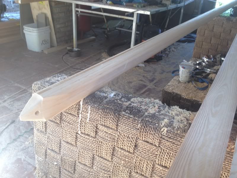

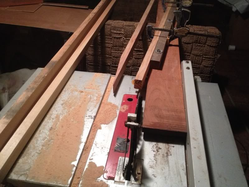

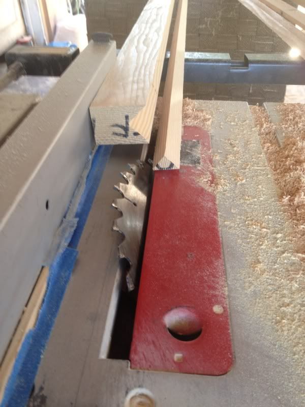

Ripping jatoba for the hatch tracks
Red neck boat stands and to raise them...
Hatch is mahogany

Home made scarfing jig
Jib boom assembled ready to shape, pieces for the gaff cut and ready to glue
Shaping the jib boom
Ripping pieces for the boom
Cutting a scarf
Gaff epoxied and clamped, boom ready to follow

Posted - Feb 04 2013 :  09:20:09  Show Profile  Reply with Quote
Shaping the end of the gaff
Test fitting some scrap pieces to check the mast diameter and cut angle
Ripping the 2x6 into 1.5 x 2 staves for the birdmouth mast.
Shaping the boom

Posted - Feb 08 2013 :  18:35:55  Show Profile  Reply with Quote
12 days to launch!
Going nuts at this point since we ve been busy with charters. Don't you hate it when work gets in the way? :)
Cutting the birdmouth on each strip for the mast
Birdmouths all cut and all pieces scarfed and marked. The trick here is that the mast is 30' long and the pieces are 16'. Each scarf uses up about 15"... But scarfing every stave using two pieces would place all the joints at the same spot on the mast creating a weak spot. So some pieces need to have two scarfing joints so they can be staggered. Each piece is numbered 1 thru 8, and lettered B M T depending if it goes at the bottom, middle or top... And each mark with dimension to make sure the joint are staggered
All pieces glued, clamped and drying
Tricky part nr 2... For the mast to be tapered (1" thinner at the top) each of the 8 staves has to tapered. Cutting from 0 to a half inch on the edge of 30' long strips is beyond my skills so I used a planer. I divided the length in 3 foot sections and shaved 1/16" on each pass, stopping 3' before the last and gradually adjusting the blade depth to 0 over the last 3' of each pass. So for instance at the top, each pieces received 8 passes totaling 1/2 while half way down it would only get 4 passes or 1/4". Worked great and only took a couple of hours. First tapered stave is on the right
Final result: a 30' tapered mast ready to glue and then shape. Plus a 19' main boom, 14' gaff and 8' jib boom
Edited by - PascalG on Feb 08 2013 18:48:24
