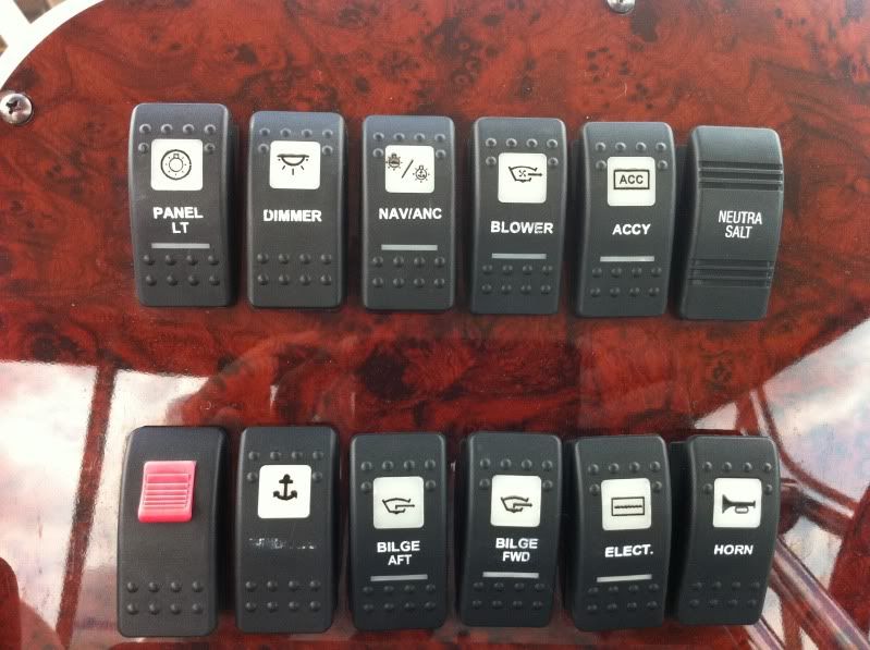

There are no labels on my dash toggle switches. Does anyone have a close up picture or copy of the schematic? In my owners manual it does not have this for the 3880.

Just did a quick Google search and i found that there are 2 different switch layouts. Did you have 1 single row on the port side of the helm or 2 rows? (I have 2 rows)

Two rows John. Thanks!

They can't all be the same, becuase not all boats have NeutraSalt, which I do.
Either way, here are mine.
The second row second switch from left is Windlass, first switch is Windlass on or off safety.

On other boats without the neutra salt switch it is marked as Accy 2.
I used it to wire blue LED lights into the bimini frame in the bridge. I used the Accy 1, marked accy in Dave's picture, to provide power to the camera I installed that lets me see the starboard side of the swim platform when I dock on that side.
The rest of your switches are wired the same as they are on the diesel version of the series.

Thanks so much. It was the two Accy switched that I was confused about.
