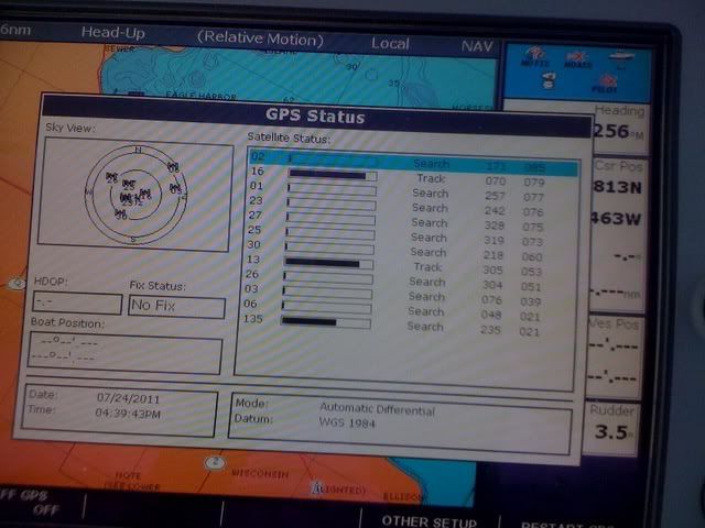

Since we bought the boat in April I have intermittently had a problem where we are cruising along and all of a sudden I lose the GPS fix. I checked all connections to the antenna, verified that with Raymarine that I had the latest antenna and upgraded the software to the latest version. I generally lose fix for anywhere from 10 seconds to 2 minutes.
The boat has 2 E120 displays, a small Raymarine ST60+ display, volvo IPS and Simrad autopilot.
Below is a picture of the GPS status when I lost fix on Sunday.
Any suggestions or ideas of what could be the problem?

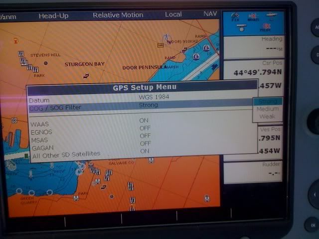

I spoke with raymarine tech support this morning. While on the phone we tested the antenna connections with a dvm and all checked out fine. The only change he had me made was under gps status - other setup - COG/SOG Filter. It was set at Medium and he had me change it to strong. The way he explained it is that this is what asks the sat for your position and by changing it to strong it will ask more often. I may also go ahead and buy a new antenna today to have on board and try if I keep losing fix on our trip over the coming weeks.

After making the changes outlined above, we ran 200 nm north from sturgeon bay wi to gore bay Canada on Friday and I haven't lost fix so far this entire trip.
