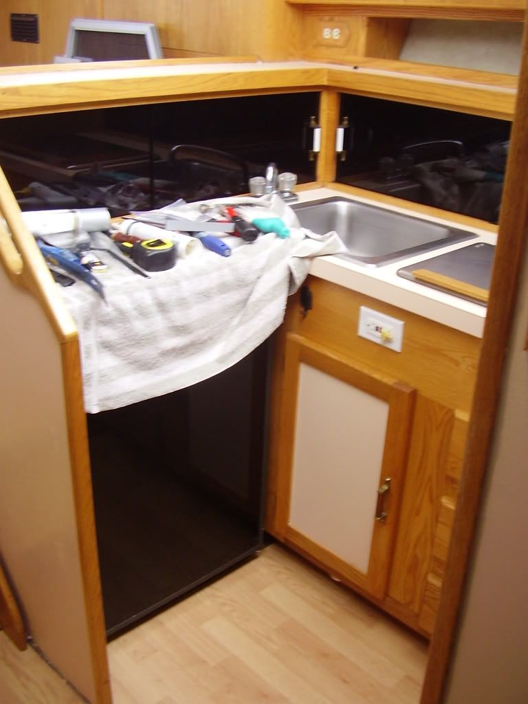

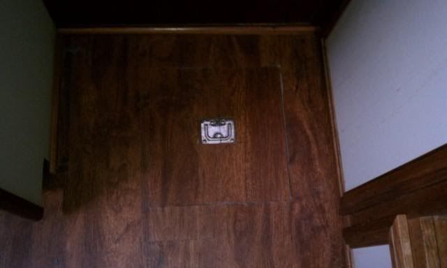

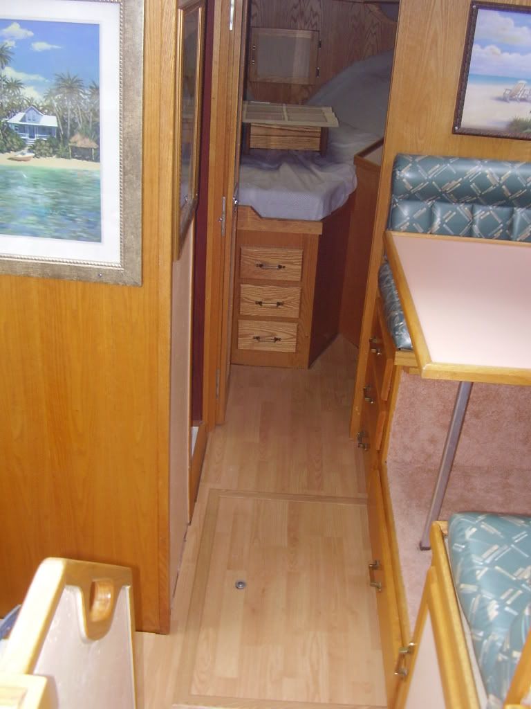

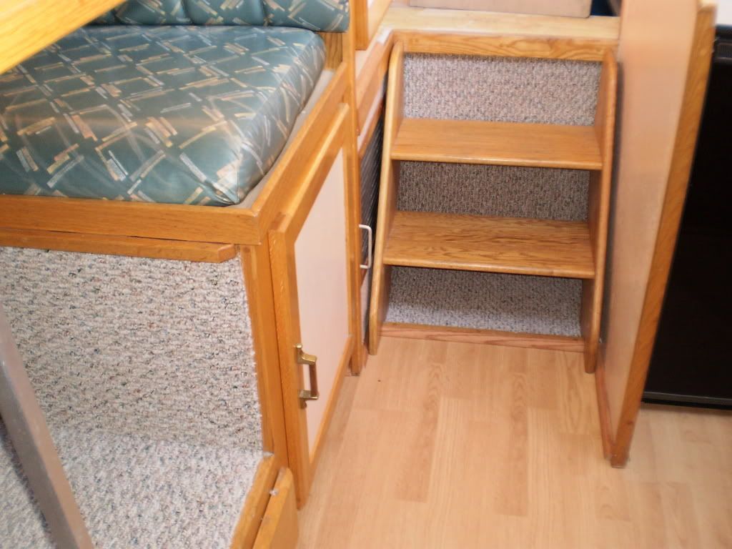

I know there was a thread about replacing carpeting, but I can't remember where it was. Anyway, here's my floor that was done this summer. Ripped up all the carpeting and put down Allure vinyl planking from Home Depot. The bonus was that I found three huge compartments that were unusable because they were covered with carpet.

That looks nice mike. What are the hatches trimmed with?
Posted - Nov 21 2011 :  20:14:56  Show Profile  Reply with Quote
I'm not sure what it's called...

Mike it looks great however when I am relaxing on my boat I walk around in thick gym socks. It looks like the floor would be cold on my tired old feet and I would lose the insulation from the carpet.
It does look really nice though. How slippery is the surface? I am curious.

Bill, we have throw rugs. There is a grain in the "wood" so it's not slippery at all.

Looks good I like the feel carpet but I like the look of a wood floor. I also like the access hatches you made I have no access to those areas and someday I'm sure I will need it.

Dave, I couldn't stand the dirty carpet anymore. Carpet does not make sense on a boat, it gets dirty and wet, I guess it's just a lot cheaper for the builders.
Wait til you have to access the water tank! It's under the stairs.
Posted - Nov 22 2011 :  07:06:14  Show Profile  Reply with Quote
Did you make a template with heavy paper first and use that to cut the new flooring? Any steps and how did you trim those out?

So those hatches are not original and were added by someone or they were just covered over?
Why would someone cover a hatch!

Do you have any more noise without the carpet?
I also have to replace our carpet this winter but since we run from inside most of the time I’m concerned that the Engine noise will increase with all wood flooring since the carpet deadens some of this

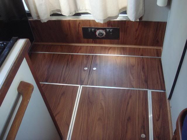

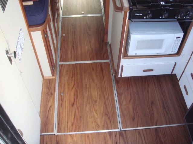

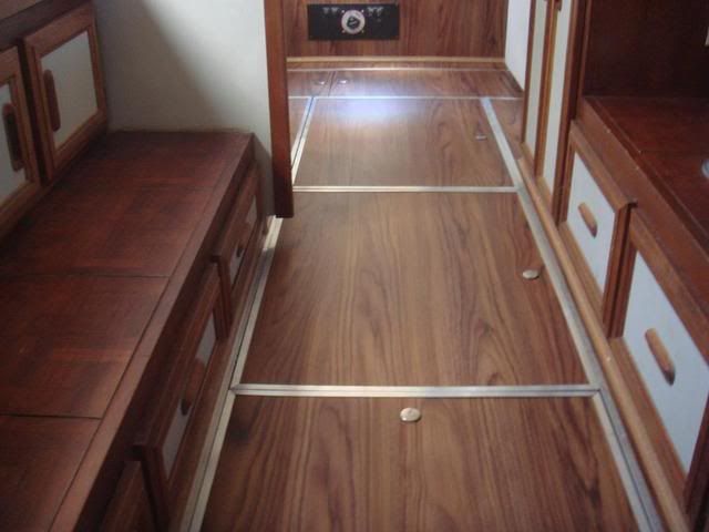

Here's some pictures of the flooring in Tony's Carver. The last one is of mine in my Trojan. Being in a covered slip I didn't have too much light, so the pic is not that great. But I would definetly recommend installing.

Redid my floors in exactly the same Allure "Teak". late last year. I also use throw rugs. If they get dirty or wet just take them up and clean them. (or replace them)
So far, this stuff is wearing like iron. I used regular tile glue to put it down because i didn;t trust the glued tabs for the long term. I hope to God I never have to try to take this stuff up.

I had to cut a couple of new hatches to tighten up the spacing between them, Thought about the added heat and noise ,replaced all the factory sound shield with some that has a "lead" sheet between the foam and a foil covering. I glued the flooring down with vinyl floor glue. And doing this also allowed me to put 3 new hatches in my floor. Now I can get to my gen-set and sea-cocks without moving everything..

Tony, what did you use for the under hatch sound dampening...Sound Down is pretty pricey, figured you had an alternative?

What is the trim around the hatches and where did you get it?

Sound down seems to be what I got Jamie. To redo every hatch was around $200.00 and worth it.. Boatbum I catch the finger pulls less now that they lay flat on the floor, I did move one as so it's not in the main path way.

I used 5/8" aluminum "L" molding bought from Home Depot.
