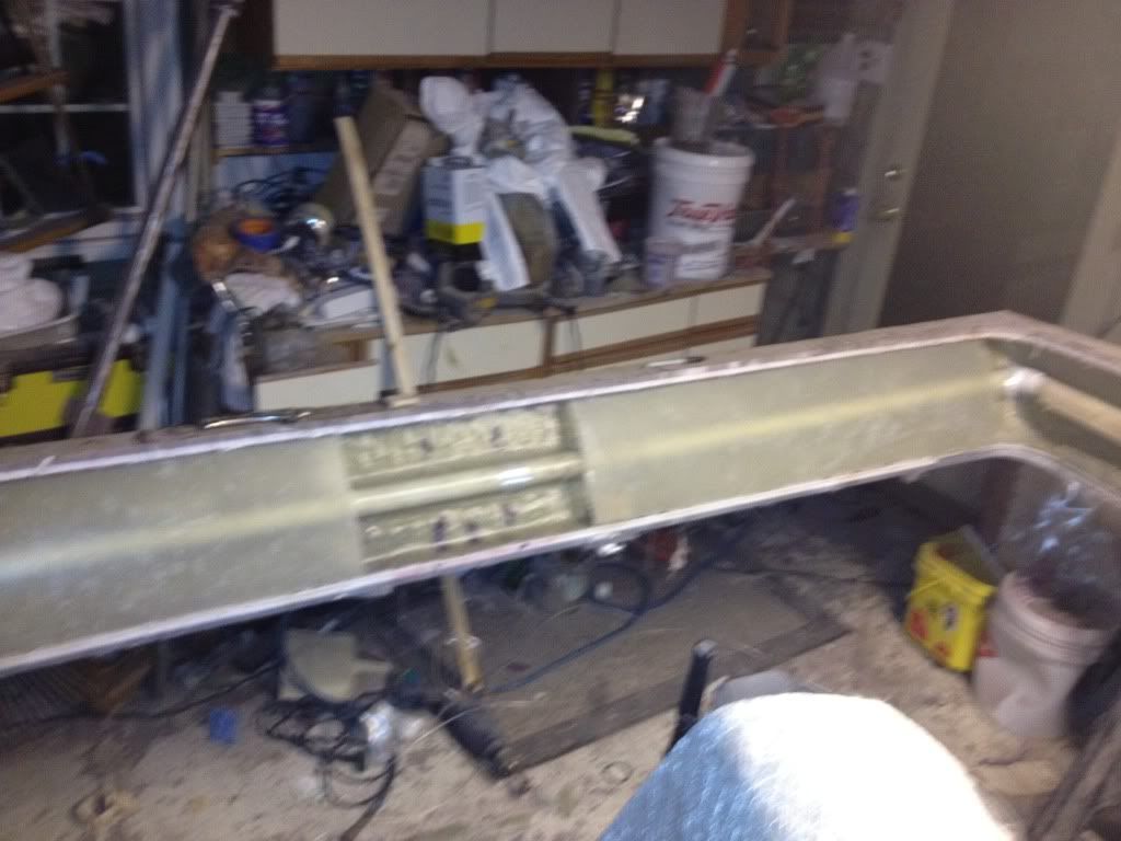

I havent updated lately but below is my progress
Gel Coat
First layer - Veil
Wetted out
Second layer - Chop Mat
Next 3 layers of 1708 Bi-axle. then close up the back.
http://i1238.photobucket.com/albums/ff498/mjkkemper/27003.jpg

Finishing the last layer of biaxle.
overlaped the piece that will hold the back piece.
I will be flipping the plug over to put the bottom flap on. The inside pieces I will wet the pattern of the back - one layer of chopped mat on a waxed piece of white melamine. once its sets up it will be ridged but yet flexible. this will tie into the flap in the picture above. After that is in I will build up the inside until its flush. I alread incorportated the inside curve in the mold which is removable. Also I will be running a PVC tube up the middle in the inside for a chase. After a couple of layers on the inside wall I will drill a pour hole in the bottom and a relief hole in the top and fill the cavity with Closed Cell Urethane Foam. 2lb density should be adequate. This will glue the inside piece in as well as dreading the sound. I could use a denser mixture but I am not filling the core for strength. I will try and take a video of the foam expanding in the chamber.

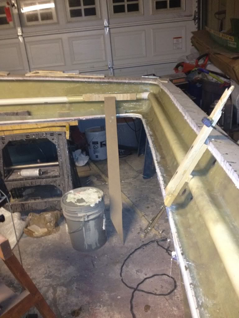

Posted - Apr 05 2012 :  07:28:08  Show Profile  Reply with Quote
Put in the chase for the Radar and Satillite cables.
Making the inside pannels
Dry fit of the inside panels
Once the inside panels are in i will fill the cavity with 3LB closed cell Urathan two part expanding foam. In the enclosed area i should get a 4Lb or greater setup.
After this will be building up the inside to match. At this time i will probaly demold.

mjkkemper
RO# 21252
Posted - Apr 14 2012 :  17:00:14  Show Profile  Reply with Quote
Finished the inside first layer and filled with the two part urathan closed cell foam and de-molded.
One more layer on the inside than flare out with resin mixed with micro balloons.
