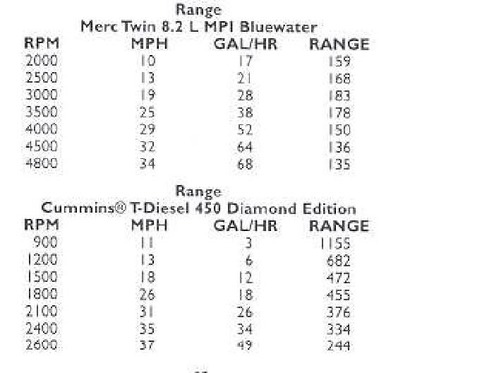

I would like fuel consumption information for this model. The factory specs for 8.2L gas engines are 38 GPH at 25 MPH and 8.3 diesel is 18 GPH at 26 MPH. Does it really use 20 GPH more in the gas configuration? Can anyone tell me if those numbers are correct? What cruise speed do you run your boat? The 4085 Avanti is factory rated with 8.2L gas at 32 GPH at 26.3 MPH and 5.9 diesels at 29.8 GPH at 28.3 MPH. The gas engines only cost about 15% more in fuel and most of that is offset by the higher diesel fuel prices. I think their numbers are quite different considering the similarity in size. Both boats are about 43' by 13.6' and 22,000 lbs. I could not get a response from Avanti owners to confirm their numbers. I know these two boats are almost apples and oranges, but they were chosen because they fit in my boat well. I am trying to learn where the tipping point is that makes it advantageous to spend more for a diesel powered boat. Thanks.

8.2L gas burning 38 GPH pushing a 41PC at 25 mph is probably quite accurate.
The 18 GPH combined figure for the C-Series Cummins however, isn't right. That's PER engine, running just above 2,400 RPM, which I would expect to go more than 26 mph at that RPM - I'd expect 25-26 KNOTS.
It sounds to me as though someone collecting stats confused burn for each engine with combined, and mps with knots.

I owned a 41PC with Cummins 450C’s(8.3), by far the best boat we have ever owned
At about 26MPH there is indeed a 20+GPH difference between the Gas/Diesel
At 26kts the Cummins it was only about 1900RPM and 26/28 GPH for both engines.
I ran the boat very often at a 2400RPM cruise at 28-30Kts with a 34-37GPH burn.
Even though boats your comparing have very close spec’s you have to remember the Formula has a deeper V and needs more HP/Fuel to push it through the water. Because of this deep V I would think the Formula has less room. But the ride is incredible.

Thanks for the responses; it is difficult to learn some information. The specs I quoted come from their manufacturers. The Formula specs come from the chart that Abalmuth posted. To further support the Cummins specs, I researched the 8.3L engine on the Cummins web site. Their specs show fuel consumption of 8.2 GPH at 1800 RPM. If the 8.3L truly burns 18GPH at 26MPH it is the holy grail of marine power plants. If the Formula deep V hull causes increased gasoline consumption (8.2L Avanti burns 32GPH) what explains the exceptional fuel consumption numbers for the diesel configuration (5.9L Avanti burns 29.8GPH)? I wish someone could confirm.
