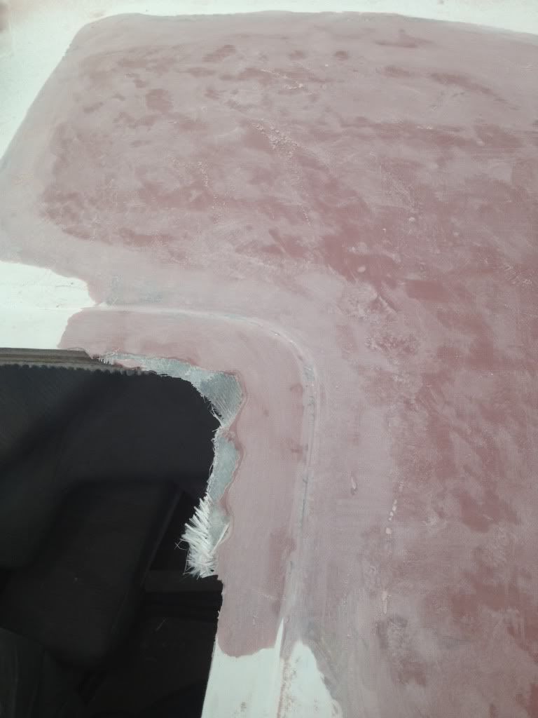

I am fixing a hatch leak on my 3207
Nasty stuff. I did know when I bought it I would have to fix it so no complaints but I will go the extra step to make sure it doesn't happen again
As of today - new core and fiberglass
One more skim of flaring then gel coat

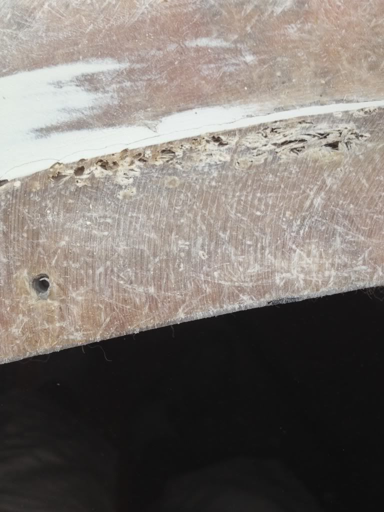

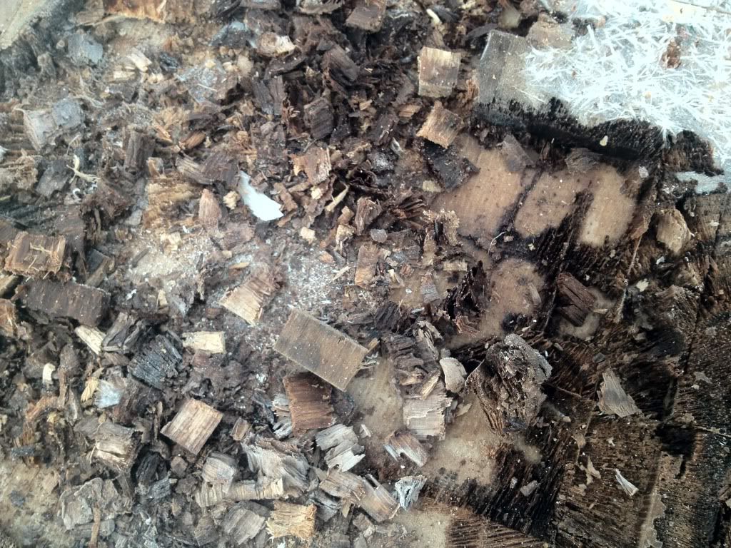

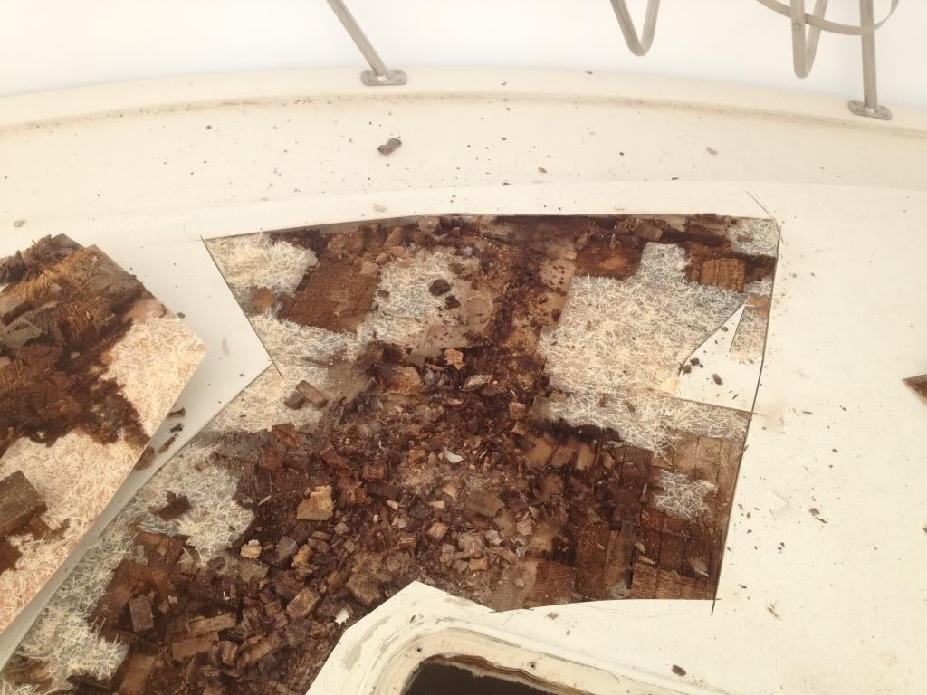

The dark area is the hatch area. I have to trim back the fiberglass overlay (picture in previous post) In looking at the pic - up is the bow, right is starboard.
When I ground down the flang area to overlay the new glass I found air pockets - see below
When I bought the boat the hatch was burgered up with caulk on the front starboard side. Removing the caulk I found a crack. Grinding down the Fiberglas I found air pockets from the original layup. If you look closely you can see the small crack in the white gel coat next to the rased hatch flange
The rote was from this point down to the starboard side. Manufactures defect and a poor fix is my opinion
http://i1238.photobucket.com/albums/ff498/mjkkemper/27003.jpg
