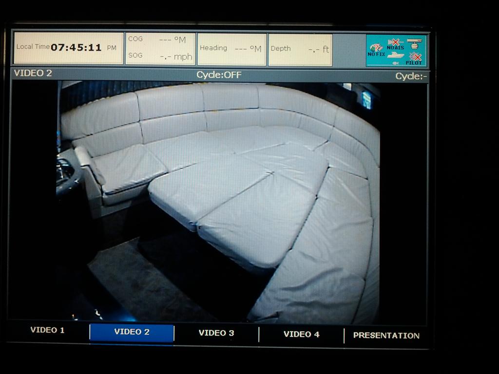

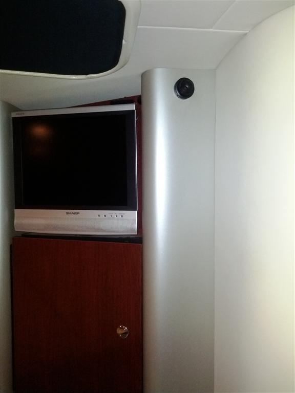

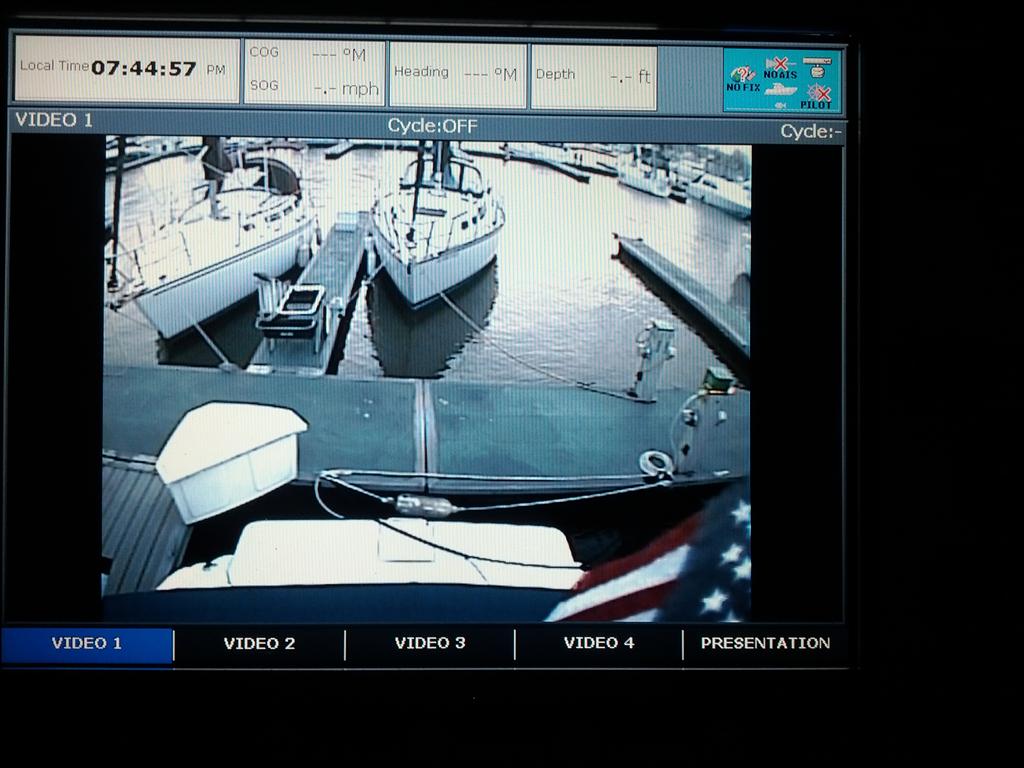

Got two cameras installed yesterday, thanks to my buddies Chris and Dave.

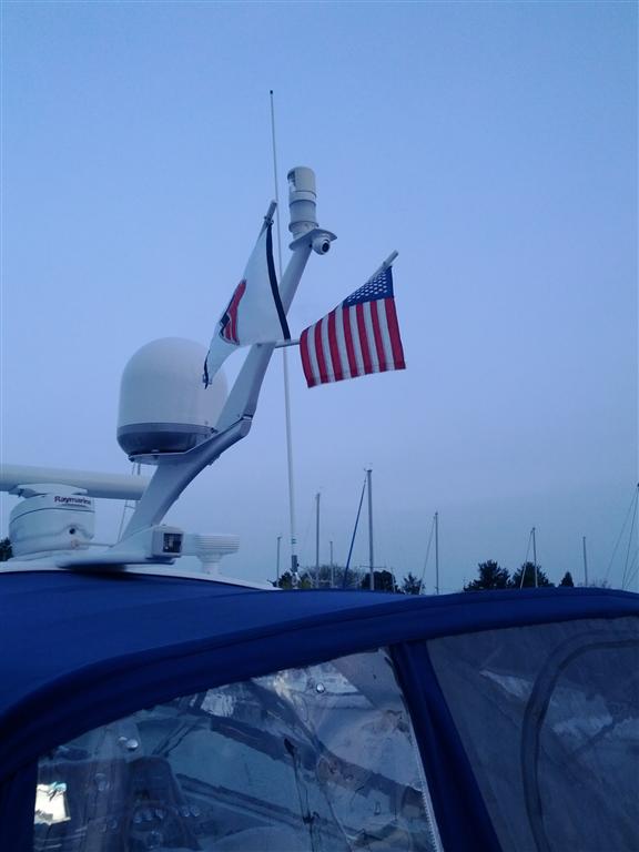

Thanks for the offer, unfortunetly I was doing some work yesterday and had to leave early for a party. Next week if you are areound I'll stop by. The pics look great. I like the one on the mast.
Dave, I think I may want to go with the reverse so when I am out cruising it would look the same. The one on Bens mast is reverse correct?

Correct. On the mast is the Garmin GC10 NTSC Reverse Camera. It's a little pricey, but if you hunt around you can find it online for $400. We cut off the lead so that it would fit through a tiny grommet and then soldered a new lead on to it. That mast comes down in the winter so I needed a connector at the base of the mast. Otherwise, I'd have just soldered the cable directly to the lead that we cut off. It connects to the 4-lead pigtail that comes out the back of the E120. I'm pretty sure the E80 is the same way.

I must say you did an amazing job installing the camera on the mast I'm very impressed with the wide angle field of view as well! I may have to change out may camera but as you know the shoe makers kids never have the best shoes. I'm looking forward to installing the DVR and tying in the WIFI you will be able to watch your cameras on you cell phone when we are done. Just keep this in mind next time you bring your girlfriend to the boat you never know the wife might be watching:)
