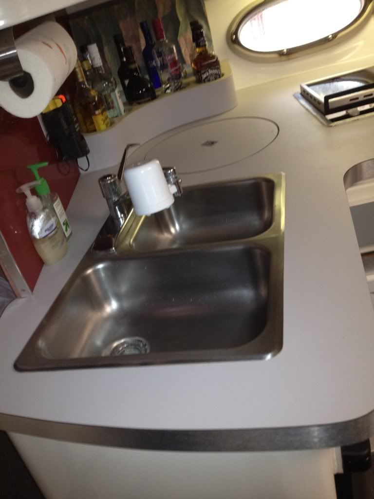

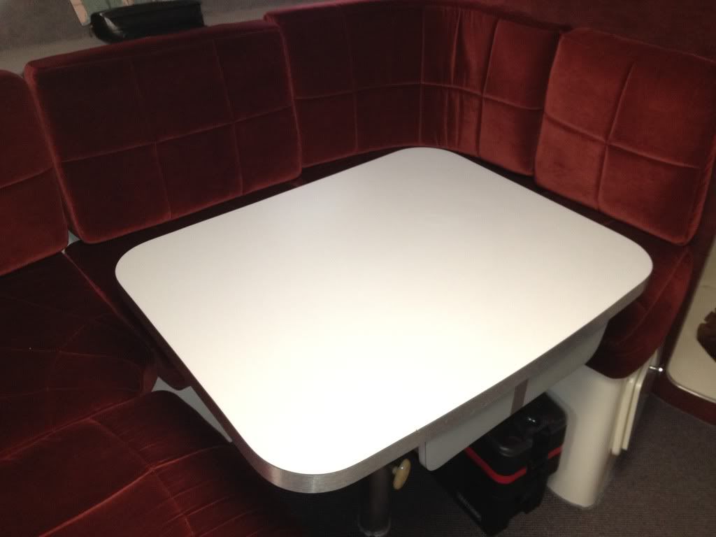

RO# 25075
Posted - Jun 14 2012 :  20:59:20  Show Profile  Reply with Quote
Thanks for all the teriffic info.
I tried one last direction... (photos below)
1. barkeepers friend
2. tilex
3. magic eraser (the wonder product)
4. COUNTERTOP MAGIC
soaked the laminate countertops LIBERALLY and allowed it to soak in, but not to dry.
REAL DIFFERENCE !
we're good for yet another season.
now the wetbar outside, that's another story.....
photos follow.
THANKS !
