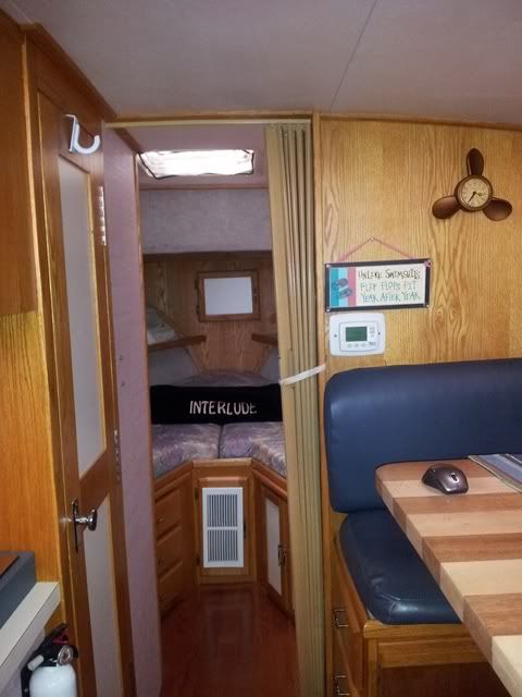

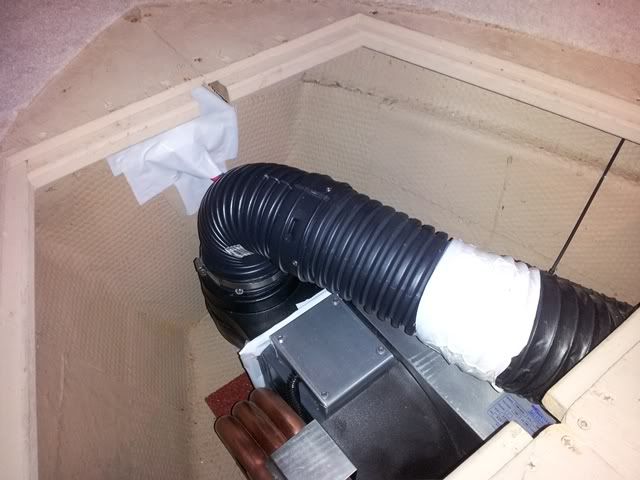

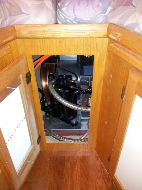

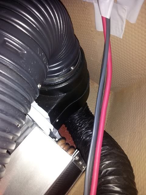

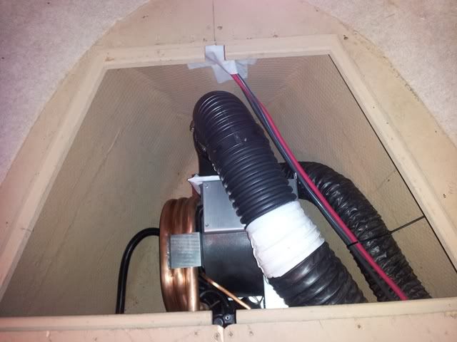

Here is my setup.
Thermostat is out of the sun and on the opposite wall of the v-berth. I added the grill on the door. Door was solid on the old Cruiseair unit.
The old unit was top exit and the new is rear. I used the T from the old, 4" pointing down and 5" point up. I had to add some hose to the top run. I taped off the joints and the flange where the T attached. It all seems pretty air tight, little lose of air if any. I also taped off holes in the area that lead off to various areas like the anchor locker.
Both runs go down the starboard side; the 4" just comes up into a locker in the v-berth and provides air to the v-berth. The 5" line snakes out under the dinette and blows air into the galley. Both of these runs were used on the old unit.
I can still cut some hole in the storage areas on the right side and put a grill on one of those doors if you think I need more air.

Niles,
Two thing I see that indicate restricted air flow:
1. The 5 inch duct looks like it come over then in front of the air intake on the starboard side as it runs under the v- berth.
2. Air intake is facing the starboard side hull which will reduce air flow. I understand that is probably the only way it will fit in the location.
Keep the vent door open on a warm day to see if it freezes up. If it does not, then you know it is air related. If it does, then refridgerant may be needed. Remember 144 square inches of air to the front of the intake.

You have what amounts to a 180 deg bend right after the fan, that's gotta hurt the air flow.
I'd be tempted to try some 4" or larger PVC fittings for duct work, they're smooth inside and should give you better flow.
Or make a plenum box to fit on the fan discharge, and run your ducts from that. The bigger the box and the more ducts you can run, the less restriction there'll be. I had to do this with my AC.
On some units you can unbolt the fan and turn it, so it points up like the old one did.

Posted - May 25 2012 :  12:38:47  Show Profile  Reply with Quote
First off, thanks everyone your feedback.
When I got to the boat last night I opened up everything, the top cover and the front door. I started the unit, it showed 77 on the stat and I set it to 73. After 25 minutes it started to ice a little on the coils, at 35 minutes it had brought down the temp to 73 and turned off. So it didn’t run long enough to really ice up but this weekend it will get a good test.
OB is going to send me the parts to do another run and maybe reconfigure the current a little. I have room to do a 4” through the bottom of the v-berth lockers, into and through the vanity in the head and into the base cabinets in the galley and exit pointing toward the dinette. In the attached picture I have marked where the current 5” exits and the proposed 4” will be.
Is there any problem having 2 vents somewhat in the same area?
Thanks and everyone have a great\safe holiday weekend
