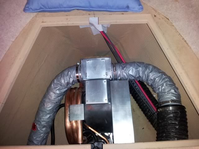

I am waiting for Ocean Breeze to send me the parts to add the additional run. In the meantime I wrapped that section with the 90 degree bent with duct instillation. The hot weather we were supposed to have this weekend never happened so the unit has been cycling on and off like normal without icing up. Maybe today it will stay hot and it will get a good test. If the coils turn a little white is that normal?

It sounds like by a little white you mean they are at the initial phase of icing up. I would say it's ok as long as the unit doesn't shut down or fully ice up. I would proceed with adding the extra duct and wait for warmer weather. It was plenty hot here yesterday but very comfortable when inside the boat.

I installed the 3rd run today. I went through the forward head into the galley cabinets and exited it in the galley. The plenum box I got from Flagship Marine was the wrong size so I called OB and they sent me one overnight. I wanted the exits out the sides and one down but the one I got would have been up\down\left with the way my blower outlet is orientated so I had one of the guys in our machine shop rework it so it was right. I turned the unit on and it brought it down from 79 to 73 without freezing up. There was a little white on the coils but I won’t know for sure until I have a chance to really run it. We have a wedding to attend this afternoon so I turn it off. I’ll give it a good test tomorrow.

Well you have the AC power up to standard, return and proper ducts and grills it should work. If not you still didn't waste your efforts you improved the overall quality of the AC power and ability to cool the boat faster. Now if it freezes up which I hope it doesn't it can only be a restriction in the waterflow or low refrigerant.

It has been hot here the last 3 days and the unit is running great. I still haven’t trusted it enough to leave the boat for extended time with it on but we are heading out this afternoon for a 2-week cruise so it will get a good test.

Niles I think you needed a bit of all 3 suggestions, improve your dockside AC power, increase the air return size and adding the additional ducts.
