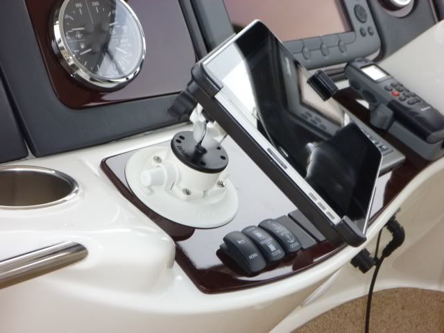

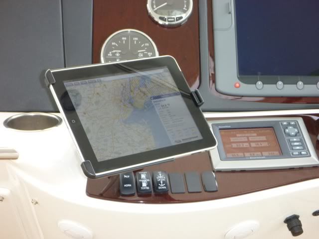

I also have a waterproof case for the iPad and "suction cup" mounts for it. Works phenomenal and protects from the elements. I now use that as my primary navigation and the Garmin chart plotter as a backup.
