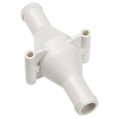

As an alternative;
Green Marine Fuel Whistle

Originally posted by KiDa
As an alternative;
In my experience from having installed a vent line whistle on my old Sea Craft many years ago, this is one of the most annoying marine product ever made and not just to the boat owner but to anyone remotely nearby.
The one I had, that looked just like the one pictured but without the attachment wings, was LOUD and of course they don't just whistle as an alert when near full, they whistle full time for the 100 or 200 gallons taken on , and the faster the pump flow the louder the whistle which in my case could be heard hundreds of feet away. It lasted all of one excruciating fill, then was ripped out and smashed into little tiny bits .
If it only alerted when nearing full, that would be great, but it's not the case at all. It only STOPS whistling when fuel goes up the vent hose and possibly out the vent. Pointless.

I like the whistle. The Davis no spill bottle reminds me of the doctor's visit after the vasectomy.

I'm with Sandy. One fill with that constant LOUD whistle and out they came.

I have the whistle. It works good for me. I have it installed in the vent hose, right where it takes off from the tank.
Mine is not that loud.
