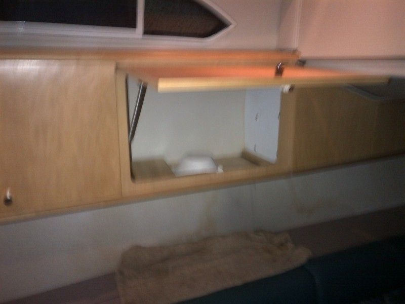

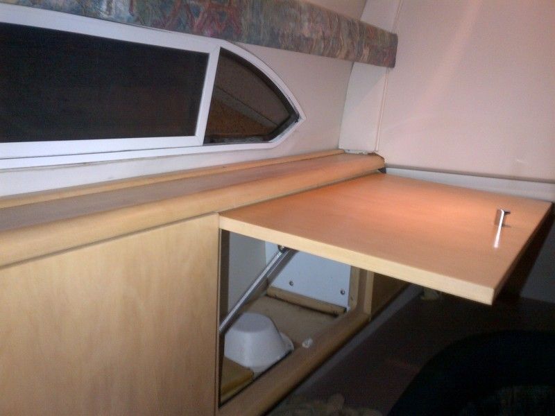

Went down to check on boat after storms here in N/E. Just bought the boat and first rain. Found water leaking from hung cabinets along the bulkhead just under the windows. I can't quite place where the water is coming from. This is a 96 Carver Express "Mid Cabin". The small windows run the length of the boat on both sides, I inspected the bow rails etc and can't see where the water could be coming in from.....
I know it's vaigue but anyone have any tips on where to start? There is a stain on the material covering the hull on that side by the leak so looks like it may have either been there before or is always been there....
Did not see any water when I sprayed/washed boat....odd...

Posted - Jul 19 2012 :  09:07:26  Show Profile  Reply with Quote
Pix inside and out would help.

dwarren
RO# 14233
Posted - Jul 19 2012 :  10:02:30  Show Profile  Reply with Quote
The leak is actually coming down between the break in the cabinets. To the left the larger cabinets and to the right the smaller, there is a separation between them where the water seems to be coming, however, the bolt in the larger cabinet had water on it as well.

Veg
RO# 20854
Posted - Jul 19 2012 :  10:30:12  Show Profile  Reply with Quote
That leak looks like it's been there a long time. I'd start over on that window, take the frame and glass off and re-gasket/re-bed the whole thing.

Posted - Jul 19 2012 :  11:51:19  Show Profile  Reply with Quote
Agree with rebedding the window/hatch.
I don't think it's the only problem though. I don't see any stain above the cabinet. I'm wondering if the rub rail is behind the cabinets. If so, my money is on poorly sealed / unsealed screws holding the rub rail in place and voids in the hull to deck joint. BTDT with my 2465 Regal.
If the stain in the cabinet (bottom right next to the 1/4 round molding) is mold, this problem is several months old and the cabinets may be starting to rot. BTDT with Saint Max.
Agree with Veg about being there for the next big rain. However depending on the upcoming weather in your area you may be able to duplicate the problem with a spray nozzle on a hose at the dock.
Good Luck!
dwarren
RO# 14233
Posted - Jul 20 2012 :  07:38:30  Show Profile  Reply with Quote
Rub Rail is actually almost parallel with the top of the cabinet but I don't think that's the issue as the force of the water is significant enough to cause a spray effect at times. Something major is opened somewhere....I think it either has to be the outside perimiter of the window or the bedding.....
