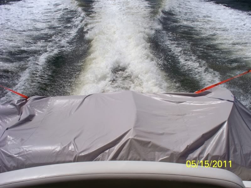

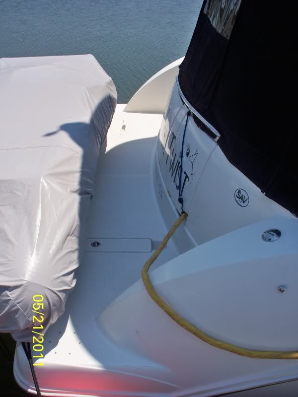

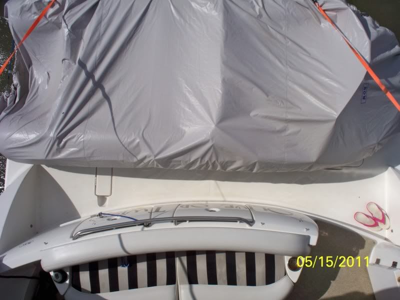

You can make your own davits for just a few hundred dollars:
I made mine with PVC lumber from Lowes, Weaver quick-release swim platform attachments, grocery cart wheels and some flat stainless steel plate. These have held my 12' dingy and 8HP o.b., fuel tank and other junk all season with nary a problem. Very cheap and secure with ratchet straps.
Orange ratchet straps criss-cross under the dinghy, attach to the swim platform cleats and then attach to the bridge hand rail:
At 30 knots with about 400 lbs with the dinghy, motor, fuel and stuff:
