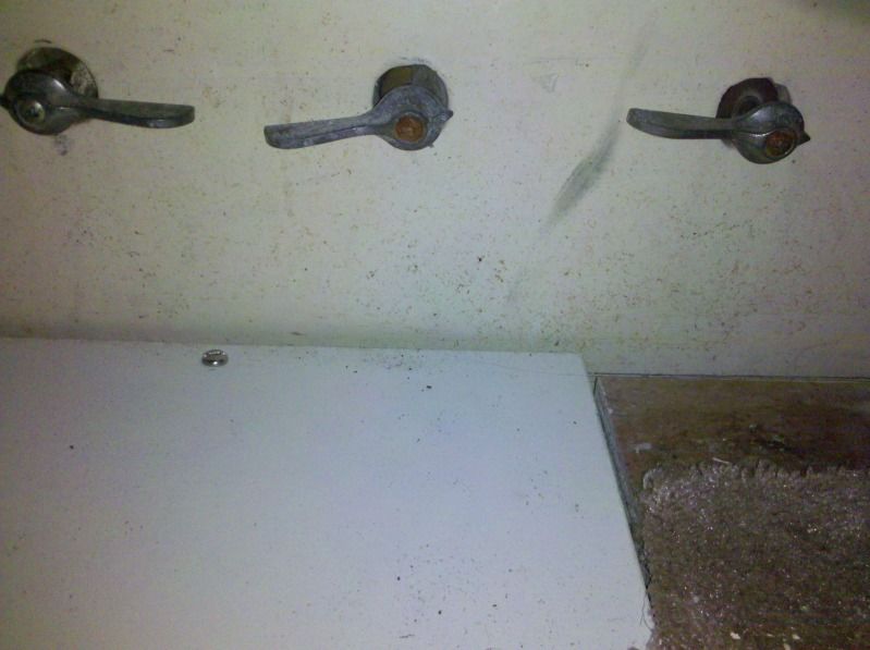

My new (to me) boat has a port tank that isn't budging on the gauge, the starboard one is dropping though. Thinking it may be the selector valves and someone fiddled with them at the boat show before I purchased. They aren't labeled. I tried to make changes but killed the engine in the process. Can anyone assist so I can properly label and empty my tanks evenly?

Well, I am hella confused now. This is how my valves look at the moment. This means either the port fuel gauge is bad or my boat is plumbed oddly. I'll try to troubleshoot this weekend. It will be cold and I'll have plenty of time!

To just be drawing off of one tank you would have to have one of the valves turned up.

Posted - Oct 04 2012 :  12:59:29  Show Profile  Reply with Quote
That is plumbed the same as mine
