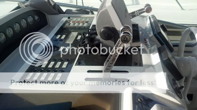

I added transmission temperature and oil pressure gauges, and turbo boost gauges. Had to move some electronics around on the dash and fabricate holders for the gauges out of starboard
Posted - Apr 18 2014 :  12:13:28  Show Profile  Reply with Quote
Photos Hogan!! You got to show your handy work.

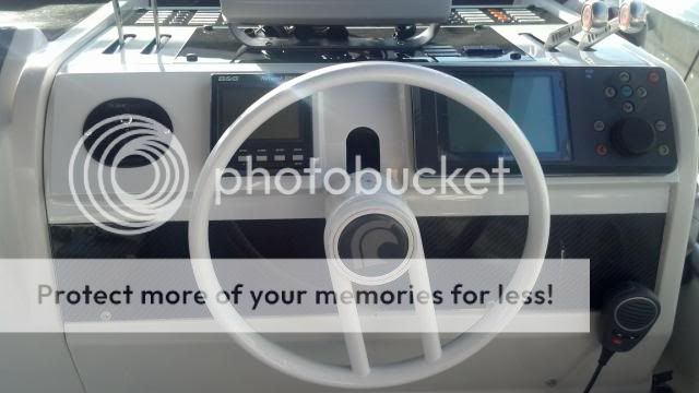

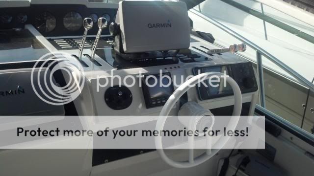

The upholstery is being installed on Thursday. I installed the dash today but had a little issue I will have to address this over the winter however it looks great in the meantime.
I did account for the flex in the panel so when I tightened it in place it put too much pressure on the new seem and created a stress crack which I will have to fill in the off season over time it will spread when it is done I will correct the problem.
Next I need to find a new steering wheel it look like crap next to the new dash!

Looks nice Dave. Makes mine look like a POS compared. Can't wait to see the upholstery.

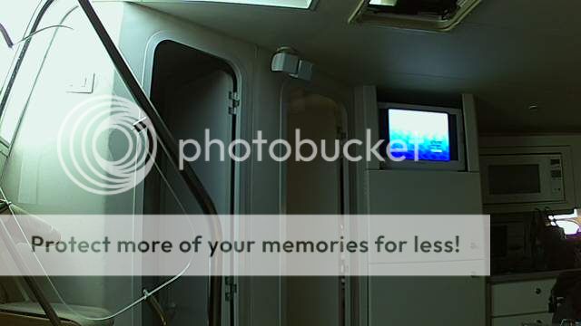

I just logged into my new IP camera and it reminded me of yet another project. See if you can figure this one out. Here is a hint I'm at home.
Posted - Apr 20 2014 :  10:34:29  Show Profile  Reply with Quote
turn your TV off.
How can you see your gauges with that Garmin blocking them?
Posted - Apr 20 2014 :  14:08:14  Show Profile  Reply with Quote
You want to install something that can turn your TV on/off remotely?

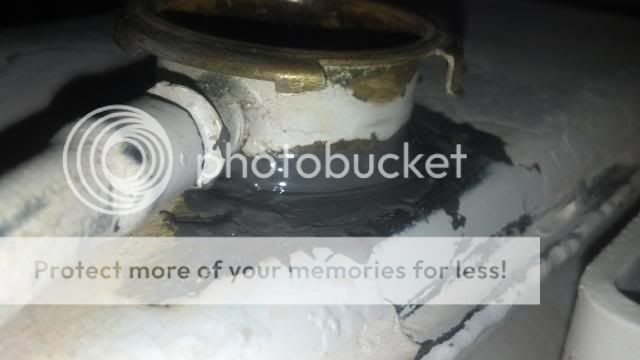

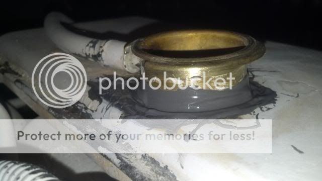

I spent the day in my engine room, I changed the zincs, changed the impellers and cover plates (they don't drip anymore) and topped off the batteries.
I also change the antifreeze radiator caps for the second time due to a drip, what I discovered is this is not the problem there are small cracks on the filler neck on top of the tank. I'm thinking I will try JB weld. It is an area that is easy to access so cleaning and prepping should be easy. It has to hold about 13lbs anything more will blow into the reservoir tank. If the JB weld doesn't work I will drain and remove the tanks bring them to a radiator shop and have them welded should not be a big deal just a pain to remove and reinstall. This is a small leak that I have had since I bought the boat but in the process of trying to fix it I made it worse so it's time to do something. I want to try this tomorrow so it has time to dry in time for me to take the boat on Thursday to get the upholstery installed.

I still can not get over how nice your helm looks.

I just noticed the part about JB Weld on your filler neck. I tried it back in the 70s on a radiator filler neck on my car. Didn't work. It just would not hold the pressure.

John I have heard mixed reviews as to JB Weld I think the trick is in the prep. This is a hairline crack on both tanks the paint was hold back much of the leak but I strip most of the paint off the area looking for the leak and made it worse. I will try this if it doesn't work I will pull the tank and have it welded it would be an easy fix the hard part is discounting the hoses and may result in replacing several hoses.

John if I wasn't handy I would not be able to afford my boat! I applied the JB Weld today I'm hoping to test it tomorrow if I can get home early enough. Assuming it holds I will test then sand and paint and I should be good to go.

I will be interested to see how it holds up Dave. Maybe the formula has changed enough in 40 years that it will work better for you than it did for me.

I was assured that this repair should work. I was also told that the tick is in the prep work I sanded the entire area done to the metal then cleaned and dried before applying hopefully it will hold. I will stop up later and try to pick to the fill to see if it peal or chip away it if does then it will eventually fail. If it holds well I will sand and paint it should look and work great, if not it is not a major fix it is a brass tank so I should be able to use solder to repair if the JB Weld doesn't hold.

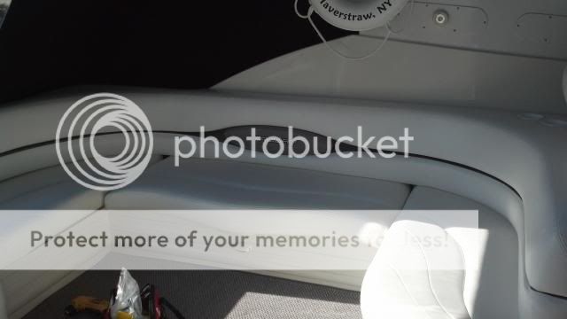

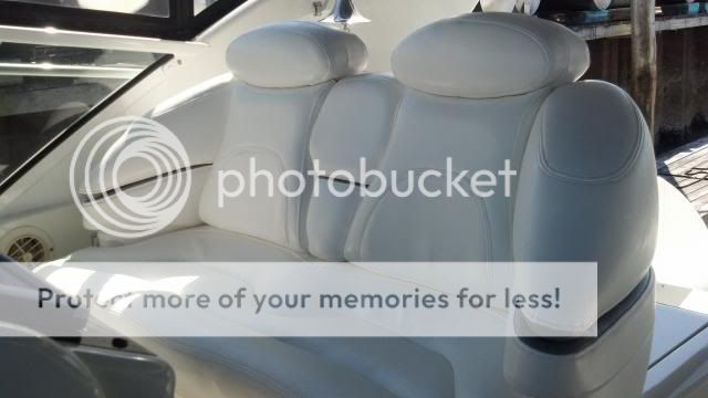

Today is a big day I'm bringing the boat to have the upholstery installed this morning. I was told it is going to take all day to complete the install so I'm bringing additional projects with me to work on in the cabin while I'm there. I'm hoping to install two new TVs and replace the microwave I went shopping yesterday and have a full car of new toys:)

While they were installing my upholstery I installed the two new TVs and a new microwave slowly but surely I'm finishing everything on my list frankly there is not much left at all:)
