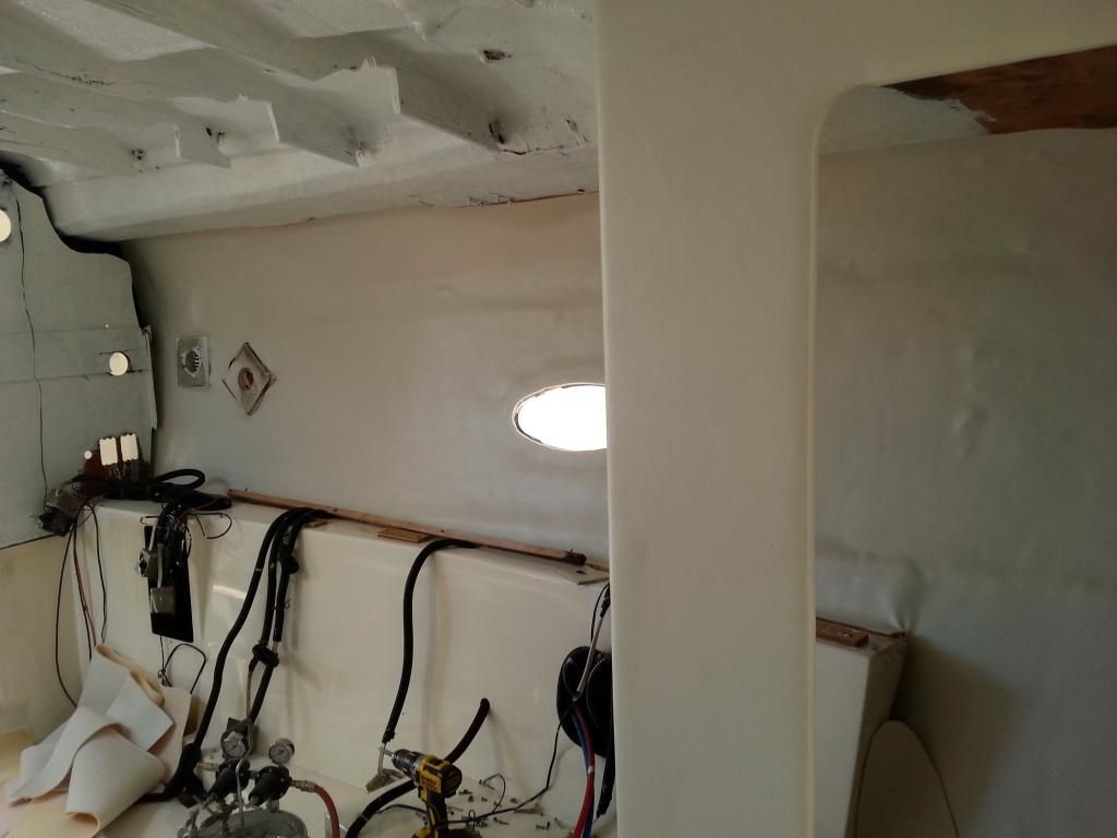

Hey guys checking back in, have a few pictures with more to follow. Knocked down some walls but will be going back up. Just easier to put the material on. The cabinets are coming out great and should start some installs in a week or two. Wife put in a request for a diesel fired oven so were checking into that.

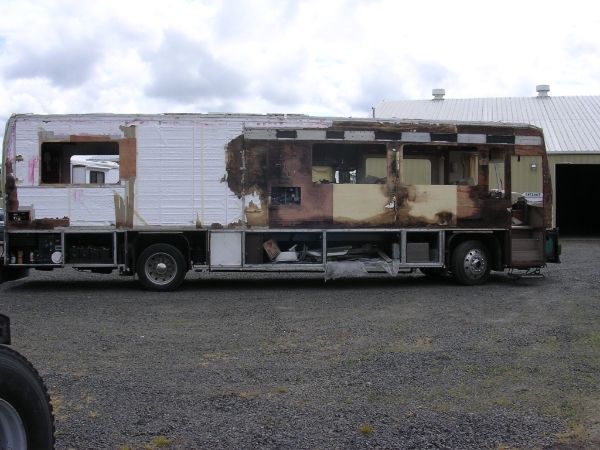

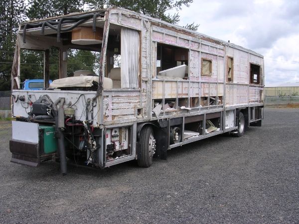

Yes it is a lot of work but even though this is not a boat here is my last project. Roof went bad on it and between rot and mold I had to strip it down to the frame and put in all new. I did everything except for paint. I have to admit I will not be doing everything on this project just because of time issues.
We did it up for our local College football team.

I tell you I have to get this resizing thing down. I see only 1 that I did worked. Sorry guys.

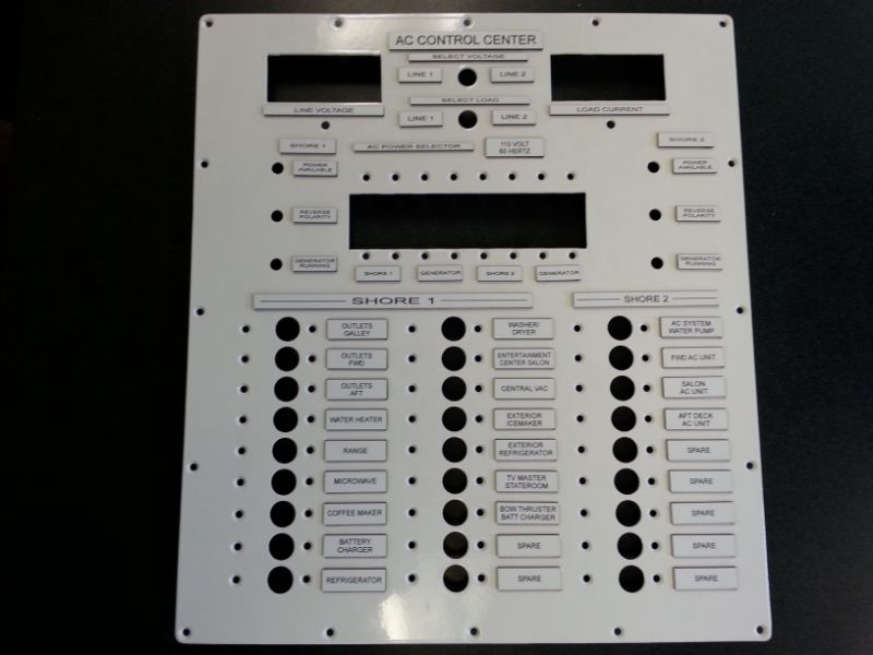

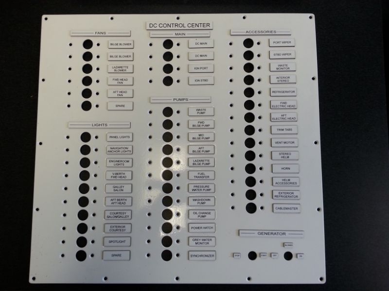

Just had the electrical panels powder coated and then had a trophy shop make the labels.

Posted - Jul 25 2014 :  02:29:30  Show Profile  Reply with Quote
That looks great I'm guessing your panels do not have back lights?
I have a very different setup and mine have back lights I don't think would work with those labels.

You panels look great. They are a lot different than any I have seen in a trojan to date though.
oregonparts
RO# 33629
Posted - Jul 25 2014 :  08:14:23  Show Profile  Reply with Quote
That surprises me about the panels being different. I have been on only two other boats and they had the same panels. Dave I hope to have everything done by the end of the year. A big change should of happened this week and I will go check on things this weekend and if so I will have some pictures.
