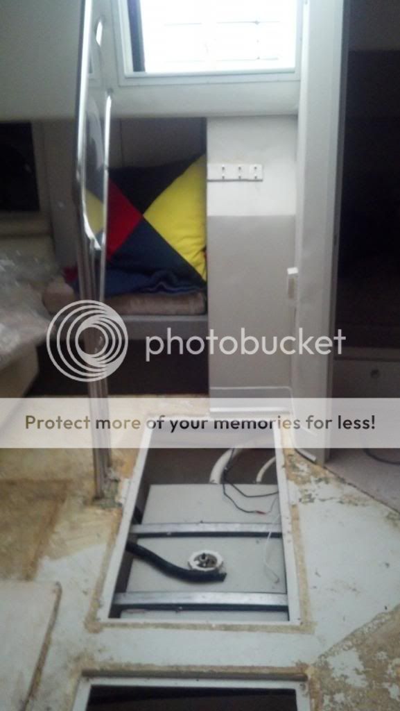

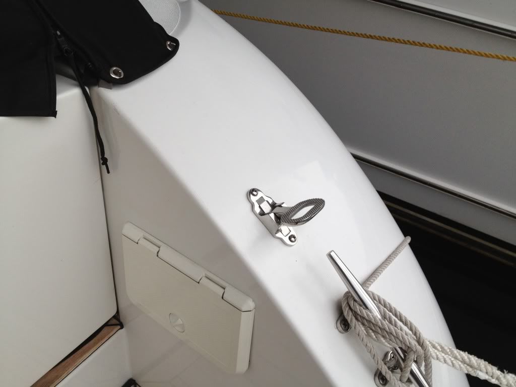

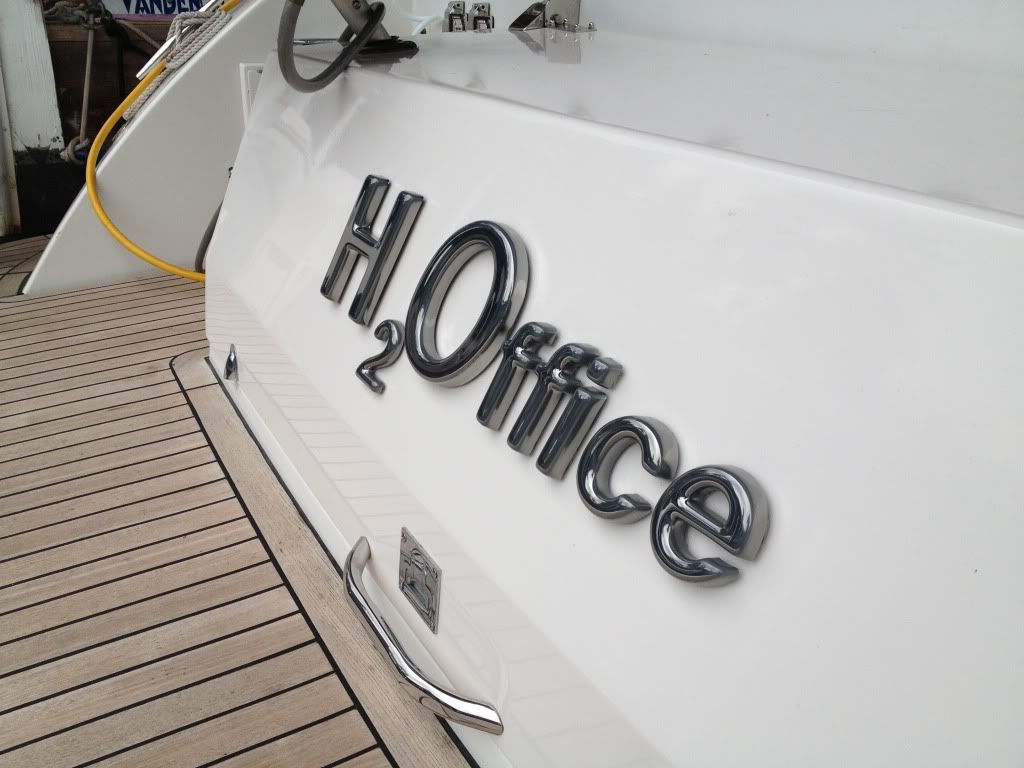

Posted - Feb 14 2013 :  11:53:19  Show Profile  Reply with Quote

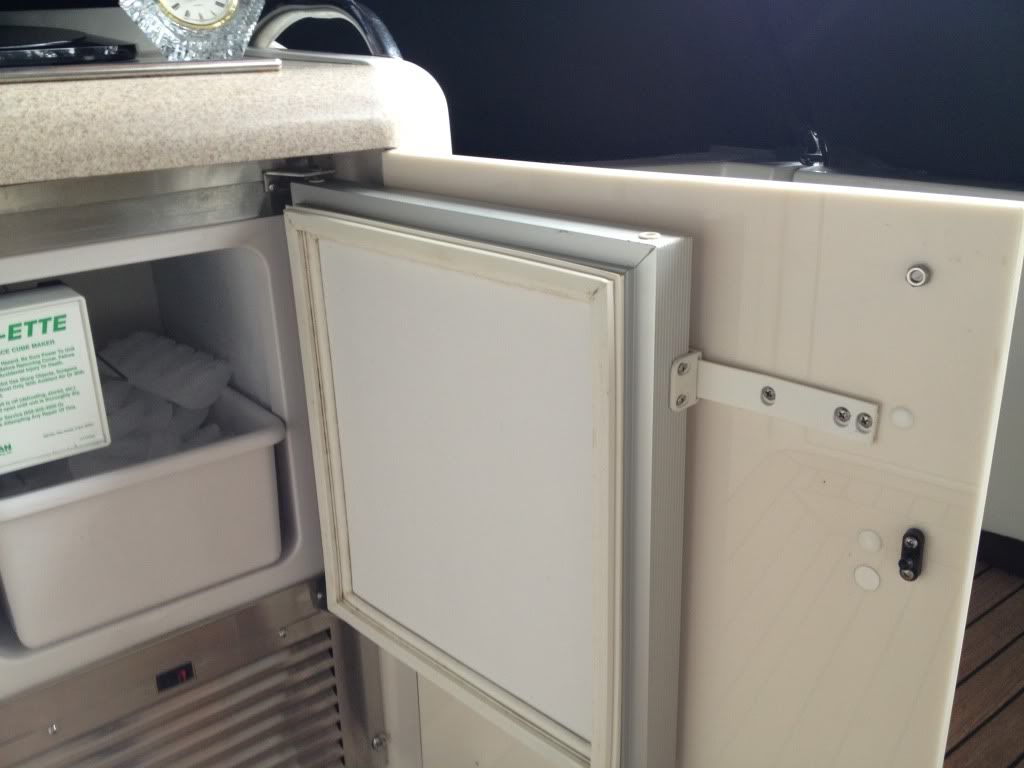

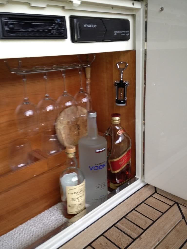

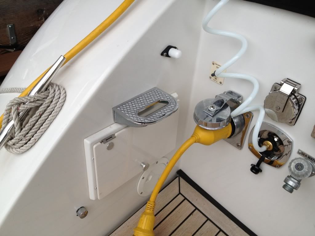

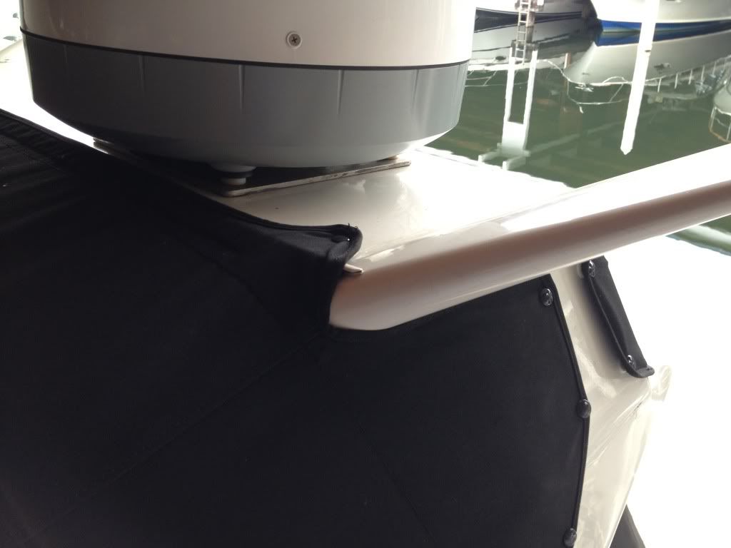

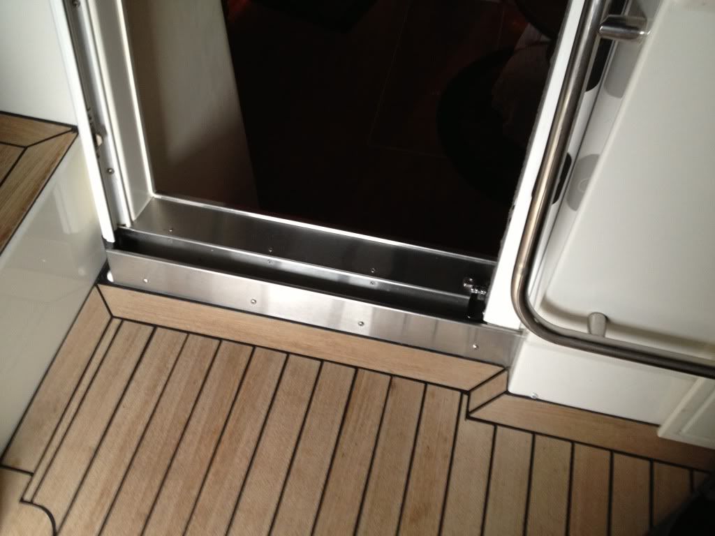

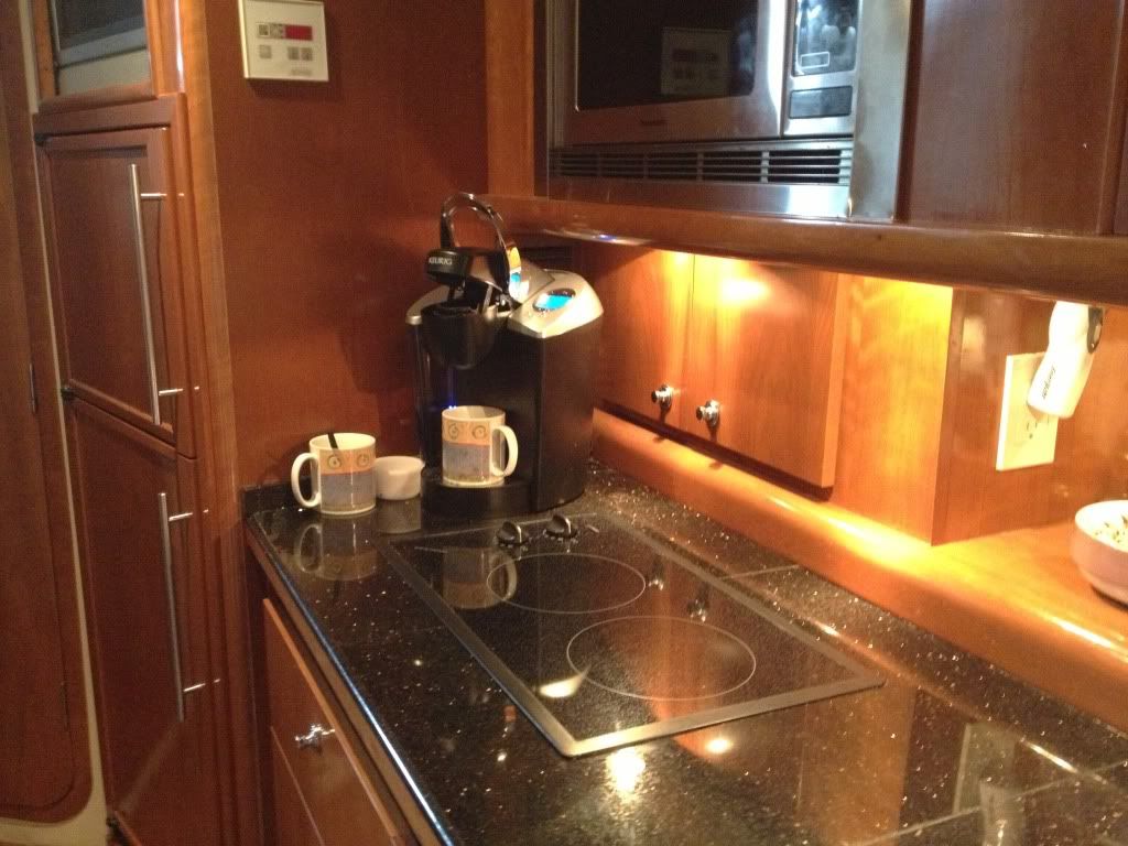

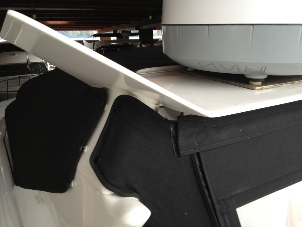

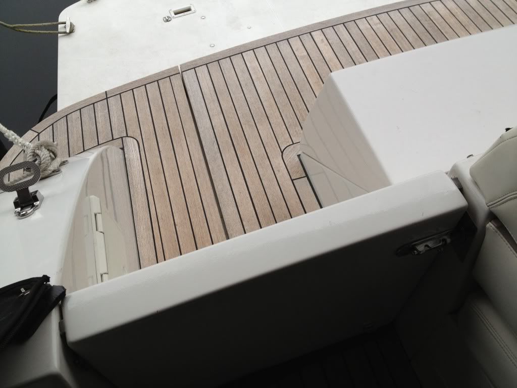

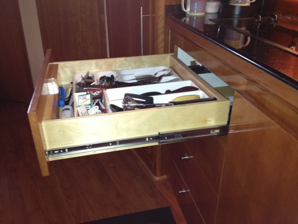

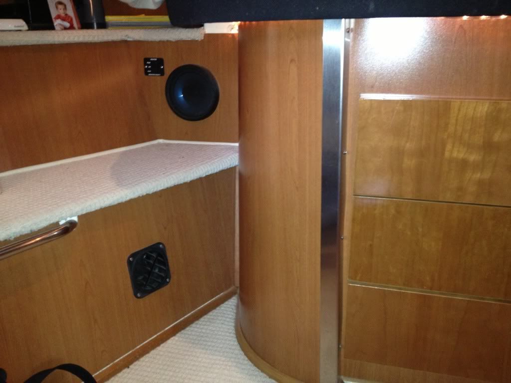

Hi
Here are some shots of stuff I have done to mine. Like: full extension soft close drawerglides, more wood veneer and formica, "wood" blinds, stepps to to get up to the aft deck. I have no leaks in my canvas at the arch. Reshaped fender box aft, great to sit on and my BQ mounts there in a rod holder. Got to have a bar!

Posted - Feb 14 2013 :  12:43:51  Show Profile  Reply with Quote
odvar, I love the new trunk lid. Who did it? How much did it cost (if I might ask)?
Did your galley counter have the wood cover that slid over it?

Posted - Feb 14 2013 :  14:26:31  Show Profile  Reply with Quote
Originally posted by odvar
What's that hatch for? I don't have one on my boat.

Posted - Feb 14 2013 :  17:10:32  Show Profile  Reply with Quote
Everything the upgrades you did are with absolute perfection. Also like to know what is that little hatch and what is the latch right above it? I love the step you have on the port side Great idea as well. Did you redo the arch or is it original?

Posted - Feb 14 2013 :  17:30:11  Show Profile  Reply with Quote
Allen, the "latch" is a step.
Odvar, looks like a 30 amp cord, don't you have 50 amp?

Posted - Feb 14 2013 :  17:49:20  Show Profile  Reply with Quote
Oh, so there is a step over the fresh water on the prt side and a secondary step over that hatch on the starboard side? Nice. It always been a problem getting up to the bow especially for my wifey and the kids. Odvar are theses steps custom made?
Also can you post a link to where you bought the wood veneer and the molding you used for the master stateroom floor? Please.

I really like what you did with the trunk lid. I have been thinking about doing the same thing. I just needed a picture to be able to show someone. I also like the steps. Much better than stepping up on the cleats like I do now.

Posted - Feb 15 2013 :  10:33:33  Show Profile  Reply with Quote
I made the trunk lid. Yes the gally was the wood type with the sunken "counter" I also covered up the recess outside over the bar,fridge and icemaker. The little hatch out back is like a glove box for my BBQ stuff.The Arch is original. Sharp eyes, 30 amp since that is all the dock has, but I have 50. One step,the folding one on stb was ground down some since it is mounted on a slope
KIRKLAND VODKA??????
Sorry, just had to point that out.

Posted - Feb 15 2013 :  12:37:45  Show Profile  Reply with Quote
Can you post pix of those areas? What material did you use for the galley countertop?
I'll bet you'd get orders from all of us if you wanted to make more of those trunk lids! I know I'd like one.

Posted - Feb 15 2013 :  16:46:48  Show Profile  Reply with Quote
I think the lid looks great but I also like the look of the rounded lid. I removed mine and had it refinished a couple of years ago so it looks great or at least like new.

I am going to order a step this weekend. I want to make sure it will fit first. Looks like I went get much done this weekend. I will be working tomorrow and Monday.

The lid, I have to confess I took the easy way, it's plywood added to the original to make the seat, fiberglass overlay and polyurethan paint tinted to the gelcoat.
Kirkland vodka, sure it's good (for the $) and Kirkland is my neighbor city, Costco.
The gally top and in the heads are made from 1/2" granit tile 24x30 with polished edges.Saw them at Home depot the other day.
Just put a small motion activated led light in the fridge, works great. I hope you guys have mounted real lights in the engine room, my small 12V did not do anything, now it's easy to look for problems and to work there. Kitchen undercabinet lights work well.

Odvar,
Can you tell me where you got the chrome lettering from? How is it affixed? How well has it held up for you? Looks great!

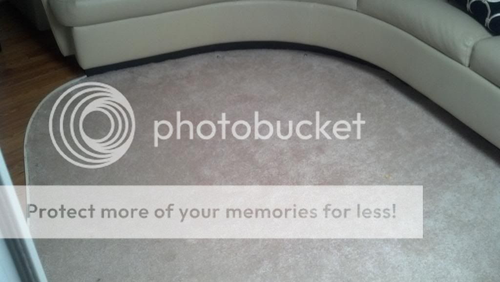

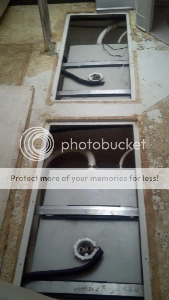

Well I got started today seems like such a shame to pull up such nice carpet but it came out fairly easily and will return as soon as I'm done.
The carpet and all interior upholstery was replaced just before I bought the boat and it's still in like new condition.
I removed the carpet stairs and floor boards to get access to the waste lines, this should be a fun project NOT.
As I have stated in the past I have a very different setup then most if not all of the other Trojans at least on this forum. I have two waste tanks in the center line of the boat.
Each head has it's own tank this provides for a 100 gallons of waste. When I pump out I have to flip a valve to pump out both tanks one at a time.
I'm looking forward to completing the project and then pulling the cover and getting to work on the clean up. I found myself doing a little cleaning in the cockpit while I was on board today. I'm really starting to get the itch for Spring, good thing it's around the corner!

I also did a couple of things today. Added a stainless steel grab rail for the kids going in and out of the boat and as I removed the door and the frame to the master head I installed 3/4 trim lock molding on the edge so rounding the entry.
