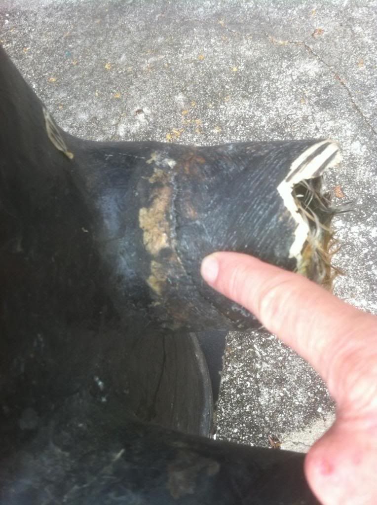

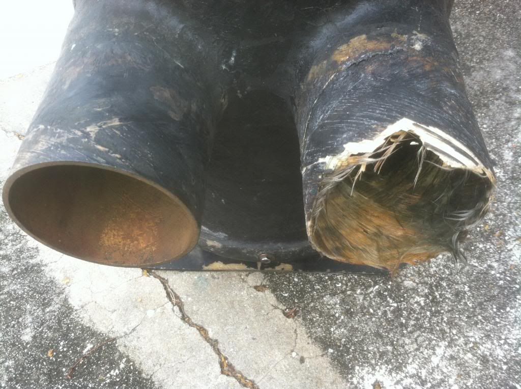

I recently had the pleasure of burning an exhaust hose due to the elbow crapping out the water flow. In replacing the offending parts, I found my Vernalift muffler flange experienced damage as well. The excess heat apparently melted the resin on the inside of the inlet pipe on the muffler. I called Centek (who purchased Vernalift) to ask about a sleeve that could be inserted (glassed) into the inlet of the muffler. The tech said that the inserts designed for prevention of collapse of the inlet pipe is not intended for that purpose and recommended I custom order a new muffler. Inspecting the muffler, the damage seems to be only on the first 3-4 inches of the inlet pipe. I know very little about waterlift mufflers as this is my first boat with one. There is a crack in the fiberglass that I am pointing to. I had originally planned on re-glassing the inside diameter of the hose flange, but after talking to the tech, I'm beginning to wonder if my frugality is not worth taking the chance. Below are pics showing the muffler and the damage. Any thoughts are appreciated as I ponder how to procced.
My finger is pointing to a crack that apparently is allowing a water leak when I run the engine.

How are you sure no damage was done to the inside of it ? That would be my worry. Fixing the fitting seems to straight forward, clean it up and re-glass it.

Replace it and never have to worry about it again,except in regular maintenance checks.

Take it to a place that does marine exhaust, I mean one that works on boats that need custom exhausts. They can cut that piece out of there and glass a new piece of glass pipe back in. If you can not find a shop like that on your side of FL than give metcaf marine exhaust in FLL a call, should be an easy fix.

I would not do this myself. Get someone else to repair since they may use a special resin.

Don't risk a possible CO leak in your boat. Buy a new one and toss that one out.

The difference in price between new replacement and finished repair of possibly questionable quality compared to the construction & heat resistance of the Centek may only a couple hundred $ or so. That must seem like a lot right now, but if a repair fails from any combination of stress, substantial heat and vibration, it can allow both CO and a lot of water in the boat in short time. (My blue 5.7L engines spec RW pumps flow at 5 gal in 15 sec at 4000 RPM I believe, and most of my exhaust hose and mufflers are below waterline.) If the waterlift did not look at all damaged (with internal inspection, just the hose , I'd probably reuse it, But as is in the pics , personally I believe I'd replace for peace of mind.
With apologies to your wallet, another thing you understandably may not want to hear is, the pricier blue silicone exhaust hose is supposedly much more resistant to heat and burn-thru, which may give you enough time to be aware of the flow problem and avoid a hole in your inside maybe under-water-line exhaust .

In principal I agree with Sandy if the cost are close enough. But if the only damage to this thing is what is shown in the pictures and it is cheaper to have it fix by en exhaust expert that that is what I would do. I have seen haw these things are made and they not made out of in piece, in fact they are glassed together out of many pieces, so I see no reason why a competent shop that makes these things all the time could not be trusted to to repair yours.

I've inspected the muffler as much as a layperson can. The only damage I can see is on the inlet, and as you may be able to see in the pic, only the resin in the first 3-4 inches of the inlet tube melted. The engine ran maybe less than a few minutes after the hose burned through-I caught it early. I believe the crack developed only because of the stress of re-hooking up the exhause hose which is not perfectly aligned and due to the loss of integrity from the loss of resin. I had run the engine for several minutes and everything seemed to be fine except for a slight dripping where the hose connected to the inlet tube-that is what caused me to pull the exhaust hose and take a harder look at things. I called a fiberglass tank company locally and I'm going to see how much they want to fix this-making sure they have expertise in marine muffler repair. I'll let everyone know what happens.

For anyone following this thread, I took the muffler to the fiberglass fabricator who said he has done many marine maufflers. His answers to my questions gave me a good feeling that he knows what he is doing. He will be cutting off the existing 4 inch inlet tube and fabricating a new 4 inch tube-building the interior diammeter to a thicker amount as I told him the inlet tube is under stress due to a not-so-great alignment. The fabricated tube will then be glassed into the muffler. Total cost is $200-while more than I had hoped for, a helluva lot cheaper than the $600+ for a new muffler. Thanks to all for your input-the main reason why I support this forum-so much knowledge available at rock-bottom prices.

Why not have him change the angle of the inlet tube to align better?

Sabre....that would have been a great idea if I had thought of that prior to taking the muffler up to him. Now, I would have to take the muffler back down and see exactly what angle I would need to make it align better. I was originally expecting the repair facility to just rebuild/reinforce the inlet tube-not replace it entirely in which case changing the angle would not have been an option. The fabricator indicated he would be using an epoxy resin-not the polyester resin as polyester would not bond well with the existing fiberglass. He has repaired many mufflers and talked the talk so I feel pretty confident in his abilities. I got new 4 inch wet exhaust hose from Goodyear at $20/ft which I thought was outrageous...I could never in good conscious pay the $50/ft for silicone hose. Now that I know the age of the elbows, I will be replacing them long before they get to the condition they were in where they could burn up a hose. I had figured that being in fresh water for the previous 14 yrs, I could get more than a year out of them prior to changing. However, I thought wrong-not the first time, but live and learn.

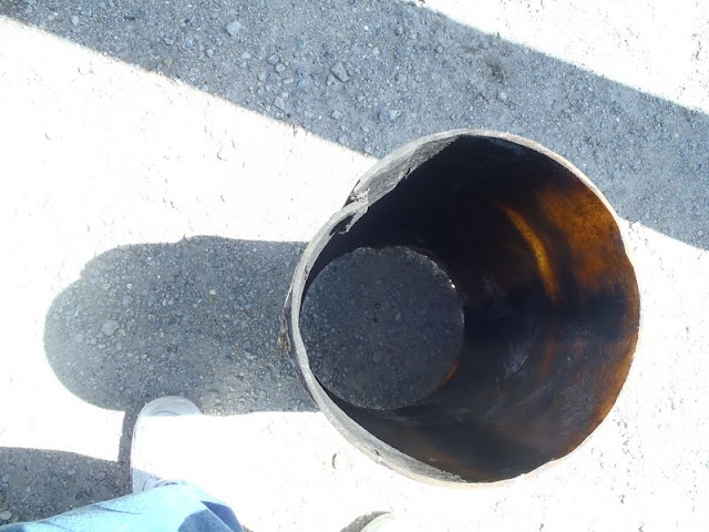

I am going through this same thing on a larger scale (10 inch diameter) and both engines. Some years ago someone did an improper installation / fix which resulted in very slowly crushing both glass flanges via over tightened T- Clamps and a bad glass job. Very gradual water leaks resulted recently which we finally tracked down. Longer story than that, but no matter. The mufflers were still in very good shape. We have cut the flanges off all together and got properly fabricated new tubes which will be glassed into place. Inside each tube at the hose end, we are inserting and resining in stainless steel "crush tubes" which we actually bought from Hatteras( the boat is near their plant), who uses these now in new construction and was nice enough to sell them to us direct (the guy supervising this job worked there for many years). Overall my install will be the current state of the art. This is just too critical a system to go half-baked.
You absolutely must use the proper resin. This stuff is hard to come by. Hatteras wanted $600 for a five gallon pail of what they use, eventually we found another local boat builder who got it for us cheaper. We only need a couple of gallons, but it only comes in 5 gallons. So we will try and sell it off to one of the locals. Nice to be in a boat-building area. It is a very hazardous cargo to ship, which was another problem. Anyway, you want someone to do this job who has a lot of references or specializes in exhaust work. My boat is testimony to what happens when you don't, but fortunately we caught it in time. You can burn up your boat or sink it. Or just have to do this again in the future.

Here are a few pix of the cut out tubes and the new tubes with crush ring (for illustration, not installed yet).
My foot in the picture below gives you a sizing reference:

Thanks for the additional info caltex. One of the comments that sealed the deal with this fabricator is that he has done several Hat mufflers. I had talked with Centak regarding an anti-crush fiberglass tube when I was considering a DIY project-they strongly recommended that the anti-crush tube was not the solution in my case. With a SS insert, is there not a concern for anorobic corrosion-specifically the glass side of the SS ring? Just curious.

Not if you resin it in right' you don't just slide them in. Or should I say, have someone who knows what they are doing resin it in right. Both guys on this job worked at Hatteras many years and have great reputations. I got the glass tubes from there too. We'll see!
