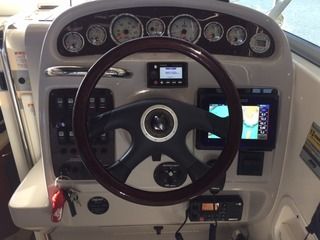

For the past few weeks I have been doing some major upgrades to my 2005 Chaparral Signature 240. The plan was to eliminate the JBL stereo system, remove the old Humminbird 595c chartplotter and add a full NMEA 2000 networked system.
One of my favorite updates was adding Boat Command.  This system monitors and sends alerts to my iPhone for anything you set up.  Currently, I have it monitoring vessel location, bilge pumps, both batteries, shore power, bilge temperature and a motion sensor for the cabin.  To learn more about this reasonably price product check out their website.  www.boatcommand.com
Here are the results.

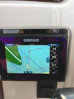

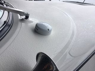

Old chart plotter removed and added a new Simrad GO7XSE. This is an awesome product, all touchscreen, build in WIFI that can mirror and be controlled by a tablet and is part of my NMEA 2000 backbone. Also added to this was an additional fuel filter for the Simrad fuel flow sensor and a Simrad GPS antenna. The chartplotter DOES have built in GPS but I wanted to eliminate all Humminbird equipment. Also added the Navionics charts since the basic charts that came with the unit are not that desirable.

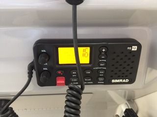

Second was to add a new Simrad VHF radio and antenna. This is also connected to the network.

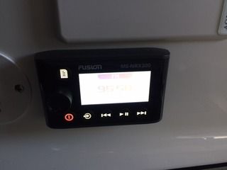

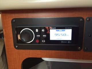

Then came the stereo. I was looking for basic radio/bluetooth capability and NMEA 2000 network so I went with Fusion 70N and the remotes to replace the ones at helm and stern (old JBL product).

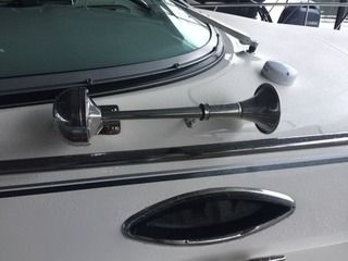

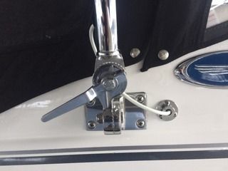

Finally, the horn Chaparral installs is a joke. So added a new trumpet horn.
