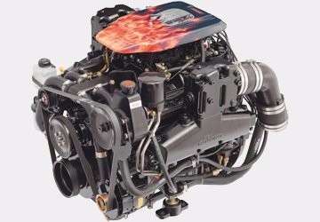

I agree with adding a few HP. At Admiral's suggestion (and a Suggestion from an Admiral is always an Order...) I had a MerC shop replace our old 5.7EFI with a MerC "Reman" 5.7 bored .040 and called a "357." Our Sea Ray manual called the 5.7 a 220-HP engine, but at the prop shaft. There was a 5.7LX at 250, again prop shaft HP. But I haven't seen anything other than Outboards rated at the Prop, always at the Crank. One MerC dealer told me the 5.7EFI was 250 HP at the Crank. I'll never know, but the 357 is rated 275 HP, at whatever. 25 or maybe 50 HP more than the old engine. But hear this: It Feels Like 100 HP More! It can hold plane with 4 POB at 3000 RPM. Used to take 3200 for 3 POB. Tops out at 40 KT vs 35. Turns 4800 RPM vs 4600. Those are the respective RPM ratings for the two engines. BUT!!! The 357 is running a 23 Pitch Black Max aluminum 3-blade vs a 19 Pitch Vengeance stainless 3-blade. It's like a whole different boat.
From what I understand, new 350/5.7 engines are still being built. But 454/7.4 engines, no. Friend bought what was listed as a New Marine 454. MANY problems including tuliped valves and water in the cylinders. He pulled the heads to have them worked, and the shop said the engine did not have Marine Head Gaskets. If this is what truly happened, I am VERY concerned about "Marine" engines from automotive sources. There's more to a marine engine than the freeze plugs.
I'm glad the Admiral made her "Suggestion." I paid more, but I'm out boating and my friend's been wrenching. Finally gave up and bought a Wellcraft walkaround with a 250 Yammie OB.

I'm not qualified to comment on engine details. Again, glad I had it replaced with a MerC product. That isn't to say you should or that's the only way to go. Charlie's our Engine Builder here, your best bet when it comes to details.

http://www.ebay.com/itm/Mercruiser-357-Alpha-4v-275-HP-Engine-5-7-5-7l-350-mag-magnum-275hp-865108R88-/400184730176
I think the actual retail is about $6500
As you can see, it comes VERY complete. That can be good or bad. If you KNOW SUREFIRE CERTAIN that your accessories, like manifolds (including intake!), carb, ignition, coupler... are all good, then this complete engine (sometimes called a bobtail engine) is overkill. But it's typical for a defective accessory to be the cause of death for the engine being replaced. Then it gets installed on the new engine and kills that one. Again, I'm thankful for the Admiral's Suggestion.
