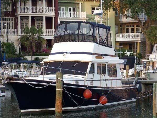

Been there, done that and now we have a Trawler.
The Trawler gives us space, comfort and economy ffor a fraction of what we would have to spend on "boating" with ax express crusier, or motor yacht. Our CT (Chao Tao) is 35' with twin 90 hp natrals and cruises comfortably at anywhere from 7 to 10 MPH. Two staterooms with 2 heads, a large flybridge, good size salon and sundeck provide for everything we need.
What finally convinced me to consider a trawler was the fact that I would pass sailboats on the ICW and then pull into a marina. A few hours later the same sailboat would pull in, seemed to make they where doing the same distance each day, spending a lot less on fuel and enjoying the process.
We've spend a ton of money in restoring this old trawler, fuel tanks, electronic, canvas, new upolstry, etc. But we know what we've got and 785 miles a day is plenty of distance to cruise on most days. Went down the St. Johns River last summer and we'll be going to the Key's this summer.
