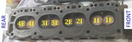

So it's E II EE II E, which matches my photo of my head (yes, *before* I cleaned it up):

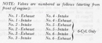

As I understand it, the intake valves are the larger diameter (presumably to allow plenty of combustion air?). This is from the manual for later-model Mercruiser 3.0L engines (Mercruiser Service Manual Number 13), page 3A-20:
Oddly, I cannot find the valve order listed in this 3.0 manual, but I did find that image showing the larger intake valve head. Not that it matters, because I am going by the correct manual for my engine s/n.
Anyway, I would just like to have someone more knowledgeable about all this confirm that I have the valve order correct. The reason I am questioning it at all is that I have seen online discussions saying the order is I EE II EE I, and saying that is an "industry standard". Did Mercruiser ever change the order? Do other inline 4's use that flipped order?
