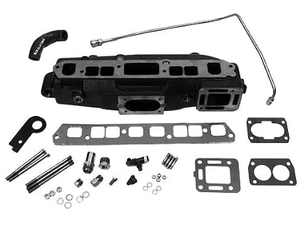

If this is your exhaust manifold... Actually if it's your Manifold... the Carburetor sits over the large rectangular opening in the center, and the square opening on one end, with the four slots, one on each edge, is the exhaust.
OK, if that's the correct picture, exhaust is at one end, the rear cylinder. Square hole is exhaust, four slots are water passages. It's called a Wet Joint. What usually happens is the surfaces of the manifold and/or the matching area of the riser waste away with rust and discharge water gets into the exhaust cavity of the manifold. So YES, water entering this way is most likely to get into the nearest cylinder. If you separate the Riser from the Manifold, you can inspect the Wet Joint. Surfaces have to be perfectly FLAT.
