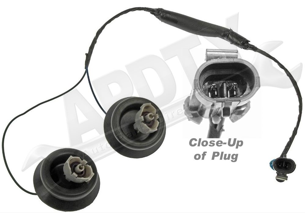

Thanks so much for such a quick response by all. We are at Saint Pete Beach. I have changed the engine temp alarm switch and the Oil press alarm switch near the oil filter. The alarm switch near the distributor has been unplugged and the intermittent alarm persists. By unplugging the temp alarm switch (which has been replaced) the alarm no longer sounds. The exhaust manifolds remain warm when cruising, but are easily touched. The bravo II drive oil resivoirs have been unplugged. I will start by checking electrical connections all over the place. This boat is bone stock and the alarm started after 3 years, Does anyone know how to unplug the Knock sensor? It seems to have a "trick" connection and I sure don't want to break anything. Will keep you all posted. griff4

Sensor terminal looks like this:
And connector looks like this:
The plastic teeth in the small side connector click over the tapered edge of the sensor. Squeeze the large side and they release.
You can see more on Amazon using "mercruiser knock sensor" and it'll show you several MerC versions of the sensor, then where "mercruiser" is crossed off, the sensor and terminals I pictured. If you select the Knock Sensor Harness you can see the small side with the teeth and the large side to squeeze.
Blow up the picture above. Notice how it's an oval shape. Carefully squeeze the tips and the cable should come off of the sensor. Note that the manual suggests that you don't run it with the sensor disconnected.

Thanks for the fine pictures. I'll check out those connectors tomorrow. Griff4
Update on the annoying alarm. You guys may have pointed me in the right direction. Upon disconnecting the knock sensor, I took a short test run in our Intracoastal waterway. That darn alarm was silent! Ordered a Knock sensor and maybe I'll be alarm free for a while. And it was chilly today..50 degrees with a stiff east wind. Thanks for your assist. griff4
