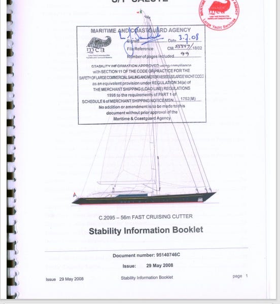

A previous captain of that boat published some notes which while avoiding speculation describe the systems, stability, limitations and hatch/opening configuration
Very interesting read. Scroll down the discussion on this YachtForums link
Listening to the video that boat was a recipe for disaster. Self opening doors (unless locked) with a low free board into the cockpit? Duh. However interesting the article says it went down to the opposite side.
Looks like a knock down to starboard will let it flow in past the sliding doors.
Yep. And more concerning is how a 45 degree list will cause the ER to flood! You d think they d have the dampers close once it reaches 45 degree.

So what we have is an under keeled, under ballasted, over masted and top heavy sailing boat of sloop design. And the counter to that weakness was everyone keep the hatches, and vents closed. What could go wrong?
