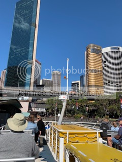

If you look at the white nav light on poles they have no glare problem. The focused beam goes out above the operator. Given the speed that bass boat was moving across Sydney harbor (he had the full kit bythe way, trolling motor, power poles, big outboard) a beacon would be very much in need.
Here is a nice picture of a beacon mounted on a mast. Note the shield.
