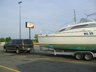

Surge brakes have worked well for me (although we did add another axle after this photo). The brand is Float-On. Boat is 30x10' and 7,500lbs (per truck scale).
