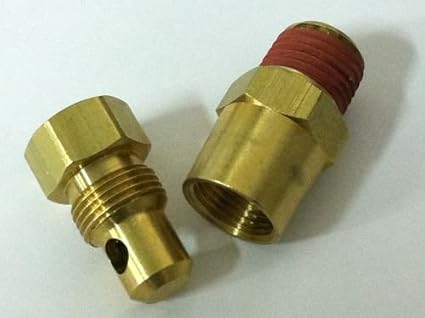

I was working on our boat yesterday. The drain fitting, something like this,
came completely out of the knock sensor adapter fitting. I had a good chance to check that fitting. The one that adapts Knock Sensor to Block with a hole for the Block Drain. Definitely BRASS. I scratched it, wire brushed it, and confirmed Brass with a magnet.
VERY awkward to get in there and do much of anything.
