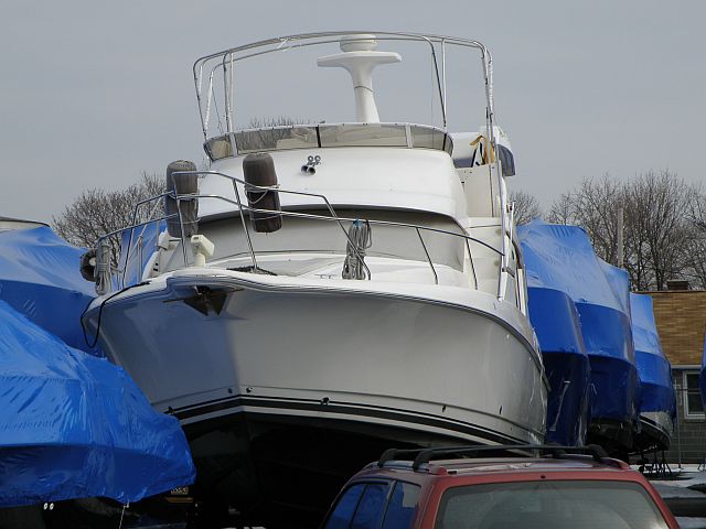

I spent the afternoon at the marina, but the cover is still on the boat. It just was not warm enough to be able to stretch the eisenglass to cover the cockpit.
Maybe over the weekend...
However Mike failed to say.....My cover is off!
Sorry Todd, but trying to stretch canvas and isenglass in cold weather is beyond my capabilities. I need some heat to do it...
